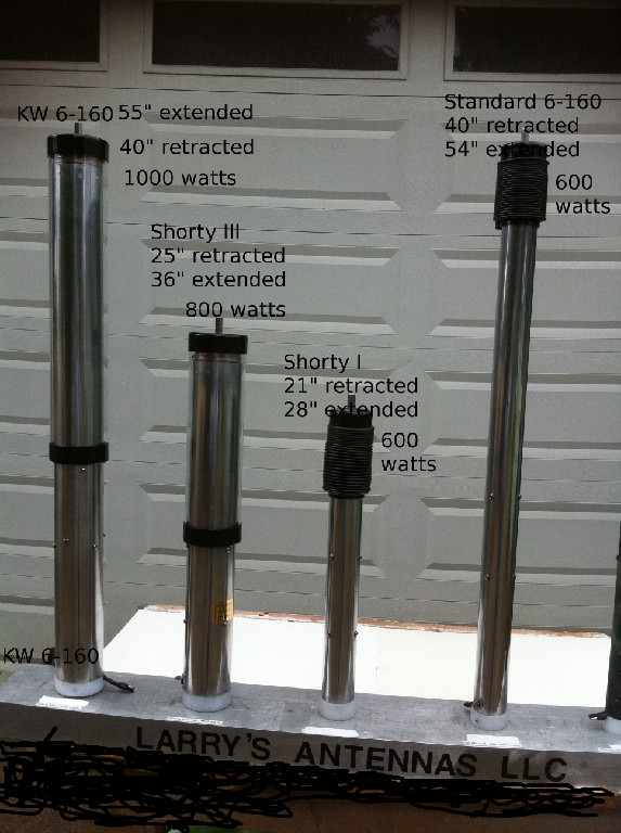

THE KW 6-160 IS THE BEST MOBILE ANTENNA AVAILABLE ANYWHERE only outperformed by our new HD models. IT COVERS ALL THE BANDS, WILL HANDLE A KILOWATT OF POWER PEP, RUNS COOL AND IS MORE EFFICIENT THAN ANY OTHER SIMILAR ANTENNAS FOR ITS SIZE. WHILE TESTING WITH A KILOWATT AFTER 1/2 HOUR THE COIL ONLY RAISED 5 DEGREES F. THAT IS REMARKABLE ACCOMPLISHMENT. MANY ARE IN USE AS BASE STATION ANTENNAS. 12 GA COPPER WIRE on Hi tech phenolic coil form
