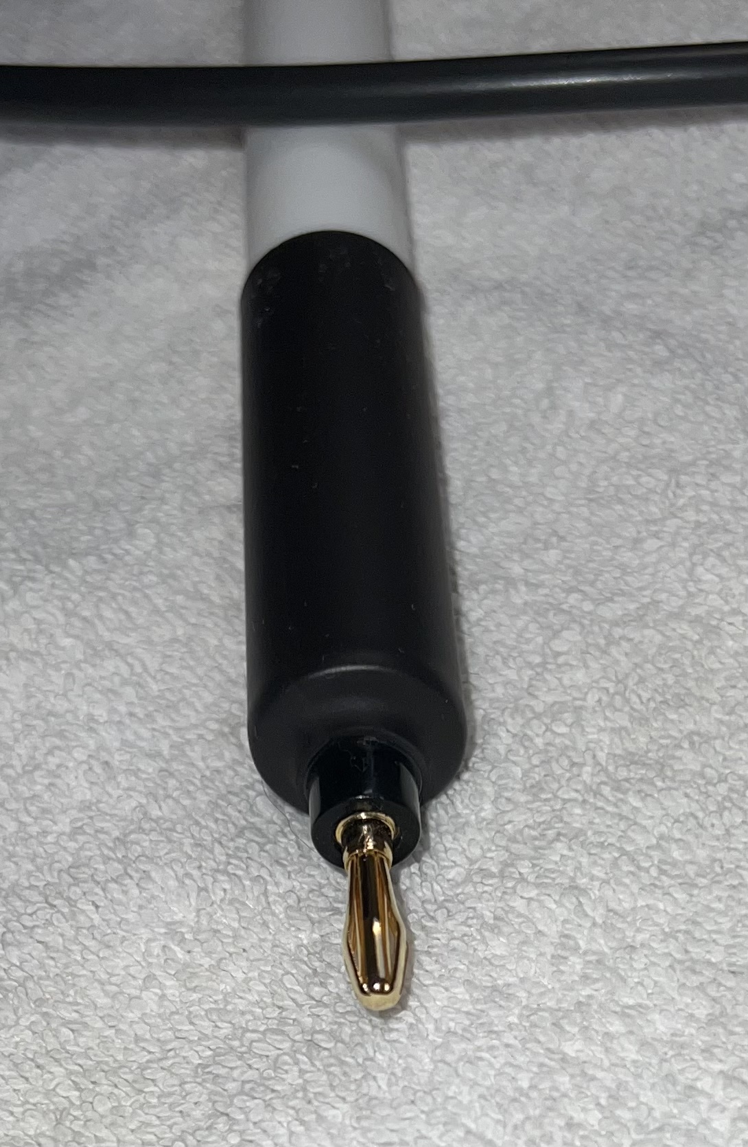

The reason for a hole down the center is that I’m using a 3000 ohm ohmite 10 watt resistor. I want the resistor to solder directly to my probe tip which is a banana plug and then slide it up inside the rod.
The following photos show the build:
The above banana plug is Flood Soldered and then the capacitor lead inserted.
Then slide the assembly up the center of your Teflon rod.
I would greatly appreciate any feedback for ways to improve and what others see as a hazard that I haven’t considered. Yes please tell me if I have a “FATAL ERROR” in my design/project.

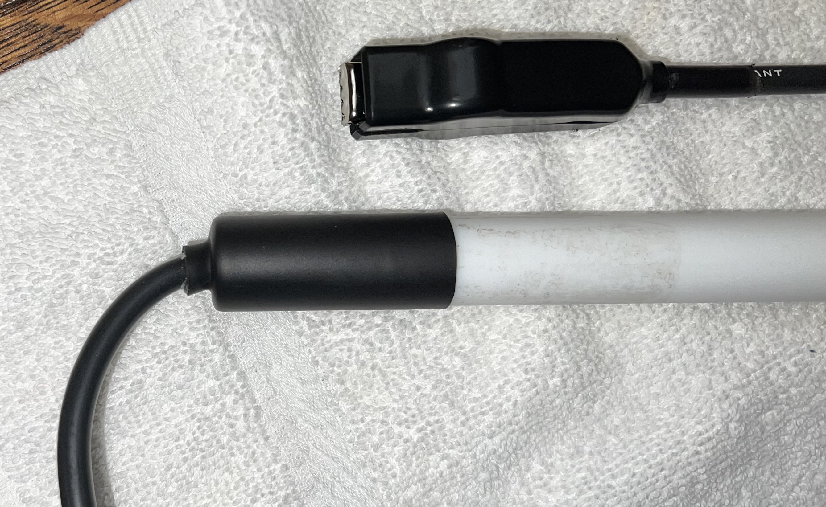

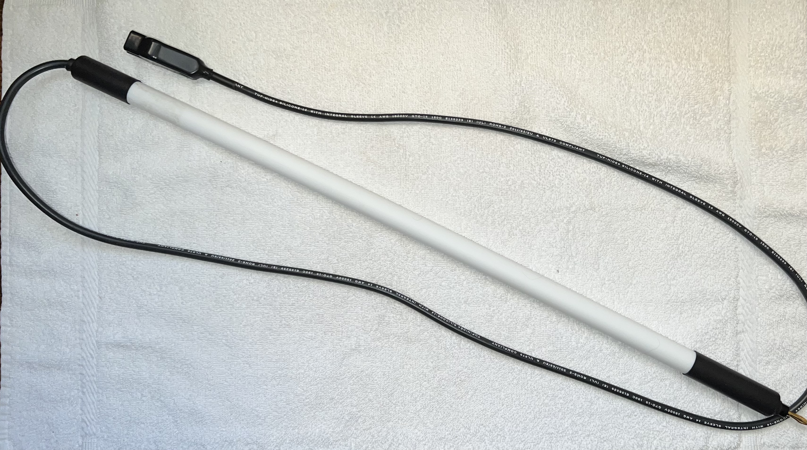

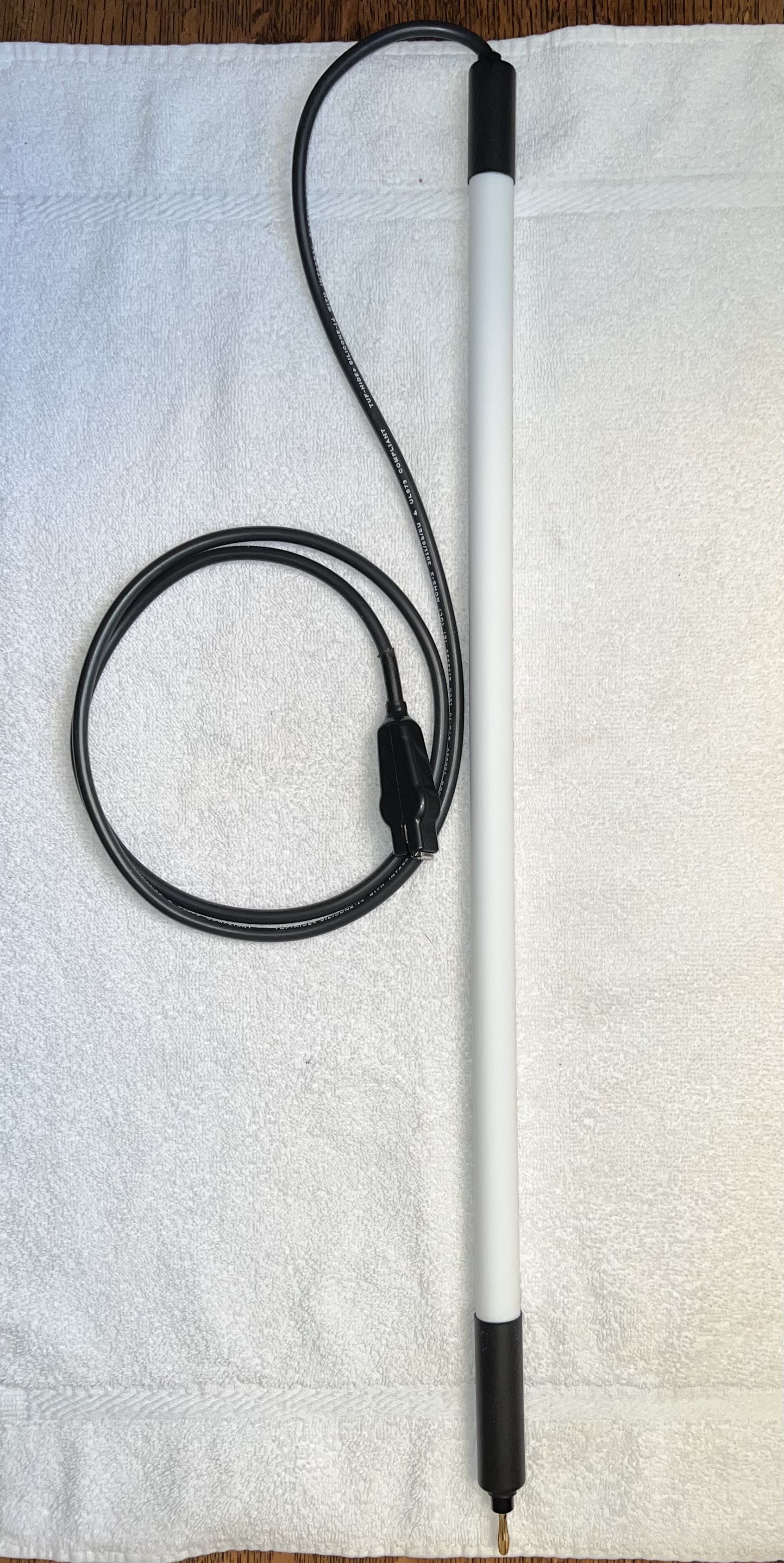

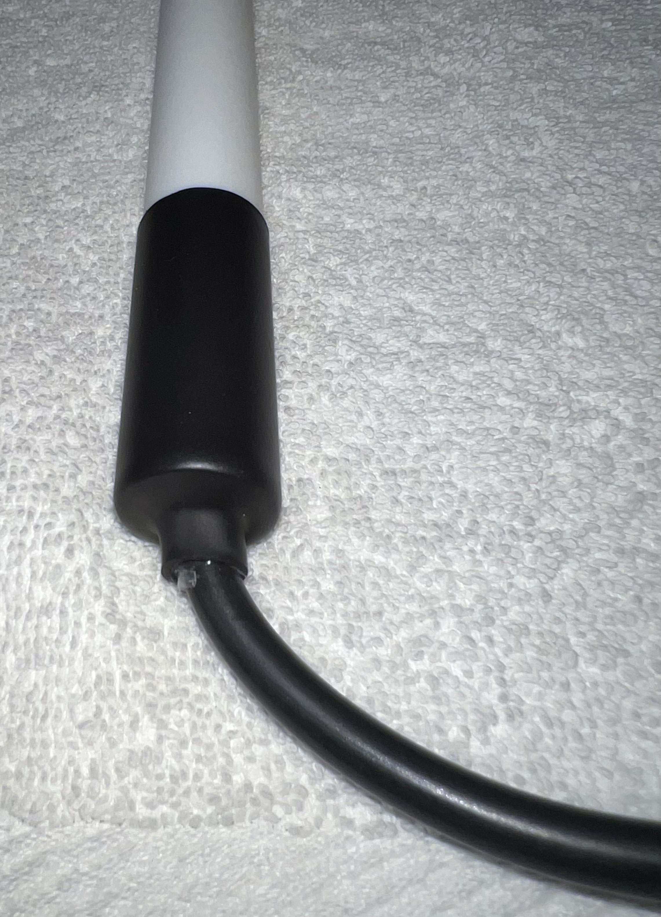

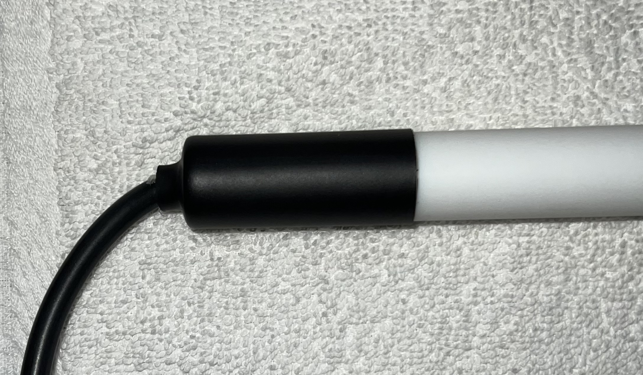

Today I received from McMaster-Carr 3/4 dia PTFE/Teflon 2 foot long with 3/8 dia center hole. This is the perfect size for the 10 watt resistor, 15KV Neon Sign GTO Wire and banana plug tip. Here are the pictures.

Just came across your post on the resistive discharge stick. If you use a 3000 ohm resistor at 3000vdc,the current will be 1A and the power that has to be discharged will be 3000W. How will a 10W rated resistor handle that? I think that resistor needs to be on the Megohm side.
By not touching it with the power on.
It's meant to soak up what charge may be stored in capacitors, but only long enough to drain them dry. Not sure how many Watt-seconds of energy the 10-Watt resistor can soak up safely, but if it's quick enough, there won't be time enough for it to get hot.
That calculation is one I never learned how to do, so maybe it's big enough. Maybe not.
Probably is.

I've seen steel screwdriver tips deformed (arc welded) when used to short the caps on linear amp power supplies... that's why we use a low current (low power) resistive device and take our time. I maybe be wrong here but it's your life and limb at stake. Most of the time the amp bleeders will have worked and you might be lulled into a false sense of security with the stick. Remember overloaded resistors fail by opening... I would check the ohm reading across the stick each time before you use it and then double check with a voltmeter and probe rated for full voltage that the caps are actually discharged after using it.
I've seen smaller low ohm wirewounds explode on a 3000 volt supply. I'd recommend making your Jesus stick more robust. I still use the one I made in the late 80's. It's constructed with a 47K - 225W Dale wirewound resistor. Low enough ohms to discharge fairly quickly yet high enough ohms to keep the crack of the initial arc down to a minimum. Good enough for 4000 volts or less. If you are going to be discharging 6-10,000 volt supplies, I'd up the resistor to 100K - 225W.

ok seriously, i dont know if its heavy enough. the amount of discharge energy from a resistor blowing apart can be immense. you have potential arc flash at the point of separation and shrapnel from the insulated rod.
No need for 225 watts in a simple Jesus stick. All the broadcast transmitters I serviced had a stick mounted just inside the rear cabinet door. It had no resistor at all. No need. It was a direct short to ground. If the bleeders did their job there would be little to no arc at all by the time you shut the TX down and opened the cabinet. If, and in one case it did, the bleeder failed and there was quite a SNAP!! when the cap was discharged but that was all. IMHO all HV supplies should have bleeders.Point of note here: NEVER EVER assume the stick did it's job. ALWAYS check the voltage after discharge to make sure.
No need for 225 watts in a simple Jesus stick. All the broadcast transmitters I serviced had a stick mounted just inside the rear cabinet door. It had no resistor at all. No need. It was a direct short to ground. ....... IMHO all HV supplies should have bleeders.Point of note here: NEVER EVER assume the stick did it's job. ALWAYS check the voltage after discharge to make sure.
