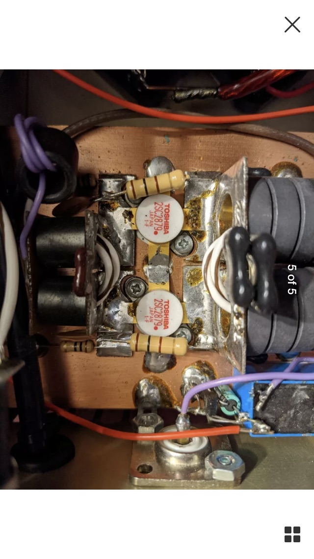

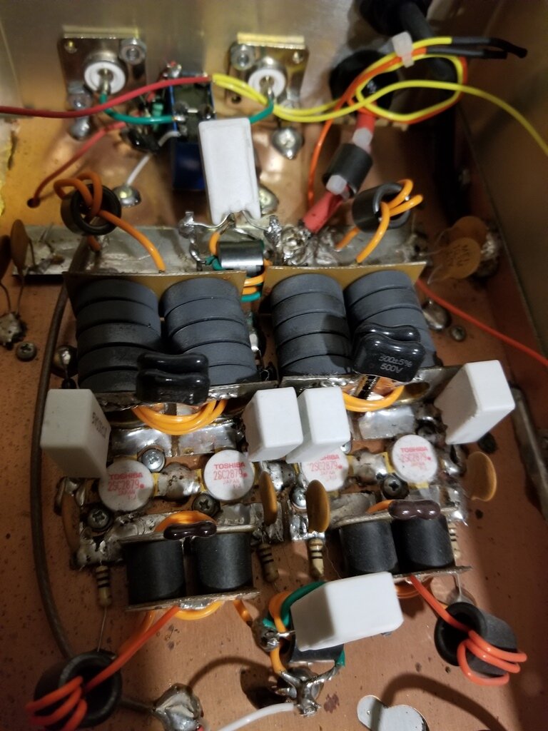

Are those white brick resistors non-inductive wirewound?
They appear to be ceramic-body radial-lead wirewounds. Designed to stand up vertically on a printed circuit board and consume less real estate than a part with axial leads.
Wirewound resistors are not always useless in RF circuits. Just most of the time. If the resistor's inductance is low enough, they'll work. Amplifiers meant to be wide banded will have a small inductance wired in series with the resistor and capacitor you see in the 11 meter-only linears. Some things work by accident. A wirewound in that spot probably qualifies.
