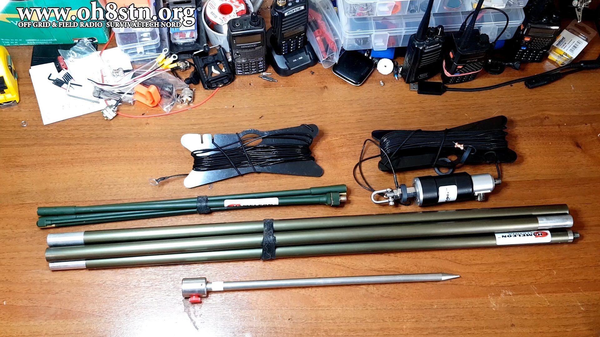

Here you go. I purchased the whip antenna and the extension shown in the pic as well as the hybrid micro matching unit and counterpoise wire. Did not get the ground spike (will use my tripod). Bought mine directly from Chameleon.

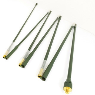

That Mil 2.0 brings back memories. Primarily of a radio slapping the back of my head. I know it would work better than a modified tent pole.
LOL.
That’s pretty much what this is. Tent poles sawed into pieces, painted, tied together with cord and given a fancy name. Add a magical matching unit and glowing eHam reviews, and I’ll have the World of HF at my fingertips. (y)

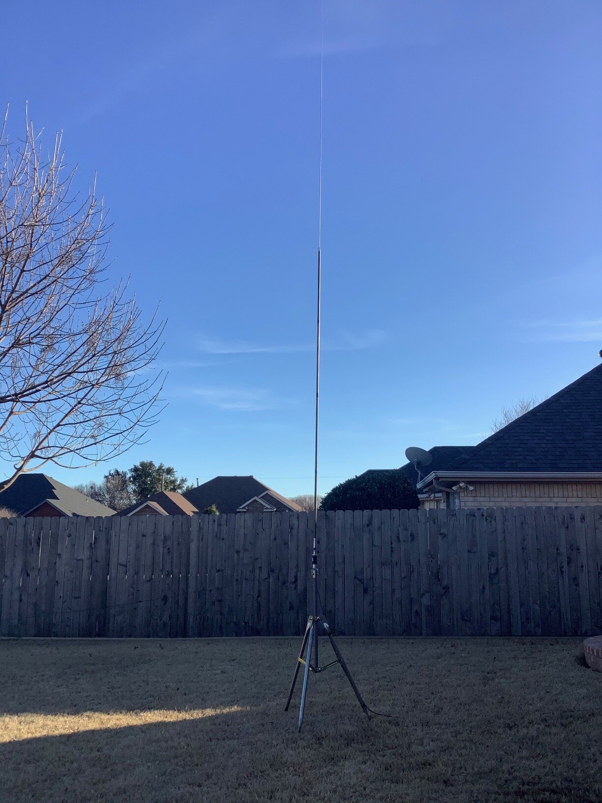

Things sometimes don't go as expected (or hoped for) when putting up a new antenna. But this time they did! :D

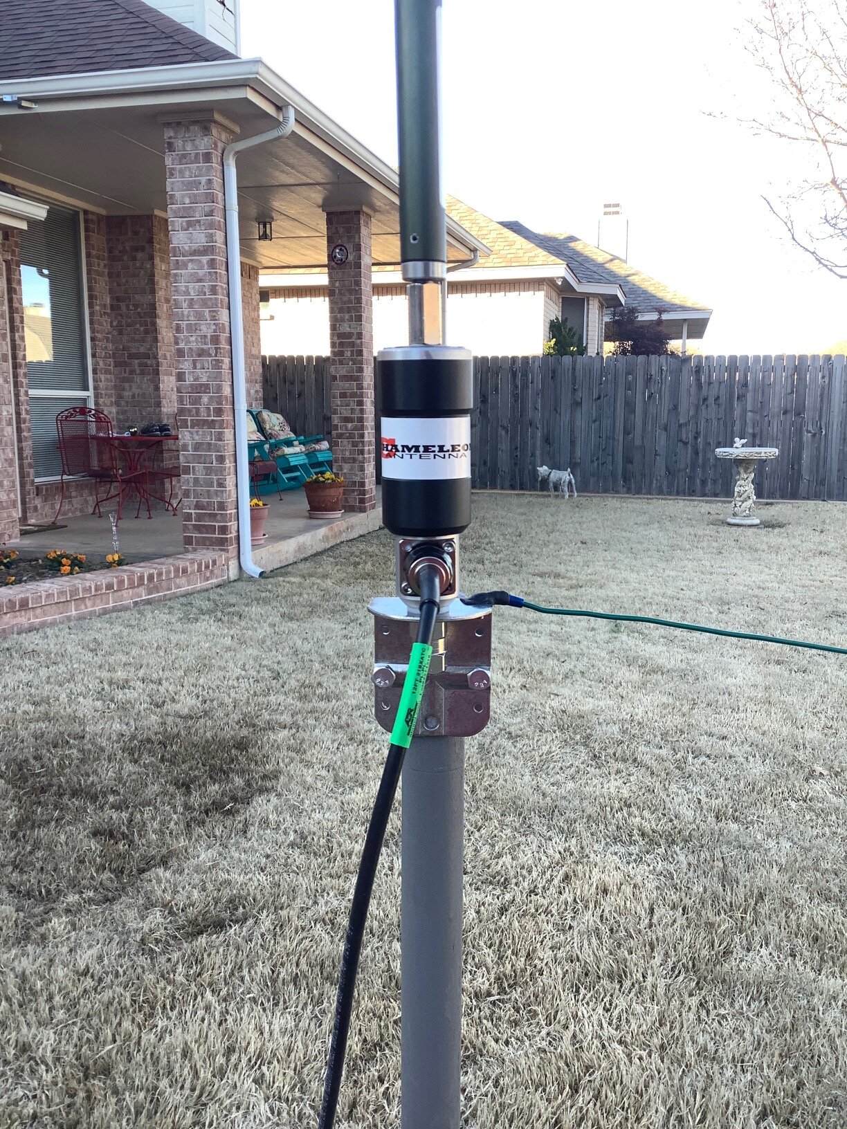

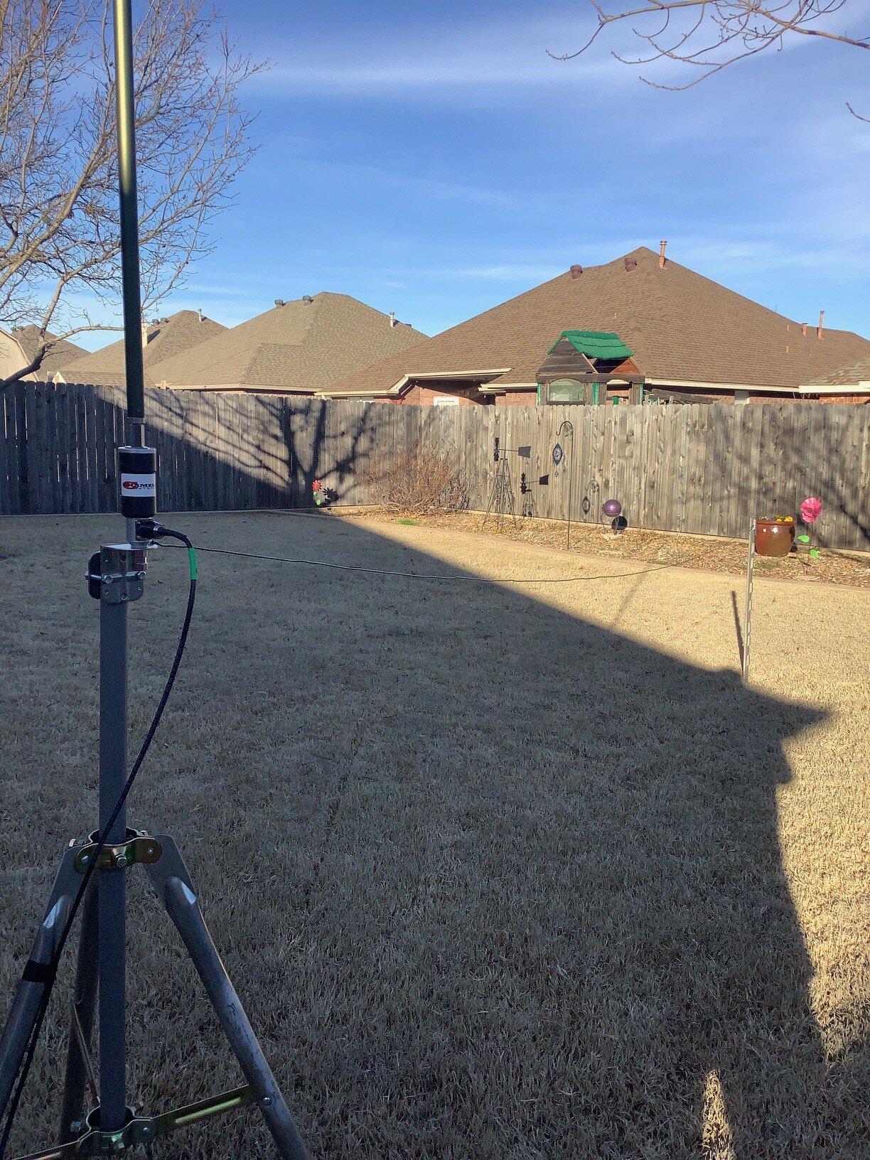

Set up my Chameleon Hybrid Micro atop my tripod 4' above the ground with the Chameleon Mil Ext 2.0 (105.5") and my 102" steel CB Whip atop it.
I ordered the Mil Whip 2.0 but found it too flexible and used the steel whip instead. For counterpoise I ran a single #14 copper wire (16.5') to a plastic electric fence post. (Tried a 30' wire but SWR's were slightly better with the shorter one.) Speaking of SWR's, here they are:
2.8 @ 3.600
3.0 @ 3.800
3.1 @ 4.000
2.4 @ 7.125
2.5 @ 7.200
2.7 @ 7.300
1.7 @ 14.150
1.7 @ 14.250
1.8 @ 14.350
1.5 @ 18.110
1.5 @ 18.130
1.4 @ 18.168
1.3 @ 21.200
1.4 @ 21.300
1.4 @ 21.450
1.5 @ 24.930
1.5 @ 24.960
1.5 @ 24.990
1.9 @ 28.300
1.8 @ 28.500
1.8 @ 28.700
I called this a 10-80 meter antenna in the title. Should have said 6-80 meters.
2.3 @ 50.100
2.3 @ 50.200
2.3 @ 50.300
With my internal tuner, all of these bands are now open to me. :)
