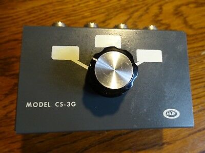

Coax switch?

As long as one radio doesn’t feed the other and cause an issue, I’m fine with whatever the brand is. I have my A99 hooked directly to my 2995DX, sometimes I’d like to be able to test other radios on the antenna without having to unhook the 2995.

The switches that shunt to ground when deselected would seem to be best for switching radios. That way the front ends don't get damaged. The MFJ switches that I showed do this.
