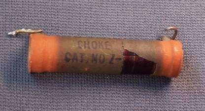

Found the pic and moved it to a new host. This is what the driver choke looks like after one set of driver tubes cherries up and blows.
Used to be the same color orange all over.
This one is strung between the inboard relay and the wire that leads upstairs to the driver tubes' plate caps.
Either using SSB on a linear with the 'stock' wiring on the driver sockets, OR using too much drive gets you this result.
Seen it over and over.
