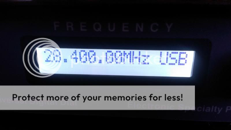

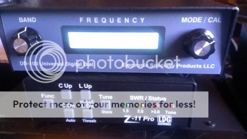

Received it yesterday, hooked it up today. It truly is plug and play (as advertised). The cable goes to the back of the unit, one for power, the other for signal. Other end goes to back of the rig and plugs into the VFO socket. It gets power from there, so no wall warts. :thumbup1: My crystals are original, so it was not spot on. Easy to custom set though, as described in the manual. This thing is really cool.

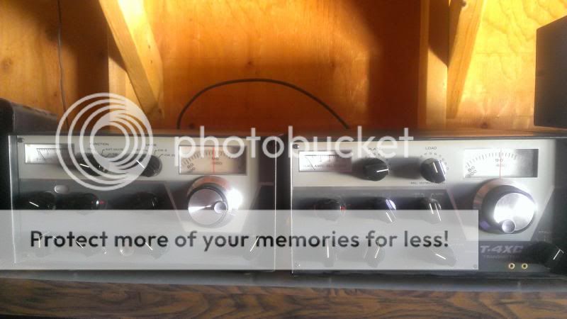

Hard to catch the display with my phone camera and the sun shining in the window. The display is very easy to see in person. This first picture reminds me I need to rearrange my shack!
