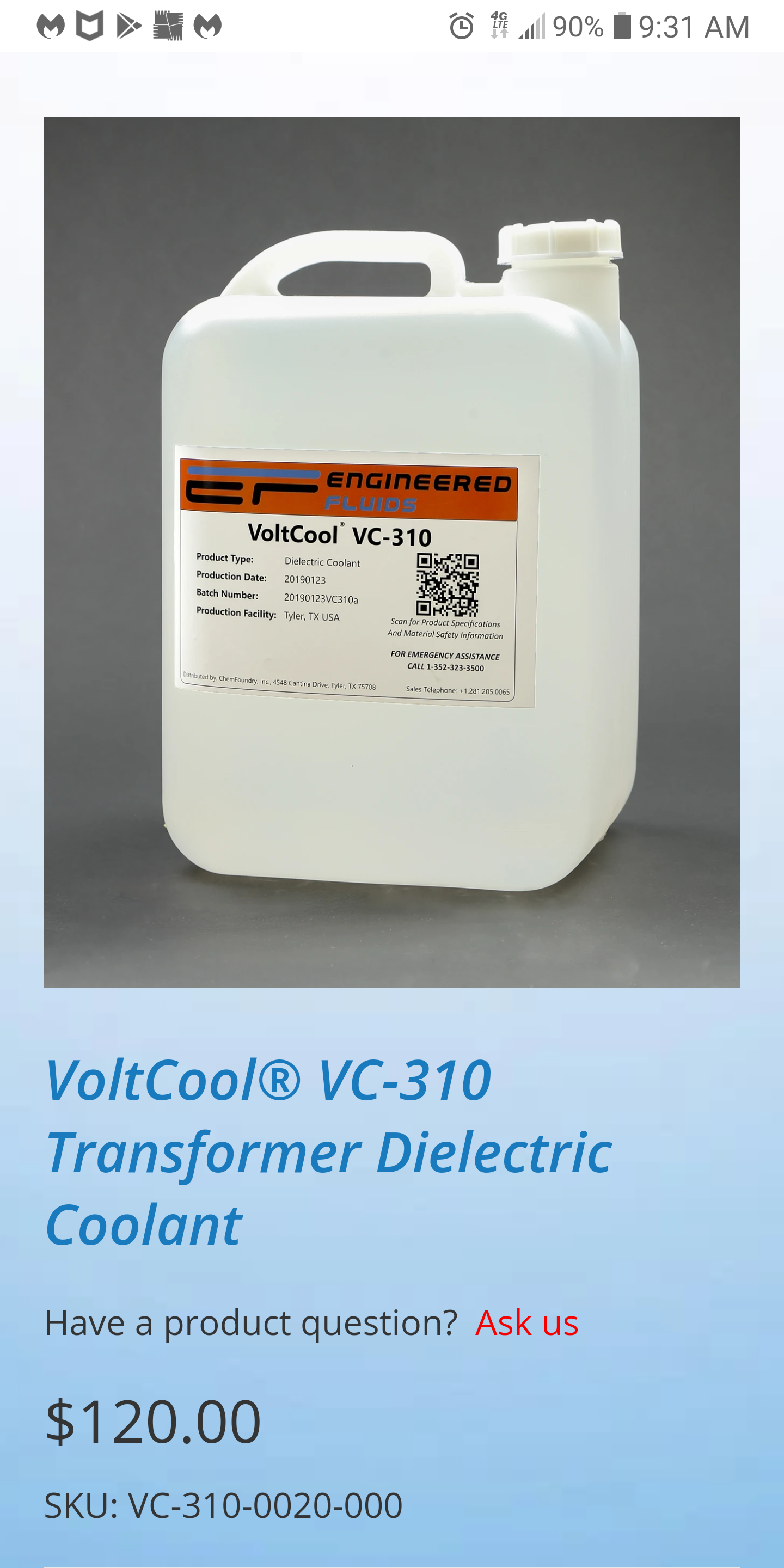

Dummy load fluid
Can be found on the same aisle as the muffler bearings just below the shelf which stocks the all the cordless extension cords!
A T F works just as good For a lot less &&&&
