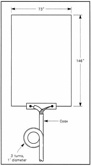

I watched that video and a couple of others very similar not long ago. Thought about building one, or one similar, just to see how well it works. Very simple indeed.
