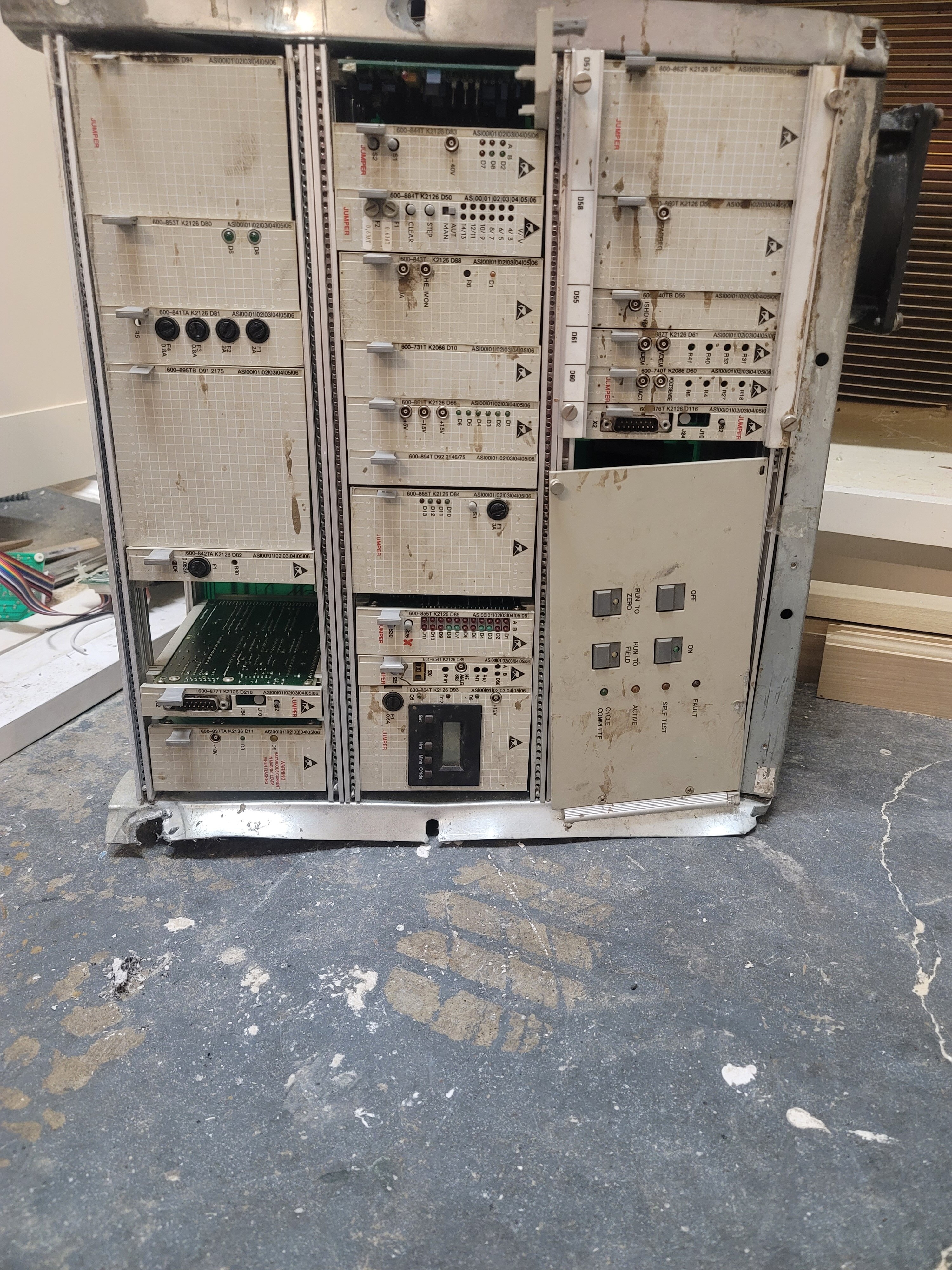

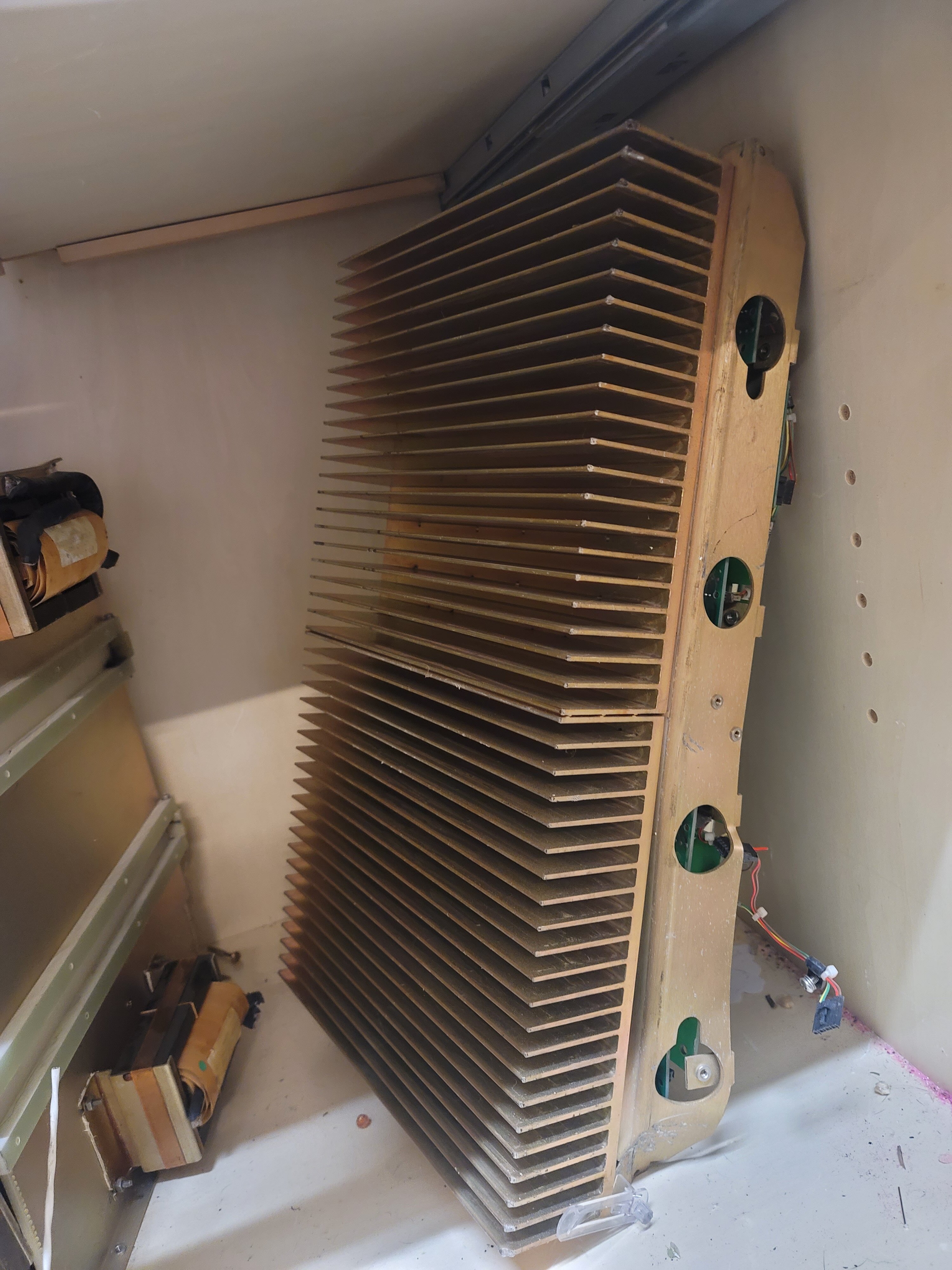

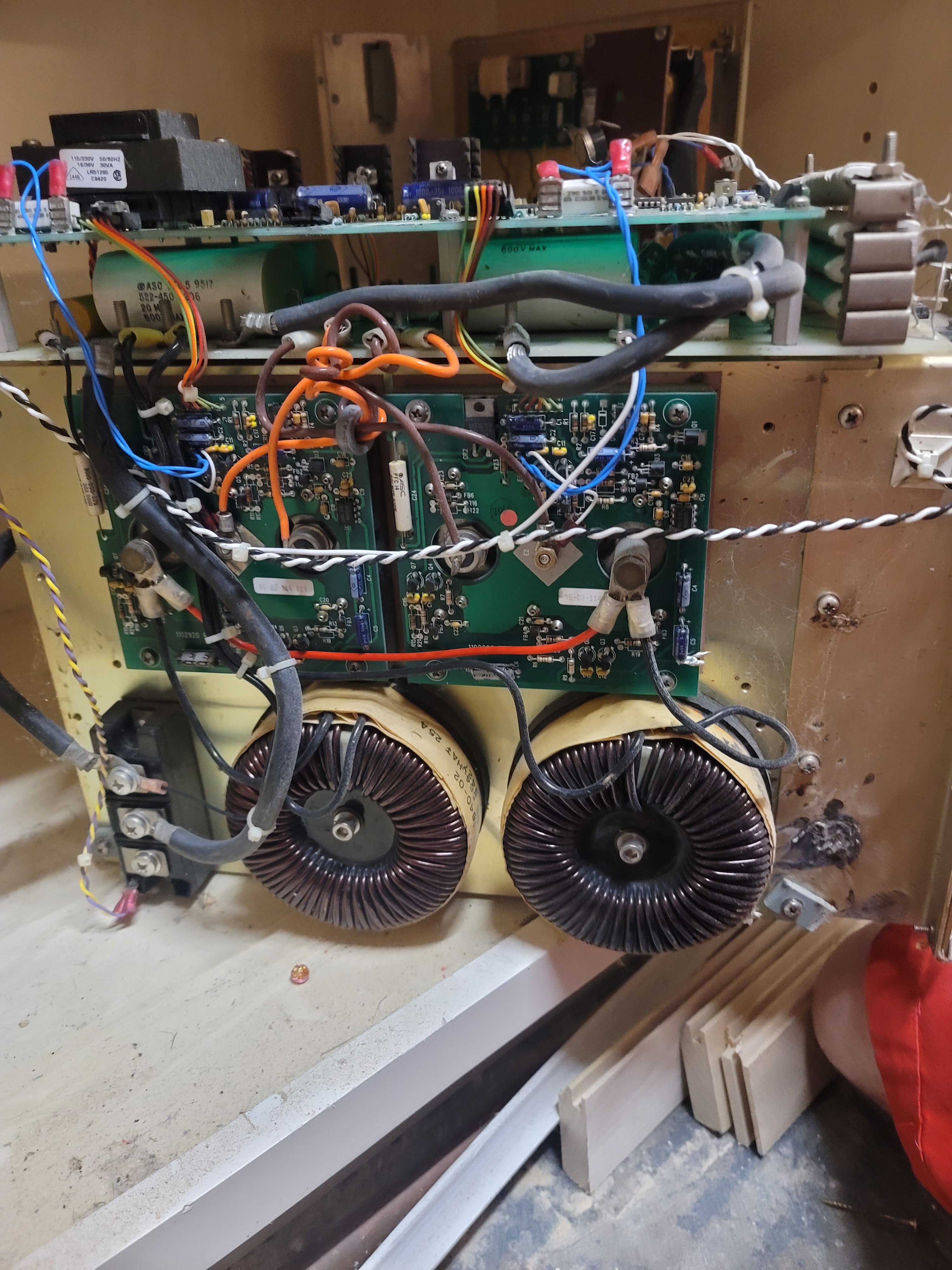

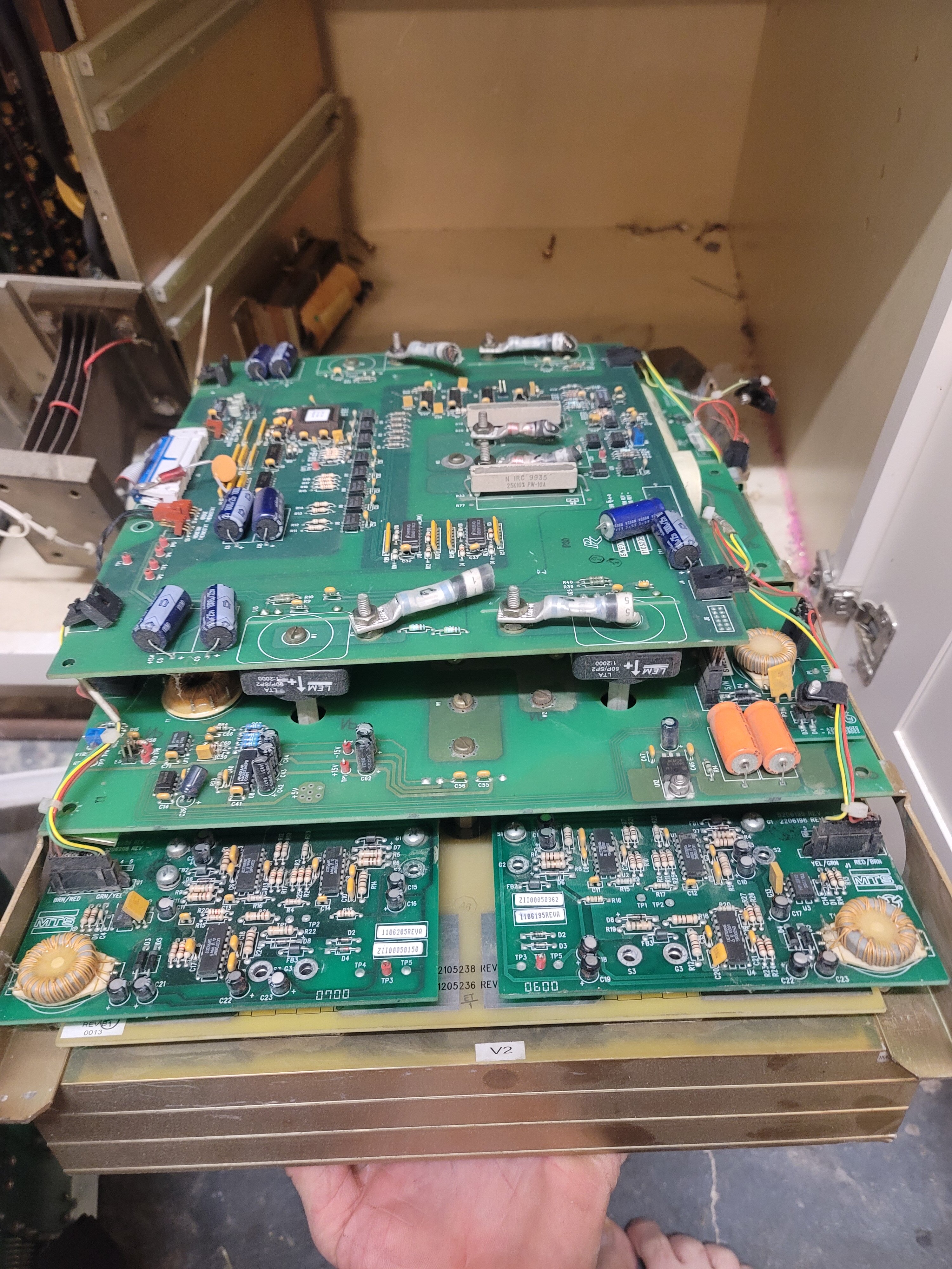

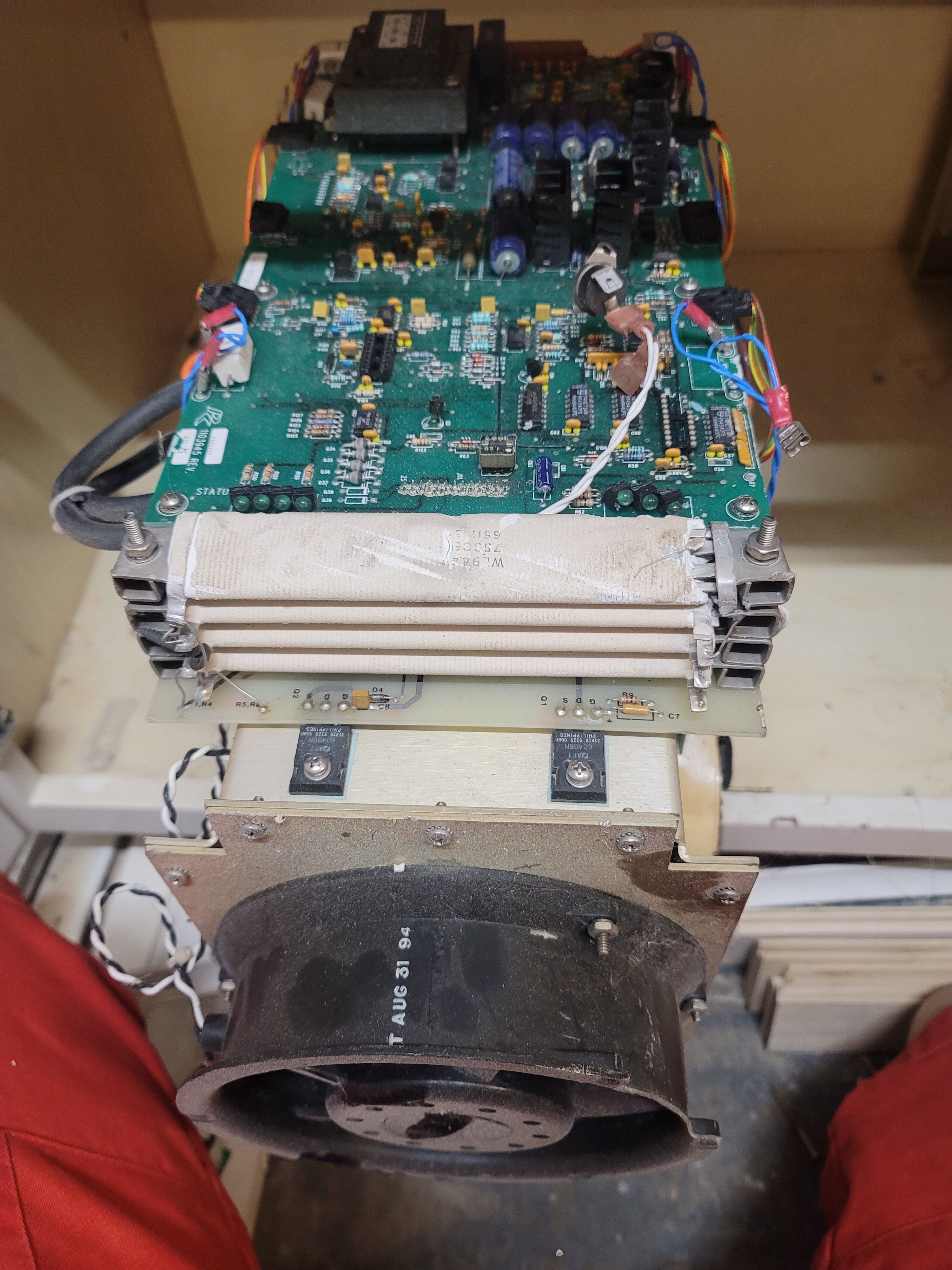

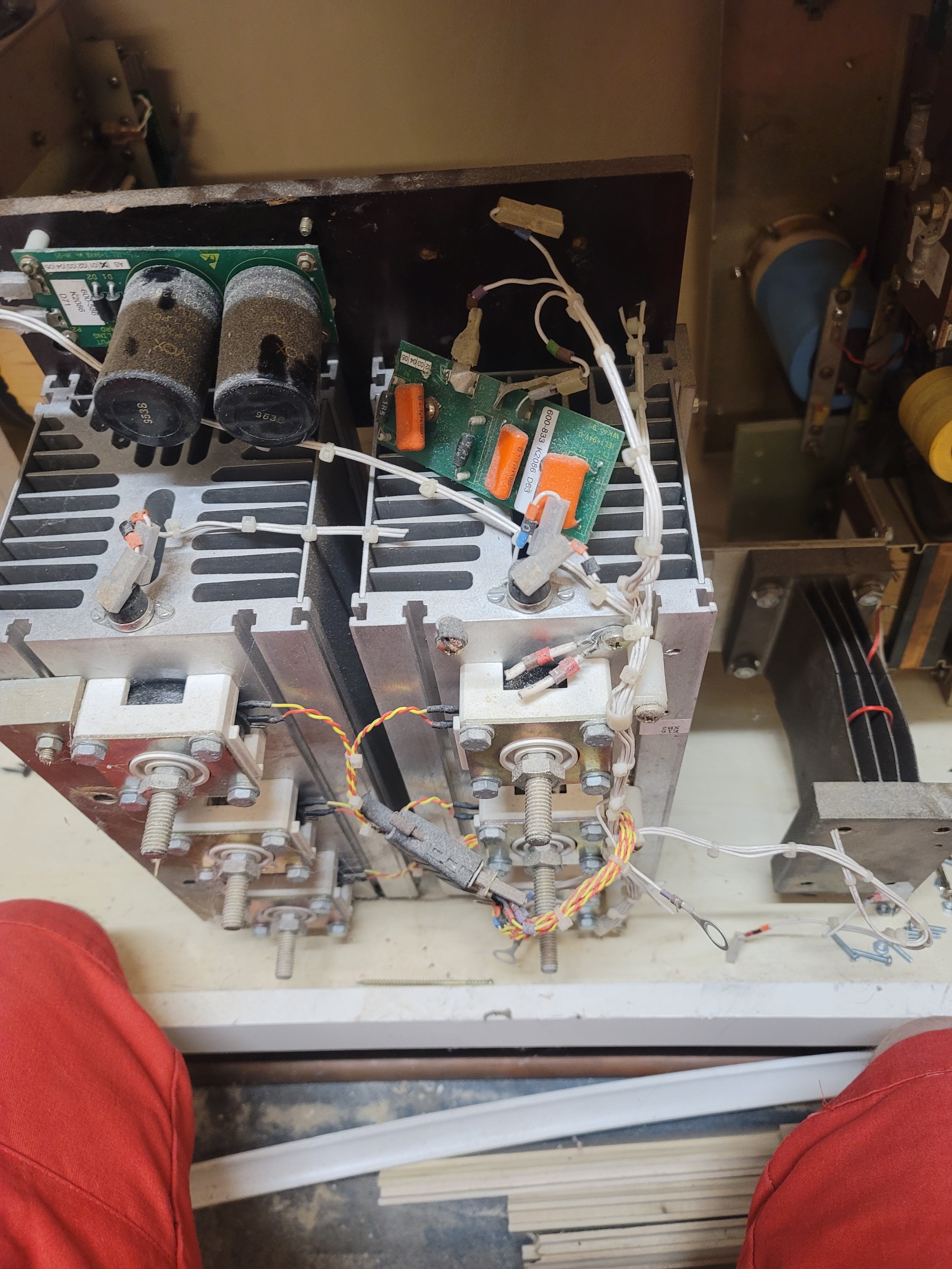

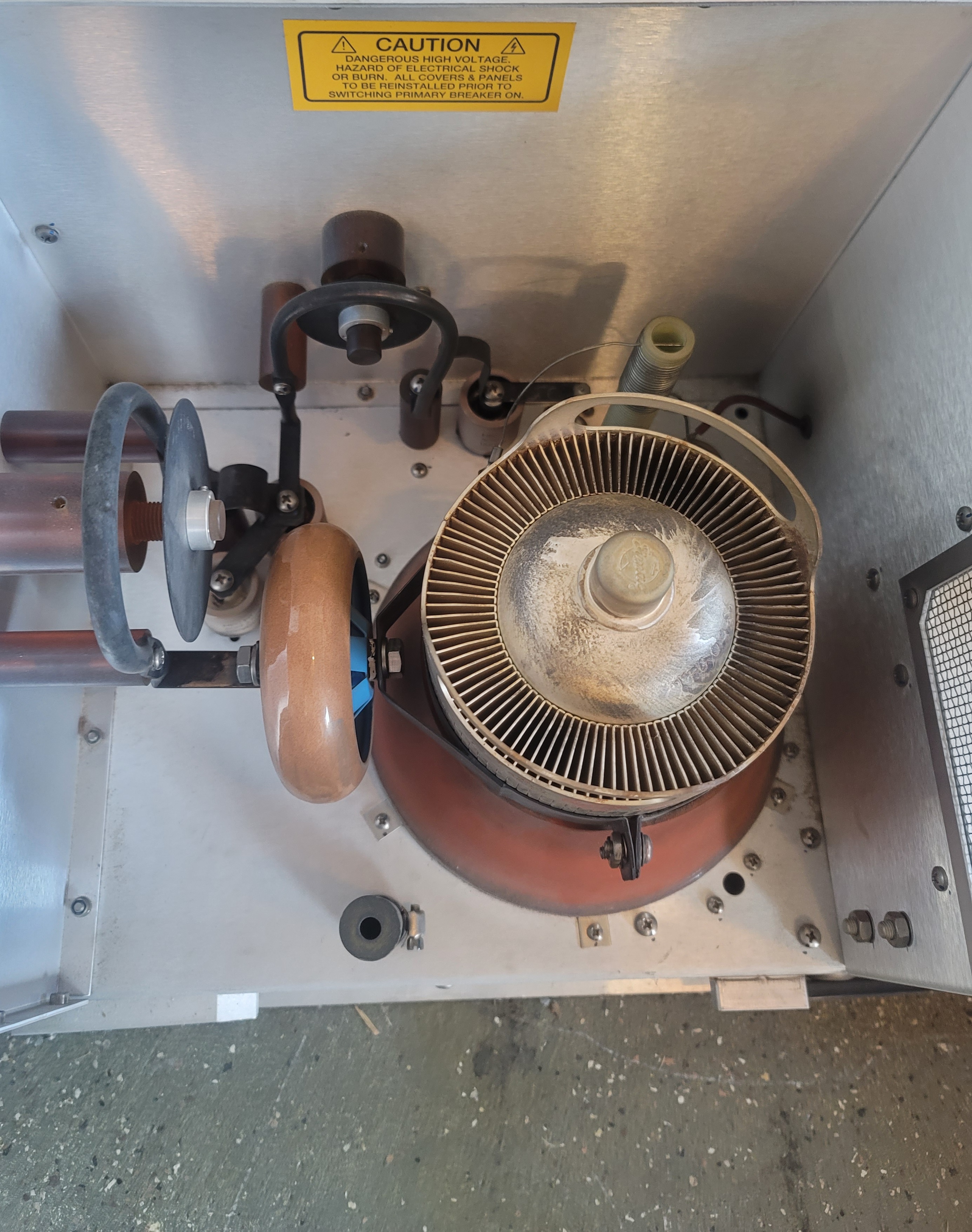

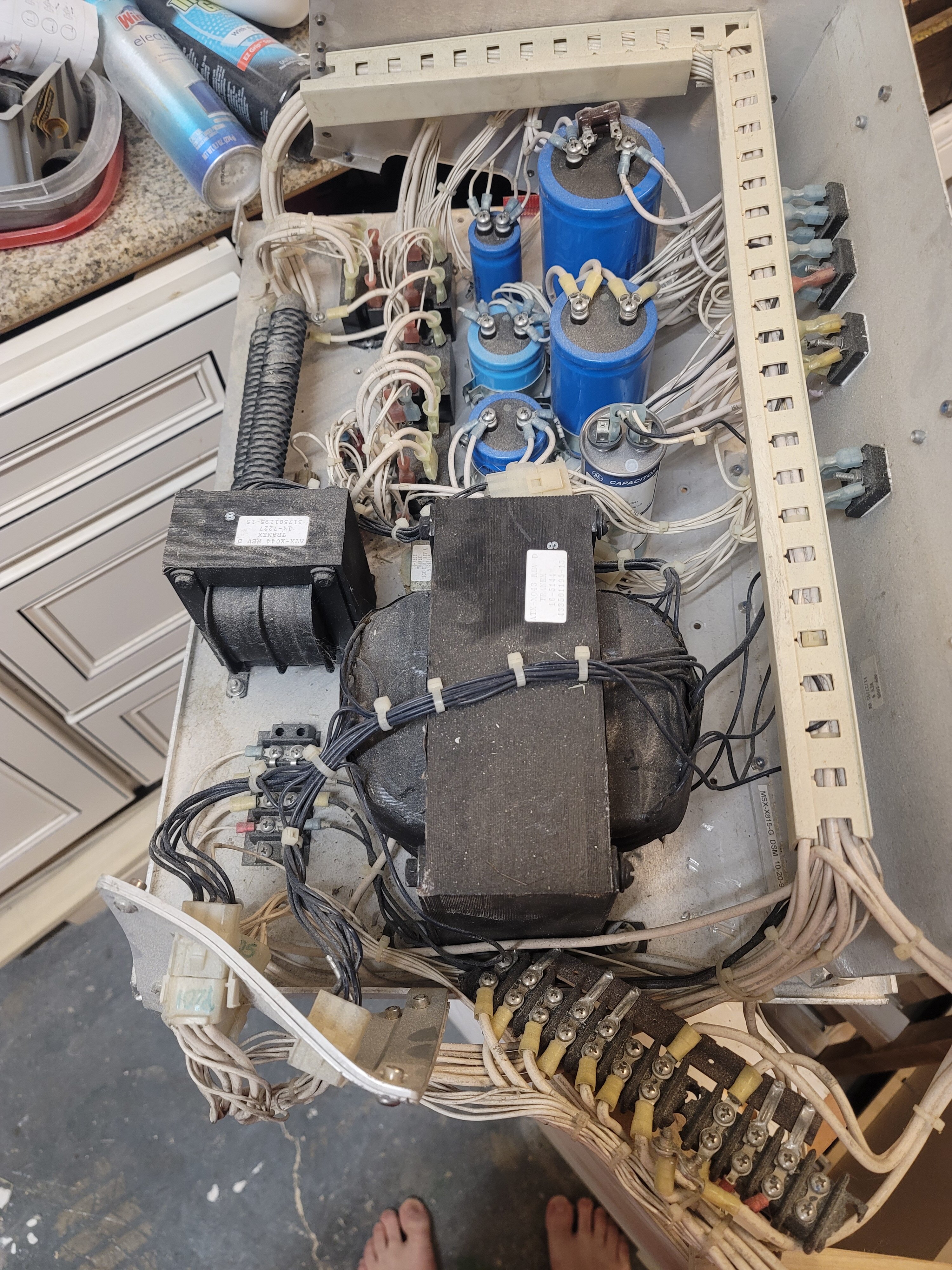

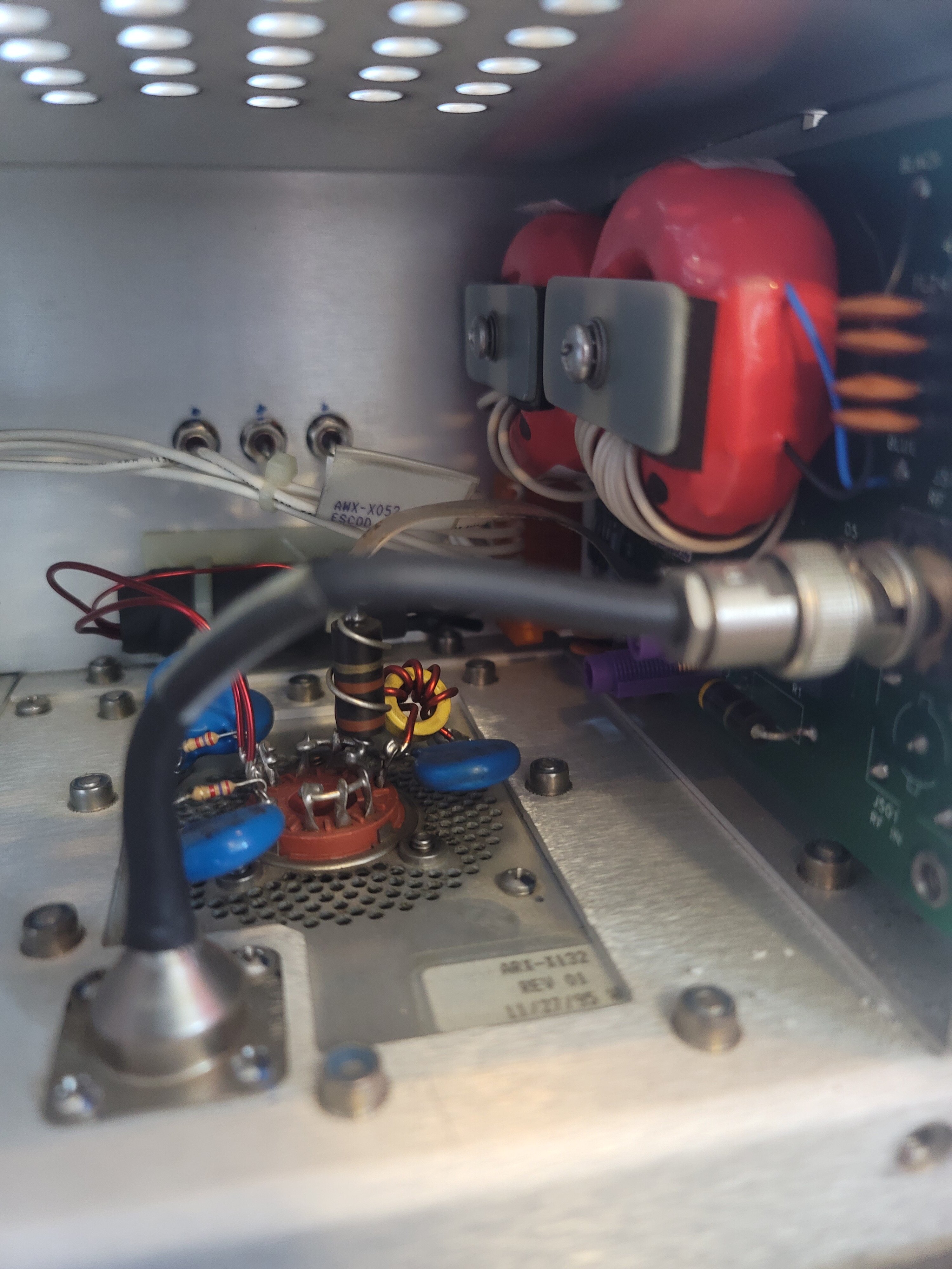

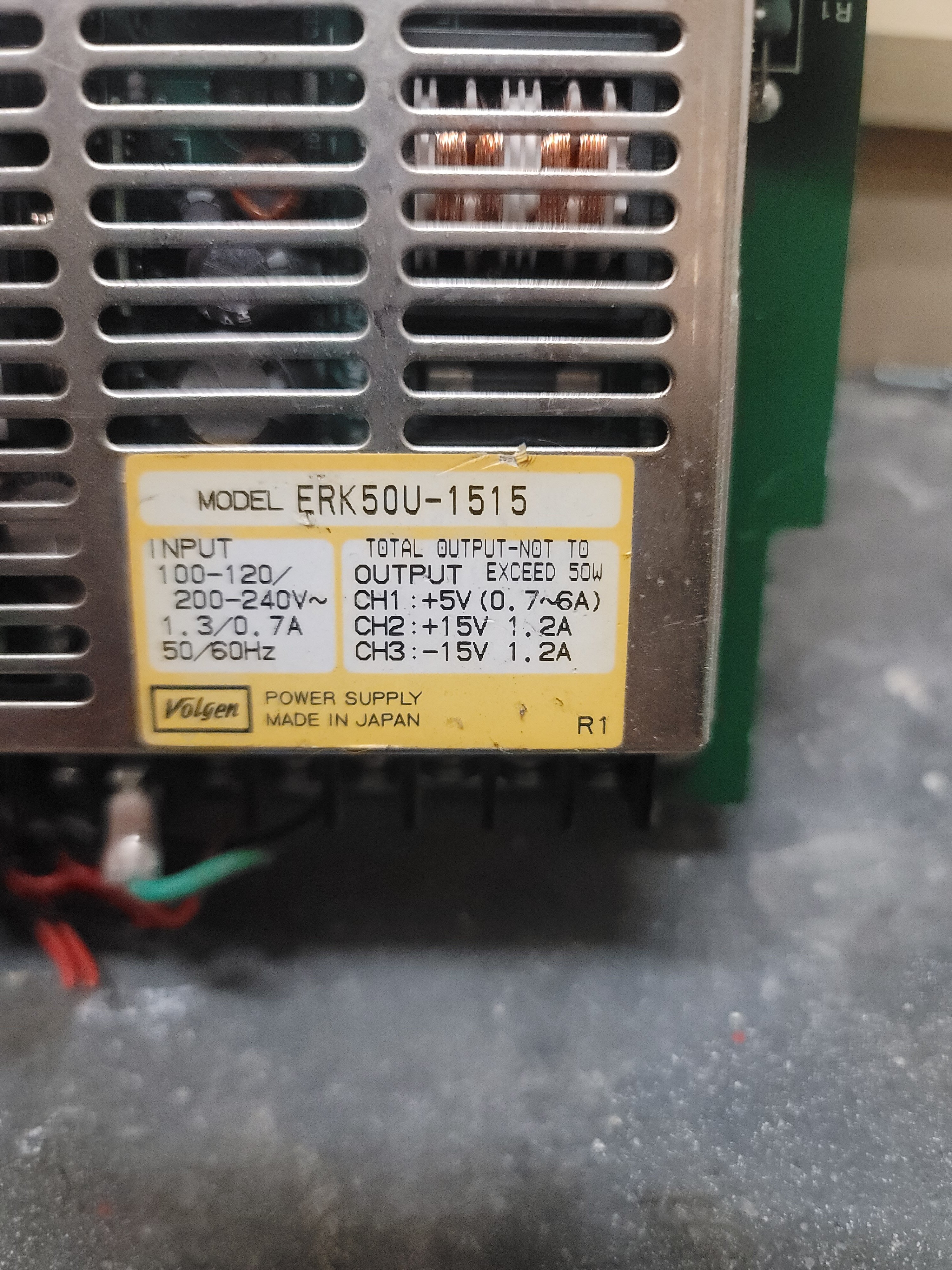

I came across this bulb, bulb amplifier and housing, transformers, huge heatsyncs that are attached to transistors? Tons smd components, and some pretty beefy capacitors.im not at all skilled nor knowledgeable in the electrical component field.(I could only wish!) This is a language of its own. I would list the stuff on ebay/Amazon, but idk enough to do so. Would any of you guys know anyone that would be interested in this kind of stuff?

Sure sounds like what you need is for someone to look at it and tell you what you have.
Kinda hard to locate a market for your stuff until you can identify who that market is. Sounds like you're looking for someone who builds amplifiers and buys big parts to do it.
I will suggest one possible fly in the ointment. Not all large power tubes are amplifiers. Industrial RF generators will use a tube in a big power oscillator circuit. This kind of tube has very low gain, and won't multiply the power level enough to build a satisfactory amplifier. This kind of industrial oscillator is used to melt plastic, weld plastic or generally heat stuff up with RF.
If that's what you have it won't be as sexy as actual amplifier components.
One bad surprise that comes with an industrial RF heater is in the power supply. It will generally be designed to hold the power down to a safe level for the tube. Using this kind of transformer for a linear amplifier holds down the wattage. Not what the linear operator wants.
But what you really need is for someone who can tell the difference to look it over. Then you'll know if all my warnings are just wasted hot air, or if they'll turn out to be actual bad news.
Maybe some pics would be a good start?

I attached a few pictures of some of the parts I have.
Thanks for taking the time to help me.
I seen it, but that's a different language to this guy! Lol. I understand that it's showing it's capabilities and limits, but what it takes to safely fire one up is beyond me... heck I don't even know what a grid is lol. I know...pathetic.
