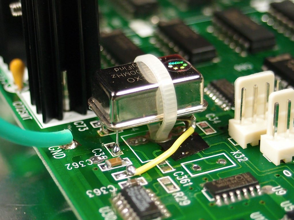

hmm the Crystal in it is 10mhz and i see TCXO at 10MHz on line for $25
looking around i see some one did this mod..
what do you guts think?

I did the mod with the TCXO and power it up compared it to my TS-2000 it was .000002 off at 10.000 mhz..
