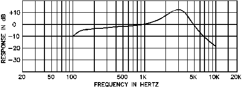

The D-104 has a frequency response that definitely favours the high end. using the standard audio reference frequency of 1 KHz the D-104 attenuates frequencies around 100 Hz as much as 10 dB while accentuating frequencies around 3 KHz by 10 dB or more. This means a difference of as much as 20 dB from low end to high end of the normal voice communications bandwidth. This is further affected to one degree or another by any impedance mismatch between the microphone and the radio. Some people have a voice that is the opposite and it all works out. My voice has more highs in it however the stock D104 sounds fantastic on my Kenwood TS-820S when used with a small amount of compression. This is coming from a broadcast engineer with whom I worked with for over 20 years. Dave knows my voice and what good audio should sound like. On my Heath DX-60 AM transmitter I ran the d104 through an equalizer with a response curve the exact opposite of the microphone, boosting the lows by as much as 10 dB and cutting the highs as much as 10 dB. Since the freq. response was flat and the DX-60 audio input as wide as a barn door it sounded great as well but with a completely different response curve from the EQ. Every radio has a different response curve as does every voice and every microphone. The trick is to bring all three variables together into what sounds the best for YOU and your RADIO. This may be completely useless for someone else.
D-104 response curve.
