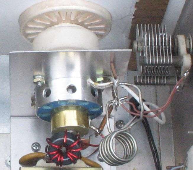

About that GI-7b.

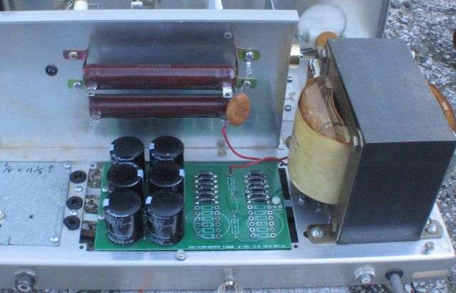

Takes closer to 2kV to get any real power gain from it. A sweep-tube box that uses a full-wave doubler for B+ won't achieve that easily.
An amplifier that used a full-wave bridge to get 800 or 900 Volts can be reconfigured to use a full-wave doubler and get enough B+ for that tube. But only if the higher voltage doesn't exceed the insulation on the transformer's windings.
Easy enough to tell in advance. Take the HV winding's wires loose and put a couple of kV on them. If the insulation holds up, you're probably good to go.

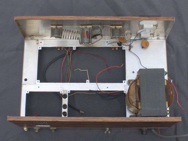

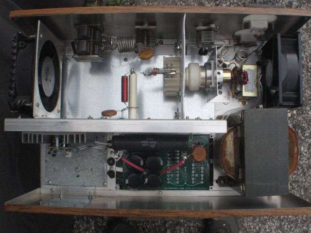

That's how we converted this Eagle 525 for that tube.
It's a pretty invasive mod.
This one proved that it's more work than it's worth.

Nice work with that GI-7B. It seems the Eagle 525 was ripe for this type of mod because it's got the right transformer that can be converted with a doubler. I managed to put one 4CX250 inside the same box so it has similar gain and output as the two stages did with the sweep tube drivers. Definitely not worth the work unless you obtain the amp for free with beat 20LF6 tubes.
