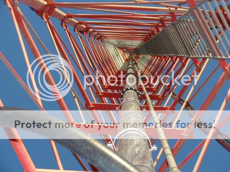

That's not a tower. :whistle: Now THIS is a real tower. :laugh:
BTW that tower you linked too was for commercial radio/cellular. The following is a ham radio tower at OH8X a contest station in Finland.
