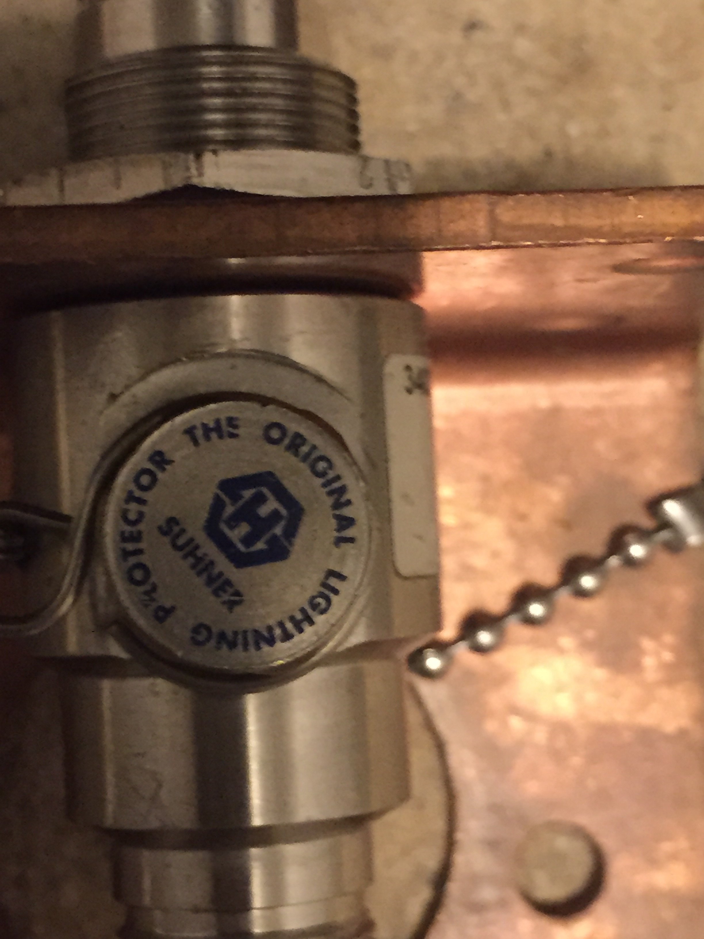

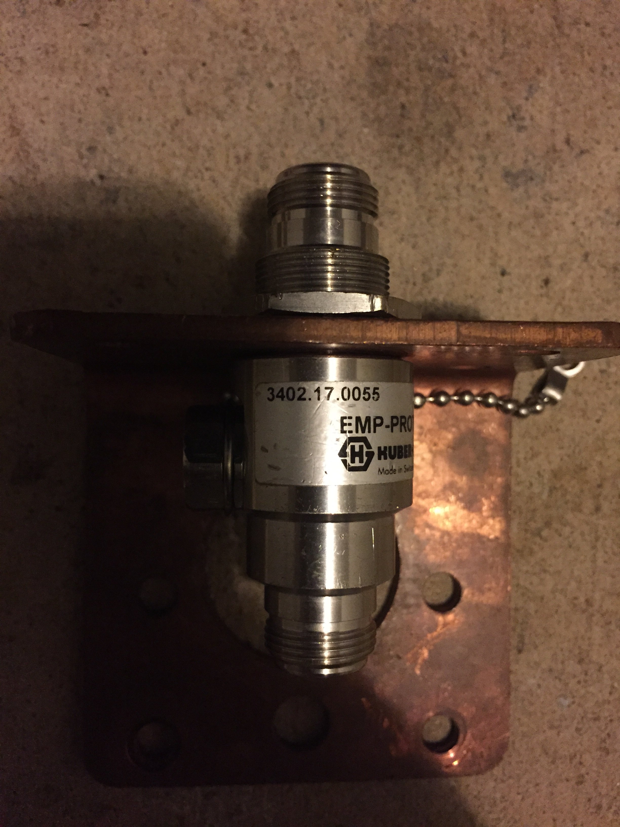

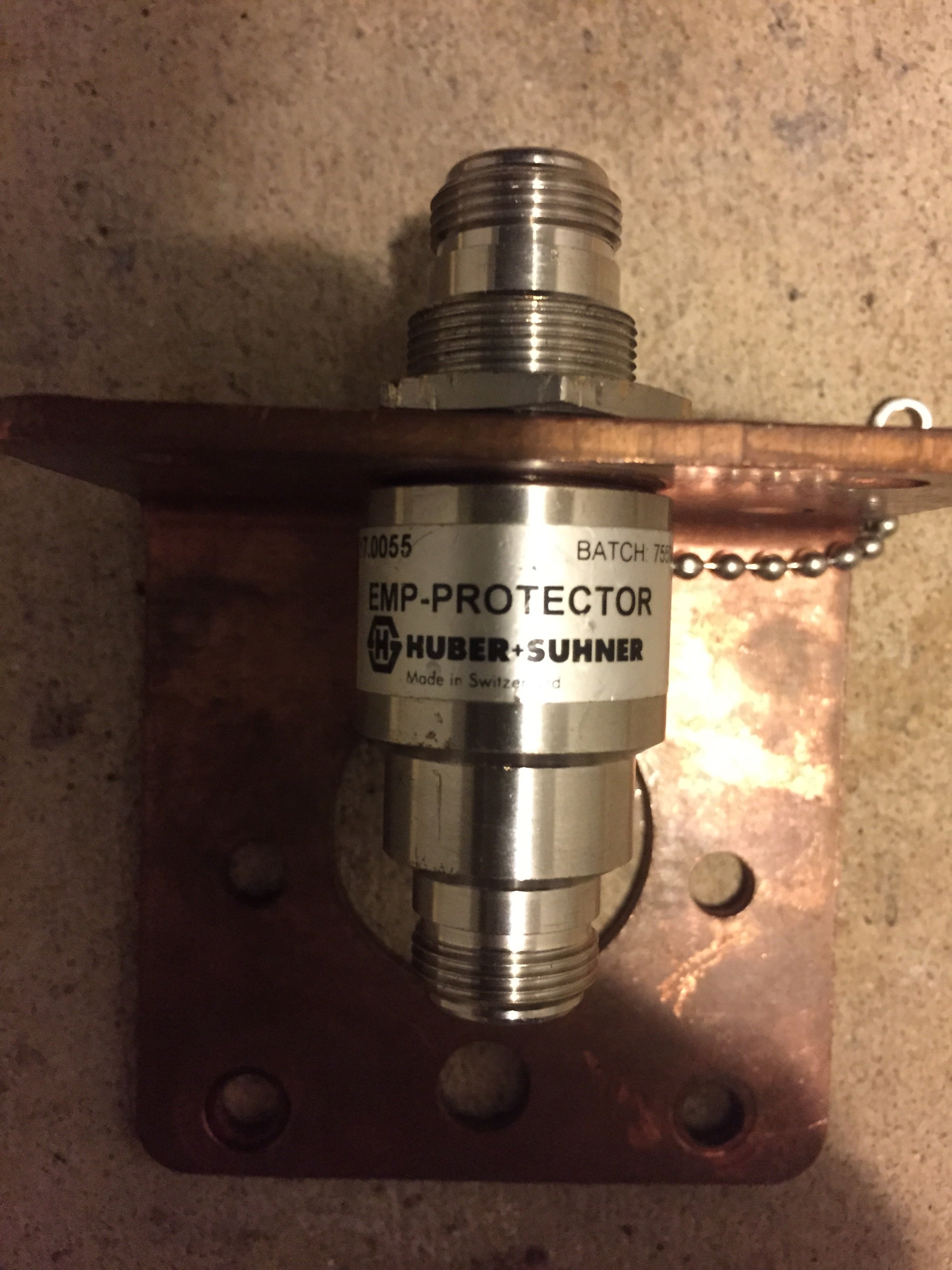

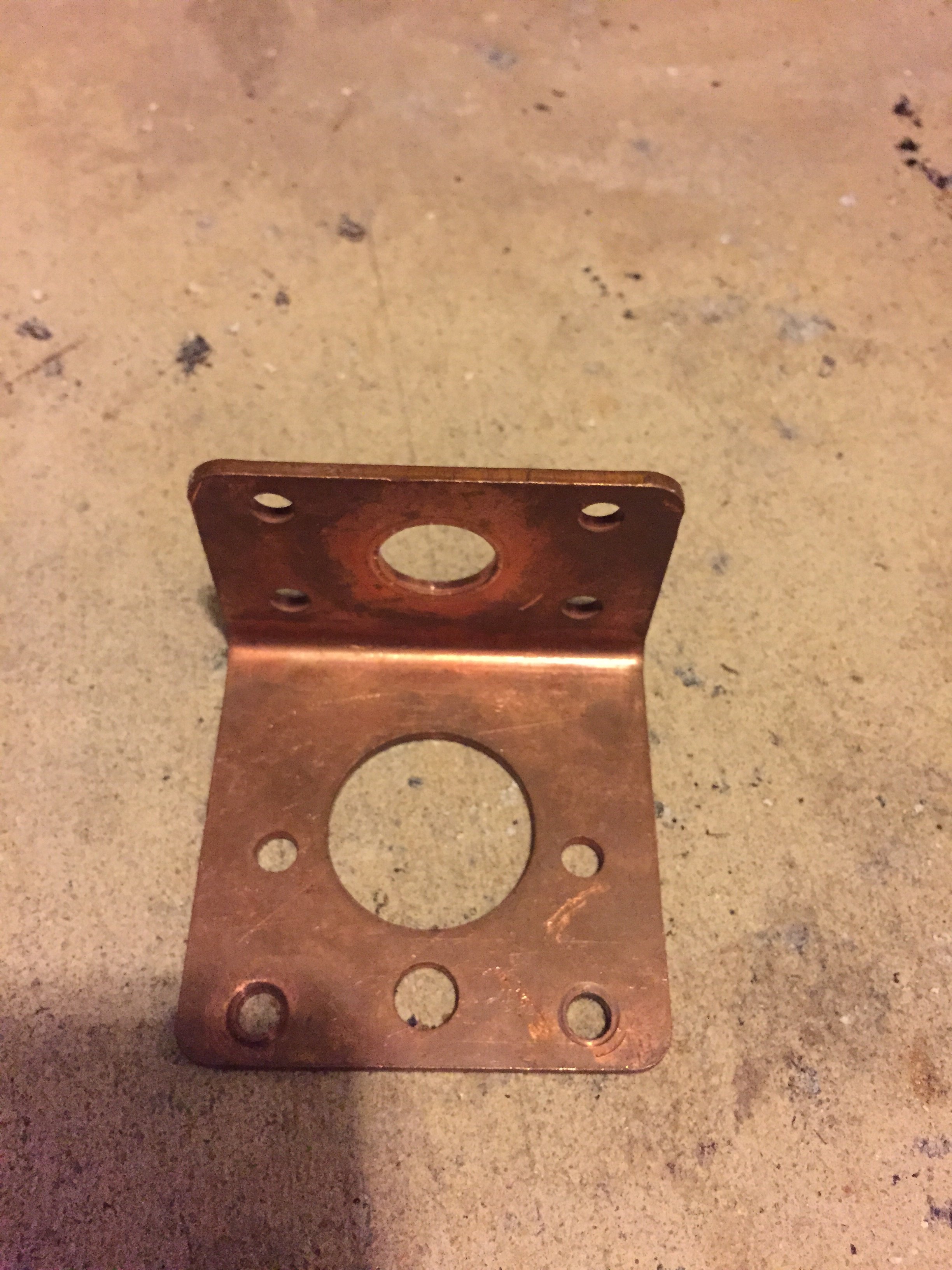

image.jpg Huber Suhner makes a good surge arrestor. Andrew makes a good one too. I have been I one cell site in 16 years that was hit directly by lightning and the surge arresters did their job, stopping the hit at the hatch plate before it entered the shelter. Here are a couple of photos of the huber sunher type.
You will need a mounting bracket like the one I posted to mount it to or a ground buss bar.
Add this as close as you can to the antenna. You can replace the gas discharge tube in them if they do get hit. And make sure to get the proper discharge tubes that are rated for the power output from the transmitter. Hope this helps.

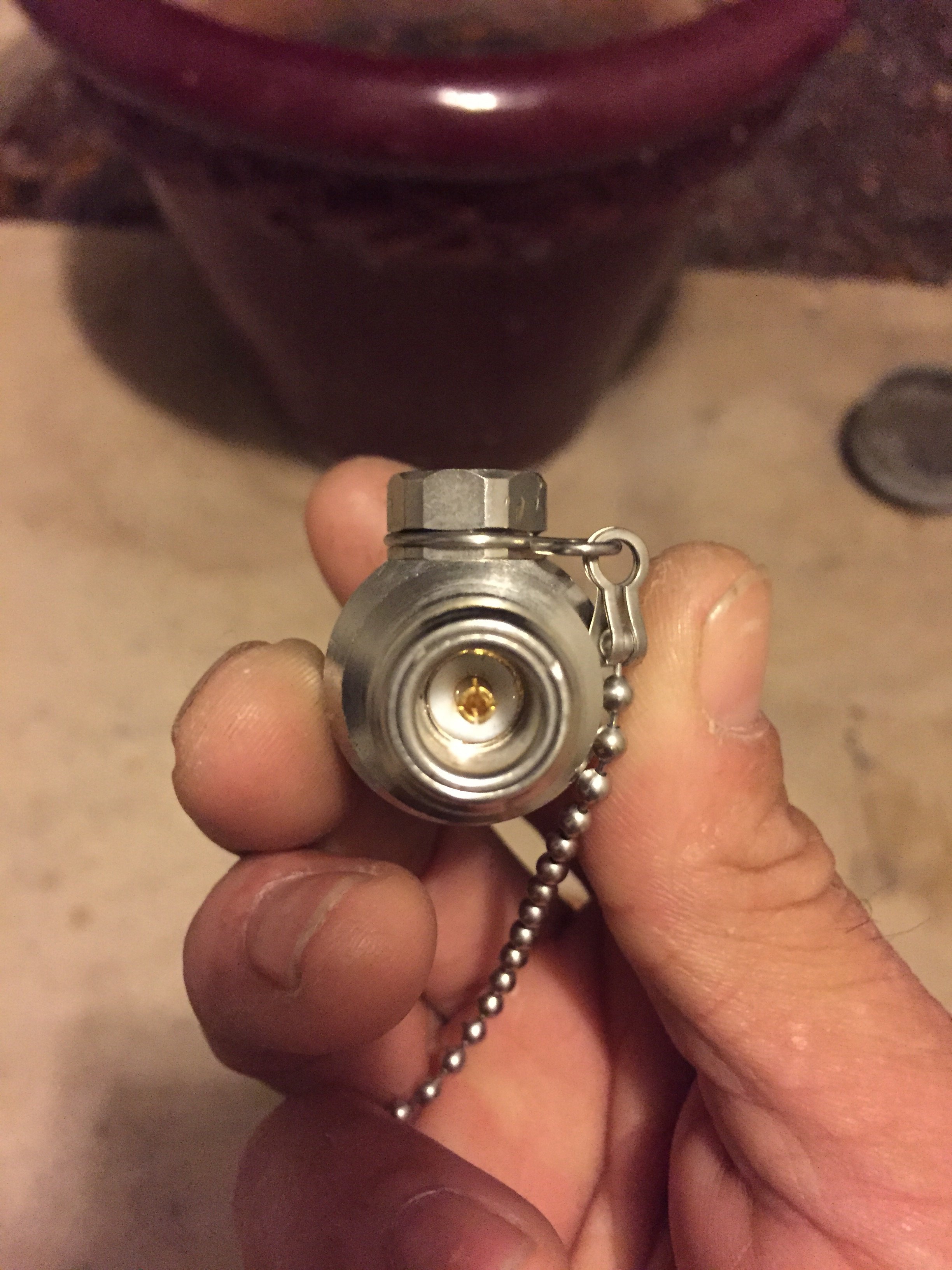

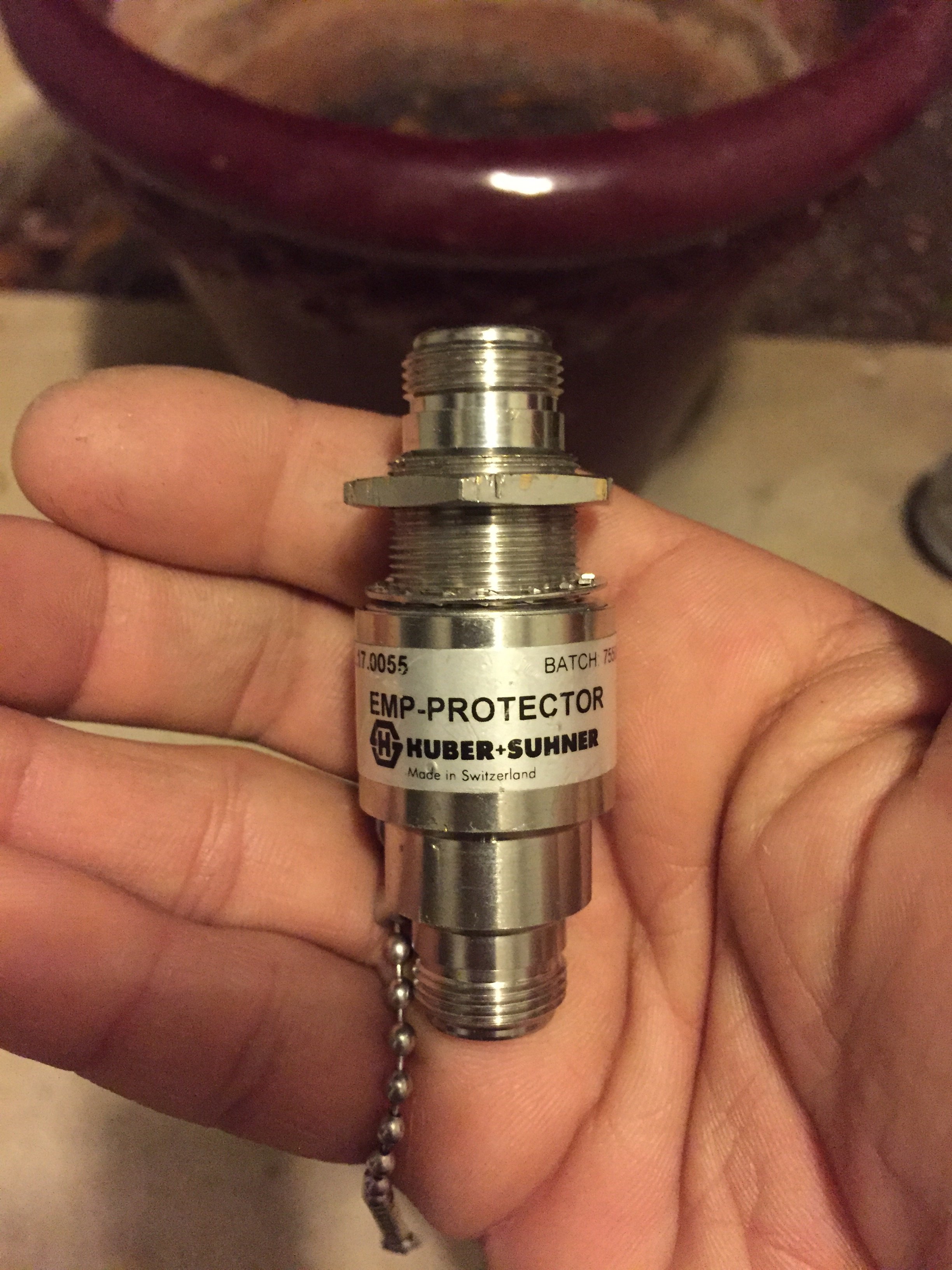

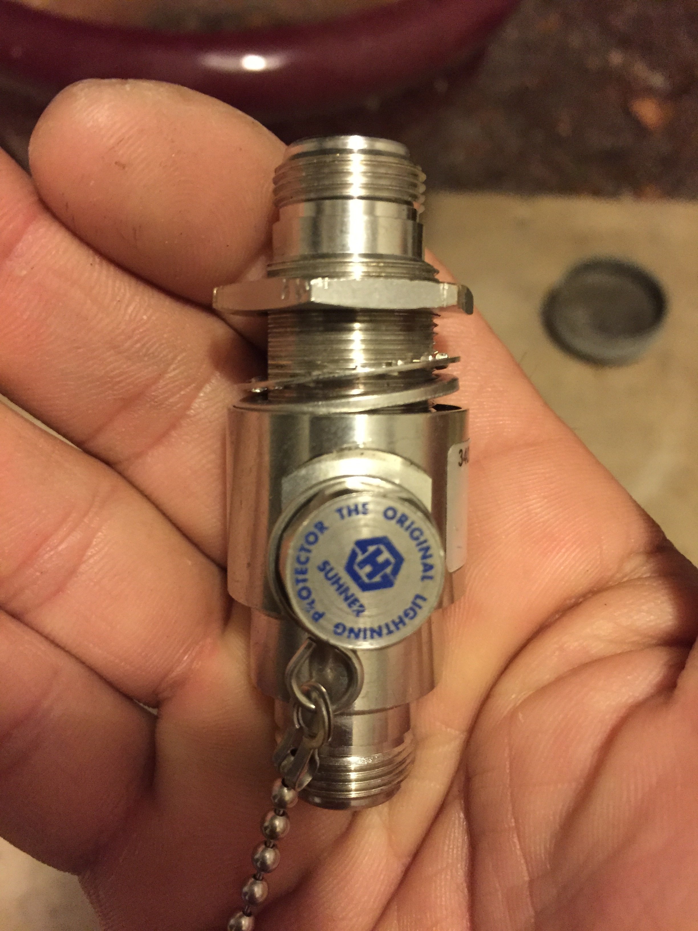

Here are a couple more photos of the surge arrester. And also these are n-female connections. So n-make connectors are needed. Hope this helps and hope all is well with you and yours Tallman!!
