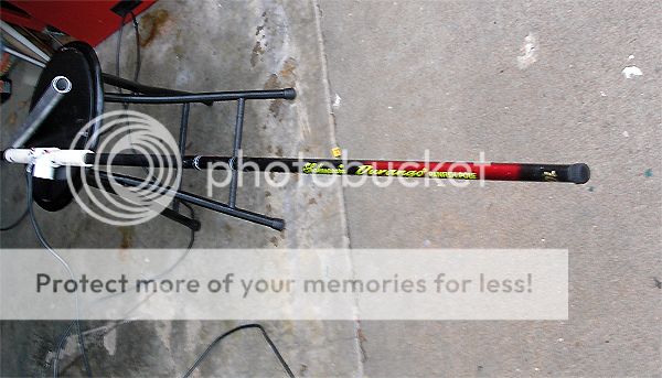

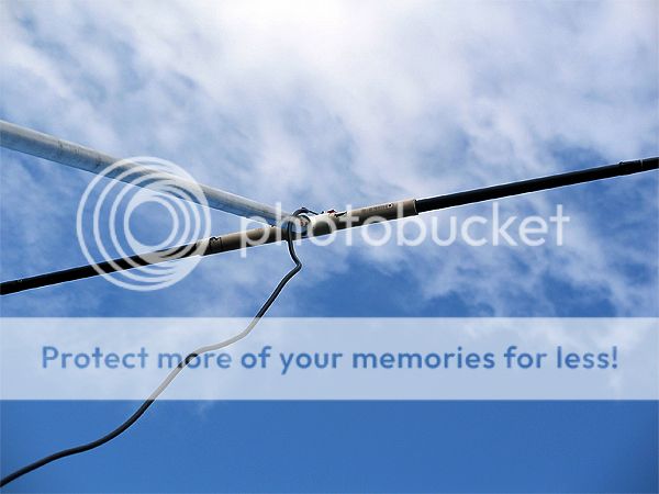

Or go to Walmart and buy two extendable crappie poles for $7 each and put one together with some PVC, wire, and tape.

if you don.t need a more permanent or long lasting setup you can just use $5 worth of PVC from home depot or lowes . three 10 ft sections and a 4-way . or a wood 2x4 and some 1/2 inch metal conduit . just different ways of skinning a cat .

The crappie (fishing) poles are extendable. When scoped in they are only about 4' long, but when extended can be 10' or longer based on which one you buy.
At the local Walmart where I live I can buy the 13' long poles for about $7 each. The PVC fittings are a few cents each at your local Home Depot.
It works as well as any dipole you can buy. A dipole is a simple, the simplest, antenna to make and use. I have talked locally and skip easily with one.
