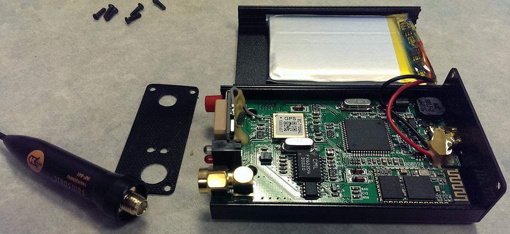

Not one ping made it onto the network. I was trying the "improved" antenna from my GT-3M2. Maybe the antenna was not contacting. I could not remove the antenna when I got to where I was going because of the way they switched the connector genders. The male SMA is in the radio and that is the connector with the nut. So now, the nut just spins in the case as you twist the antenna. Proper procedure would have you holding the antenna and device, and just twisting the nut so the center pin does not rotate in the connector and cause wear issues. Now I have to take the daamn screws outta this thing already.
Here is the insides. I was pleased to see the GPS module in a logical orientation. And there is the reason I took the covers off, the right angle SMA connector. I'm thinking of screwing something on there and then epoxying the nut in place. I'l also put something between the circuit board and the battery.

Well, I tacked some solder around the SMA nut (with something screwed into the connector) so hopefully the antenna connector will not be giving me any more trouble. I don't think that was the problem since I was able to tighten it when I put it on.

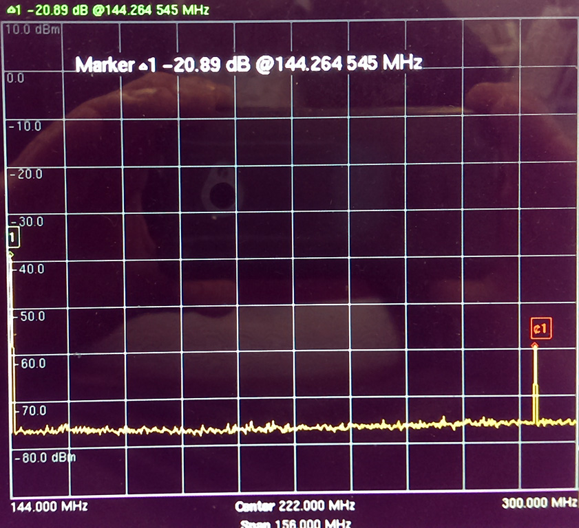

I just did a quick harmonic check, ~ -20 dBc (estimating about 10 mW conducted). I am just picking up the signal on an open coax, so take it with some sodium chloride.

I measured the RF output with my Diamond cross needle SX144 something like that meter...I connected the AP510 using adapters and had a coaxial 2W load on the output. I was getting a solid 1.5W conducted output.
