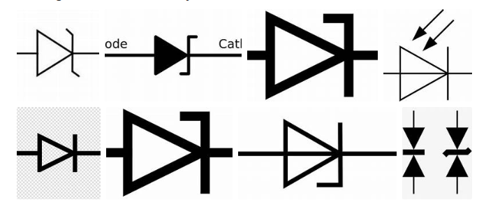

You know what a "Zener Diode" symbol is? Correct?
Bing as well as other search engines are at a loss to know the exact terminology or even how to draw a "toon" of the symbol to make sense.
The key word here is to remove any references to "Schottky" or similar doped and built 1-layer junctions. Because when you look at the PDF - it's missing the other lower half - so its done not as a lazy (or perhaps it is) way to draw it - but to denote the device in singular form as being a Zener Diode and Not a Varactor or TVS (Bi-direction Surge device) or those gawd-auwlful noisy schottky's and a lot of this is getting carried away by those that know, are not stepping up to the place and saying Hold It!
