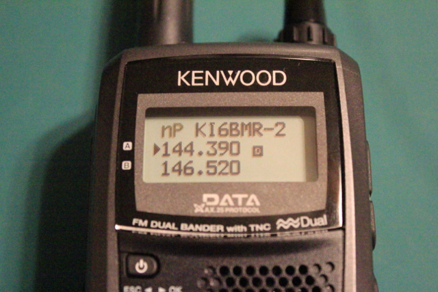

Menu 3U0 - Display area changes the popup so that it only takes the top line of the screen. Here is an example:
This is a pretty good compromise, but I would still like to be able to turn the popup completely off. Menu 3BO - Position Limiter sets the distance in miles from you to filter out stations from the APRS list
