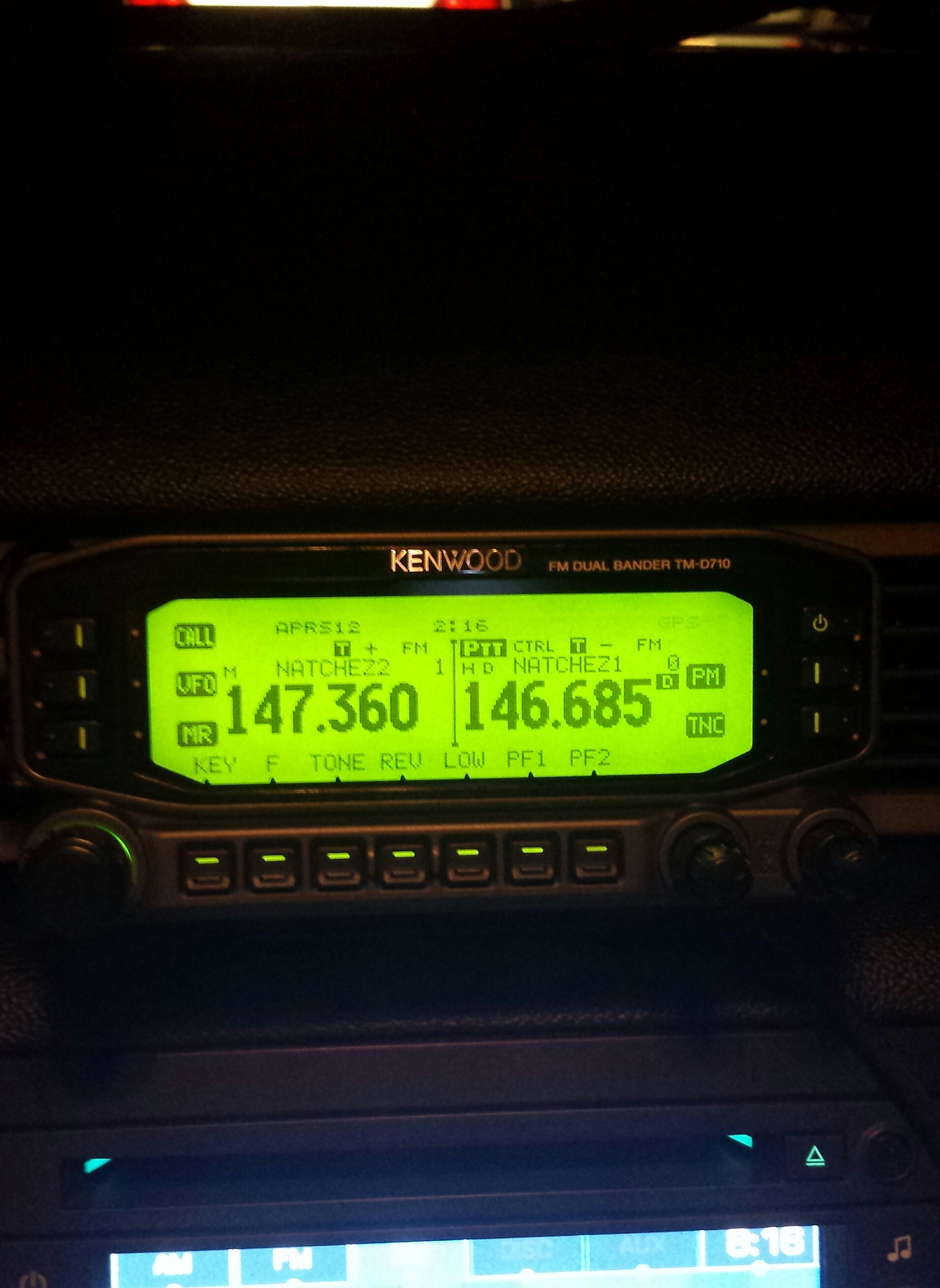

Well I forgot to post some what of a update..so far I have had the kenwood little over a week and so far I am VERY pleased with its performance and style! It matches up with my larsen 2/70B very nice! I have the green light labs double sided to the back of the face with auto trim double sided tape and the booger is on there! I am new to APRS and am kinda struggling with it since I don't have anyone in my area that I know of that can kinda give me some setup pointers! Back to the radio, I have the mic gain set on med and it seems to sound it's best to others and myself in that position....setting up this rig and programming it is really a peace of cake doing it manually if you have to. Again I'm very happy with the kenwood and the choice I made and would highly suggest it to others looking for a nice top of the line dual band rig!

Well i guess i made a fast move..it happens!! I originally was going t omount the radoi under the back seat of my 4 door chevy BUT i made a mistake when ordering the radio, i thought the mic went in on the Face of the radio..not so..goes in the body of the radio instead.. SO, i mounted it on the B piller of my truck and mounted the face in front of the Center air vents~ looks real good and worked out very nice!
