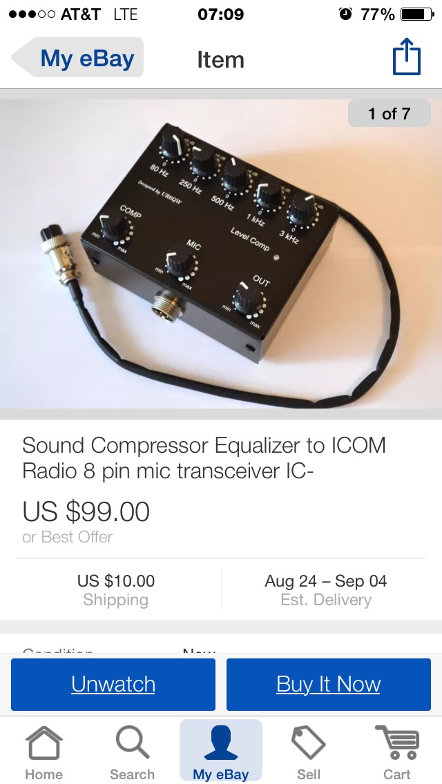

Could be the mic and not the radio. What mic is being used? My voice doesn't match up to the kenwood stock mc-43 dynamike at all. Sounds tinny and not like me so I've been told by many. I use condenser mics on all my other radios and have no issue with them. Just something about the kenwood stock mic that my voice doesn't like. And I've loaned to others, and they sound great, same mic and radio (ts140s). Just food for thought. Also on eBay there is a seller that makes an eq that is plug and play.
Kinda like the the one made by WH2Y or something. Here is what I am talking about though. Might help your audio. And also make sure you are keeping the alc level where it's supposed to be as it will change with power settings. The one I posted is for an icom but I beleive they make one for the kenwood as well. Just different mic wiring is all. Hope this might help. But I would try a different mic of you can. Might make all the difference. Good luck.
