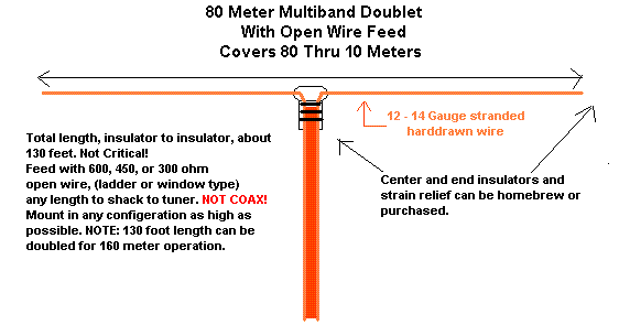

feed it with 450ohm ladder line or 600ohm true ladder line into a good balanced tuner and it will work
This is the method that works best. Forget the coax or idea that you're going to have any type of acceptable match. It will be bad enough that losses in coax are significant and is the reason for ladder line. The balanced tuner will be needed to get you to 50 ohms. They can perform fairly well for DX on 10 or 11. Better than most verticals but not as good as a small beam. Multiple wavelength antennas like this do produce some usual lobes that can have good gain to some areas at the expense of nulls in others. With respect to use for local vertical contacts, the antenna performs rather poorly here where a 1/4 wave groundplane usually beats it hands down.

That's not a long-wire antenna. That is a doublet. Note that there are long-wire antennas and then there are long wire antennas. The first has a hyphen and by definition must be as Beetle said above, at least several wavelengths long. The second is simply a long piece of wire usually of random length used as an antenna. It is also called a random wire antenna. Go figure hey?
