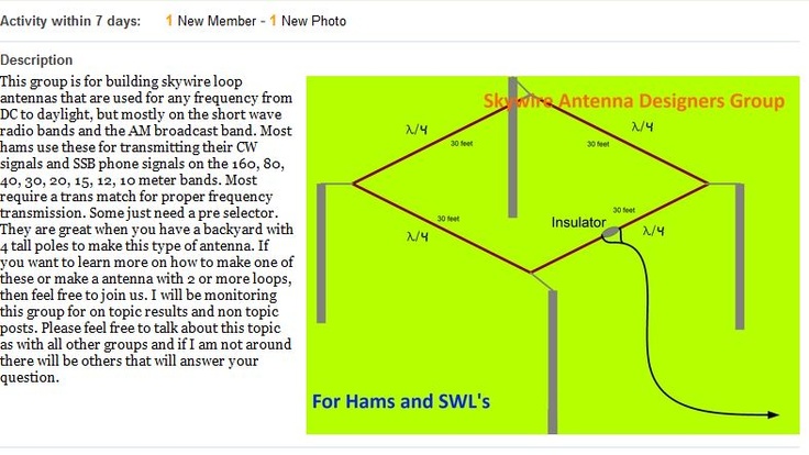

Im looking at them more or less like:
unless your "situations" really provides a good match for them....on CB it most likely is better to invest in heigth and a beam.
But under circumstances.... ( high pine trees ...slooping mountain / portable setup etc) they sure can give a big kick in "one" direction !
Kind regards, Henry
Edit : The skywire antenna provided in the picture is a "single element cubical quad" flat... on those low frequencies it is more or less a NVIS antenna (not good for DX). if we take that antenna and construct it for 11 meters, it has nothing to do with "a long wire"... it it is rather small, just a full wave piece of wire And it would be more bennificial if it was straigth up at a decent heigth and fed at the bottum.
