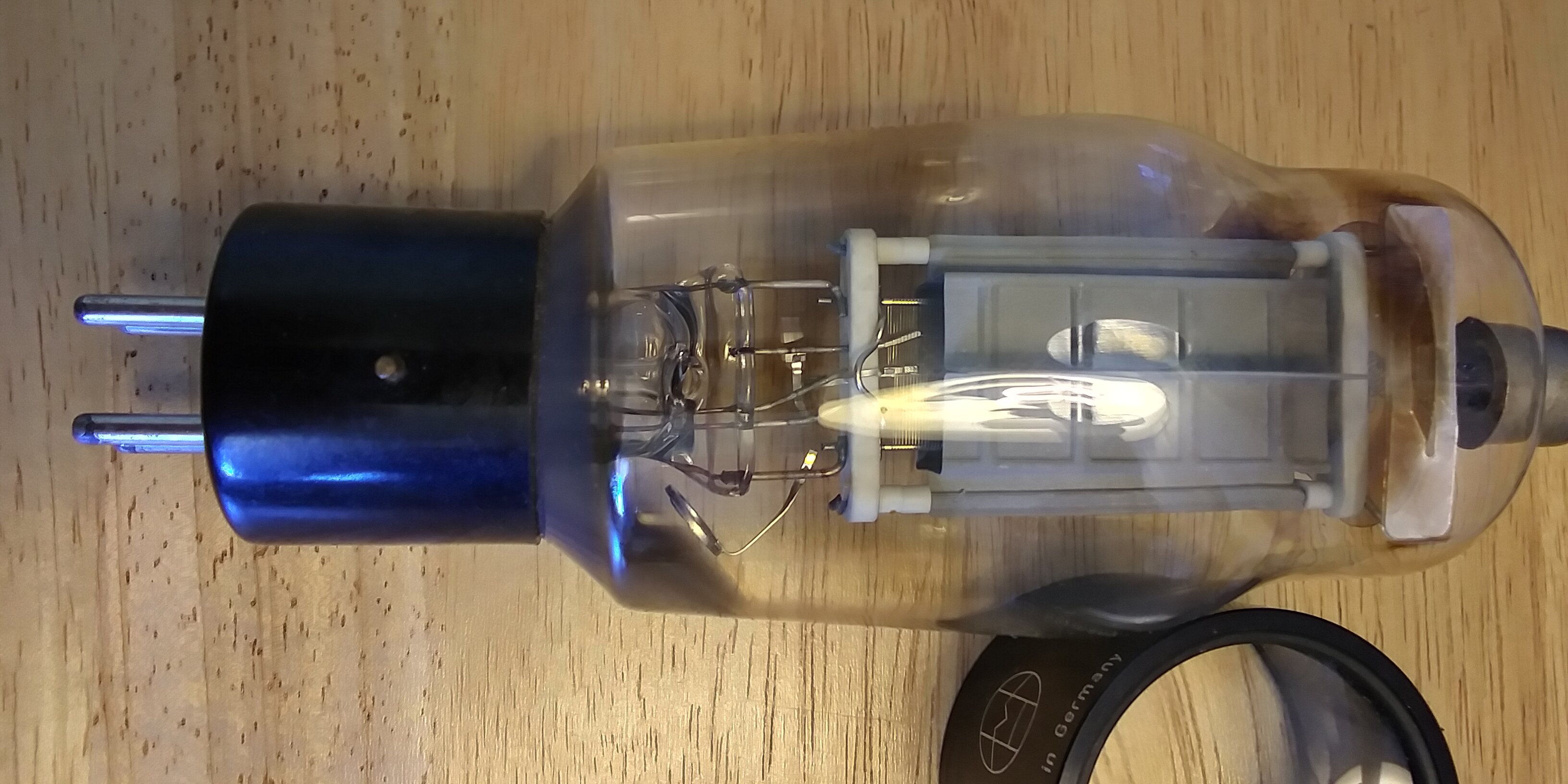

The 811A? To quote a favorite expert, "1-800 Toll-Free" it has all the linearity of a half-wave rectifier.
Up to around 100 or 120 Watts peak per tube is okay, but this is not a good tube for AM. Unless you're willing to throttle back that far. The 811A is a tube that will happily deliver enough RF power to burn a nice, round hole in its thin sheet-metal anode.
The 811 was built to be the cheapest HF amp as the number one priority.
And that's from the man that designed it.
As for AM mode with the 811
May this image be forever burned into your memory.

If you run AM, run away from today's 811A's. It's not just that they melt when trying to produce the highly inefficient carrier, the melting causes them to short out. This almost always causes amplifier damage and in some cases can back up into the receiver, severely damaging it.
They haven't made a real 811A tube in 40 years. Just pull up a Google image of an old RCA 811A tube and right away you'll notice all manufacturers have deleted 12 horizontal radiator fins, in favor of two vertical ones.
The original 12 fins not only provided much better mechanical stability, they also removed heat from the critical center area of the anodes. For reliable AM or FM operation, 811A tubes must be switched out with 572B's.
The only reason the six pieces of metal were removed, that were bent to make the 12 fins, is because that required two extra steps. The fins had to be made on another machine and then spot welded to the anode. They eliminated those two steps in order to sell you a supremely junkie tube.
On the other hand, the anode inside the 572B tube is approximately five times thicker and made of graphite material which will not melt. Having the same pin out and inter electrode capacitance, makes it a direct drop-in replacement for the 811A.
