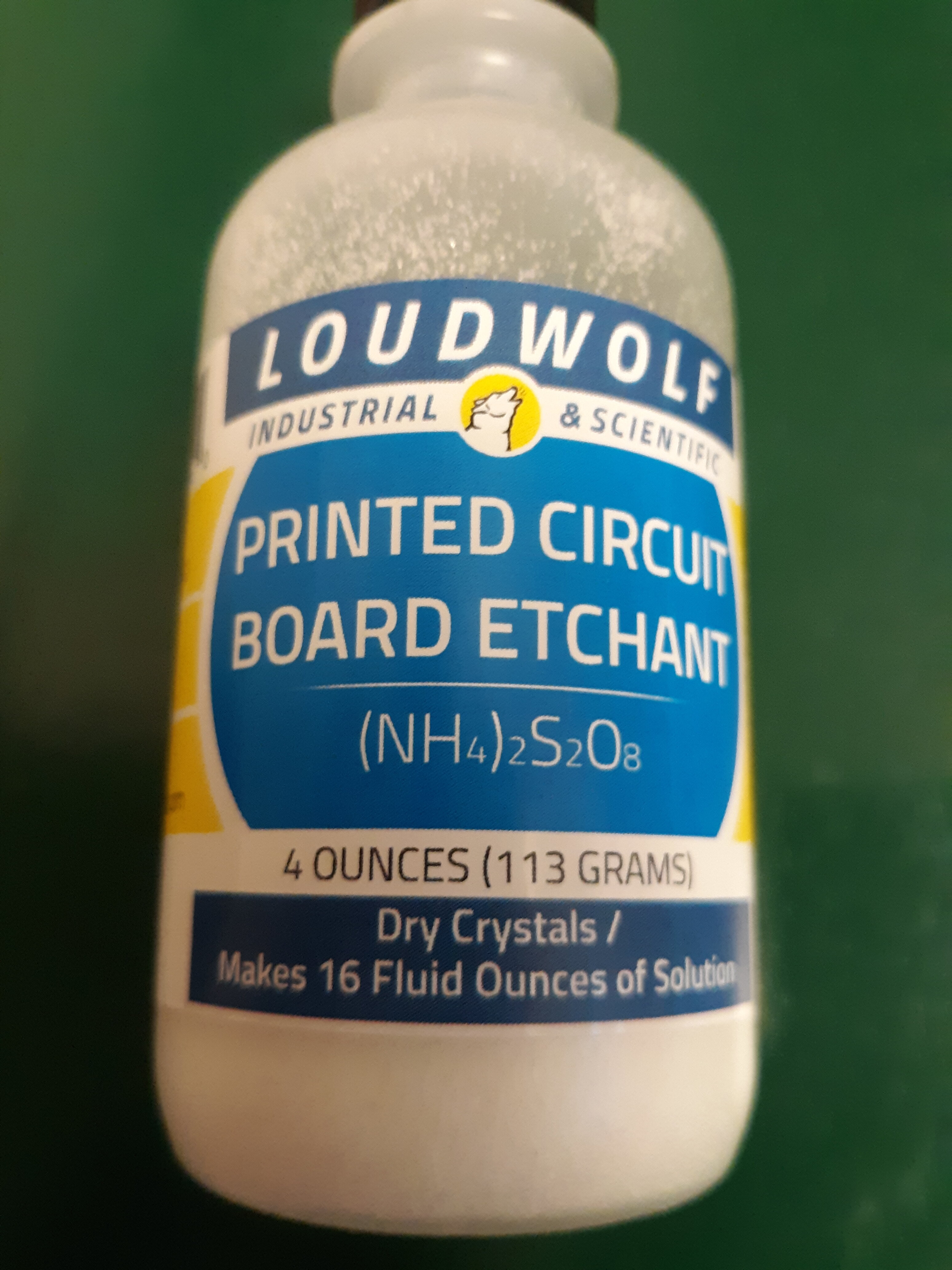

So my second attempt at using Loud Wolf printed circuit board etch and it does nothing. Pure junk. I also found others have had the same result.
This is going in the trash.

What kind of water are you making the solution with?,
its best to use distilled water for etching solution so contaminants don't react with the persulfate & reduce its concentration,
also scrub the pcb with Scotch-Brite or similar abrasive pad to remove any oxidation grease & fingerprints.
Reactions: freecell
I did not use distilled water. The first time I scrubbed the board. And cleaned it with isopropyl alcohol. This time I admit I did forget to scotch bright the board. After 1 hour nothing happened. I made the solution a bit stronger and after another hour and a half nothing. I really think I need to buy ferric chloride.
If loudwolf sell it as pcb etching solution & you mix it at the right concentration it should work, something must be stopping it working for some people,
It could be your water that's no good especially if its got iron in it,
I use Ferric Chloride in distilled water & it never fails to work,
Ammonium persulfate does work on clean copper when its mixed in distilled water,
in tap water the results will vary depending on what else is in the water,
good luck..

I wrote loud wolf. My answer was scuff board with 220 grit. Clean with isopropyl then try it. They say that they have been selling this for 40+ years and who ever wrote me back uses it also with no problem. And said adding more Crystal's will make things worse. I have a bottle of ferric chloride on the way. Also hot water up to 95 degrees helps.
