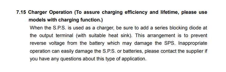

Are you using it to charge a typical 12V battery
From the PDF...
Some SPS contain a variable output trim feature, you might want to investigate that so you can provide the proper voltage rise to overcome the resistance and drop across the cells of the battery.
