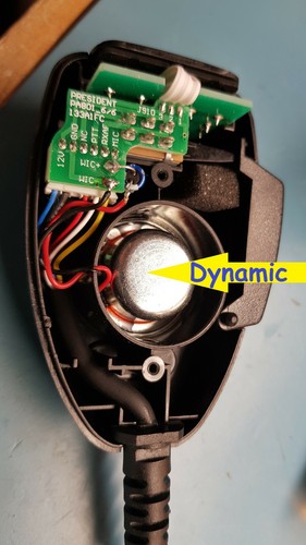

I will check again. The stock mic that comes with the radio is an electret type microphone(voltage is present on the audio pin). So if you use a non-electret type or a power microphone you need to turn off this voltage. if not; you could damage the mic and or radio.
I never had a problem running a power mic with mine. I know several other who run a power mic with this radio.
