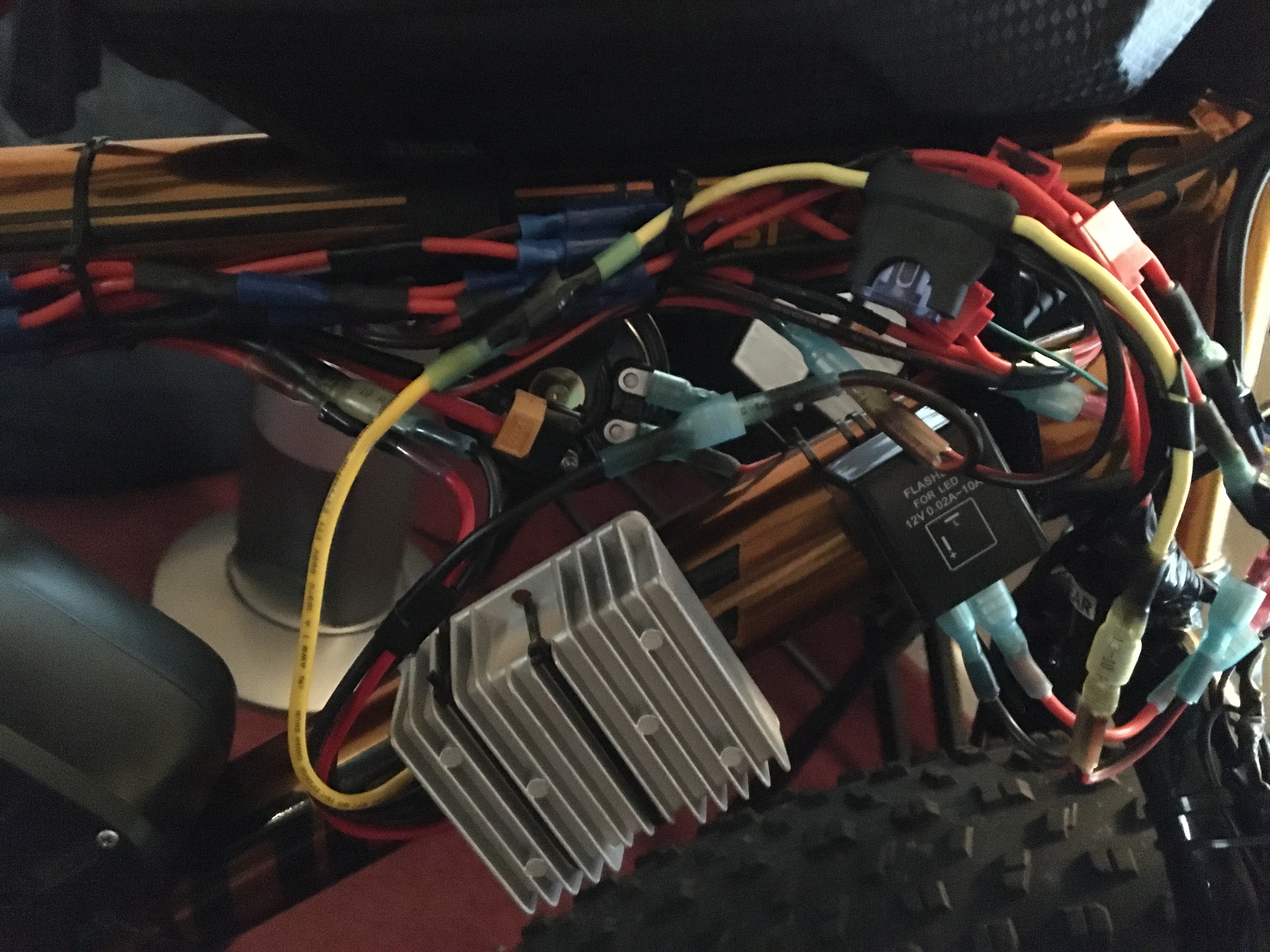

Opted to order a 48v-12v converter for the headlight, proper scooter horn, and a set of 12v LED tail/marker lights. I also ordered a motorcycle style switch as well for these.

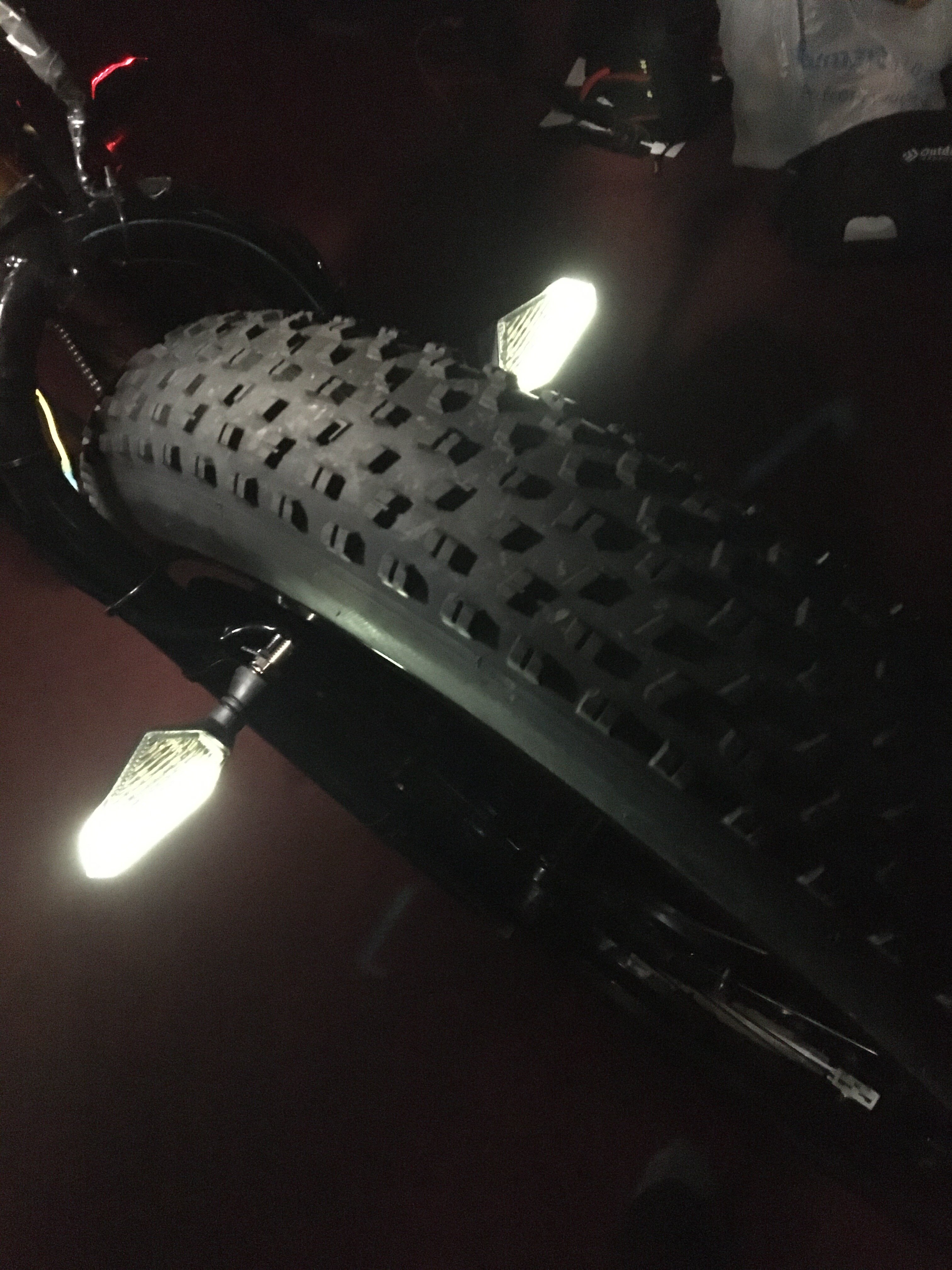

I ordered in 2 motorcycle turn signals already for the rear forks and have 2 more coming for the front.

So I put the 48/12 on. Says like .01 amp no load draw.

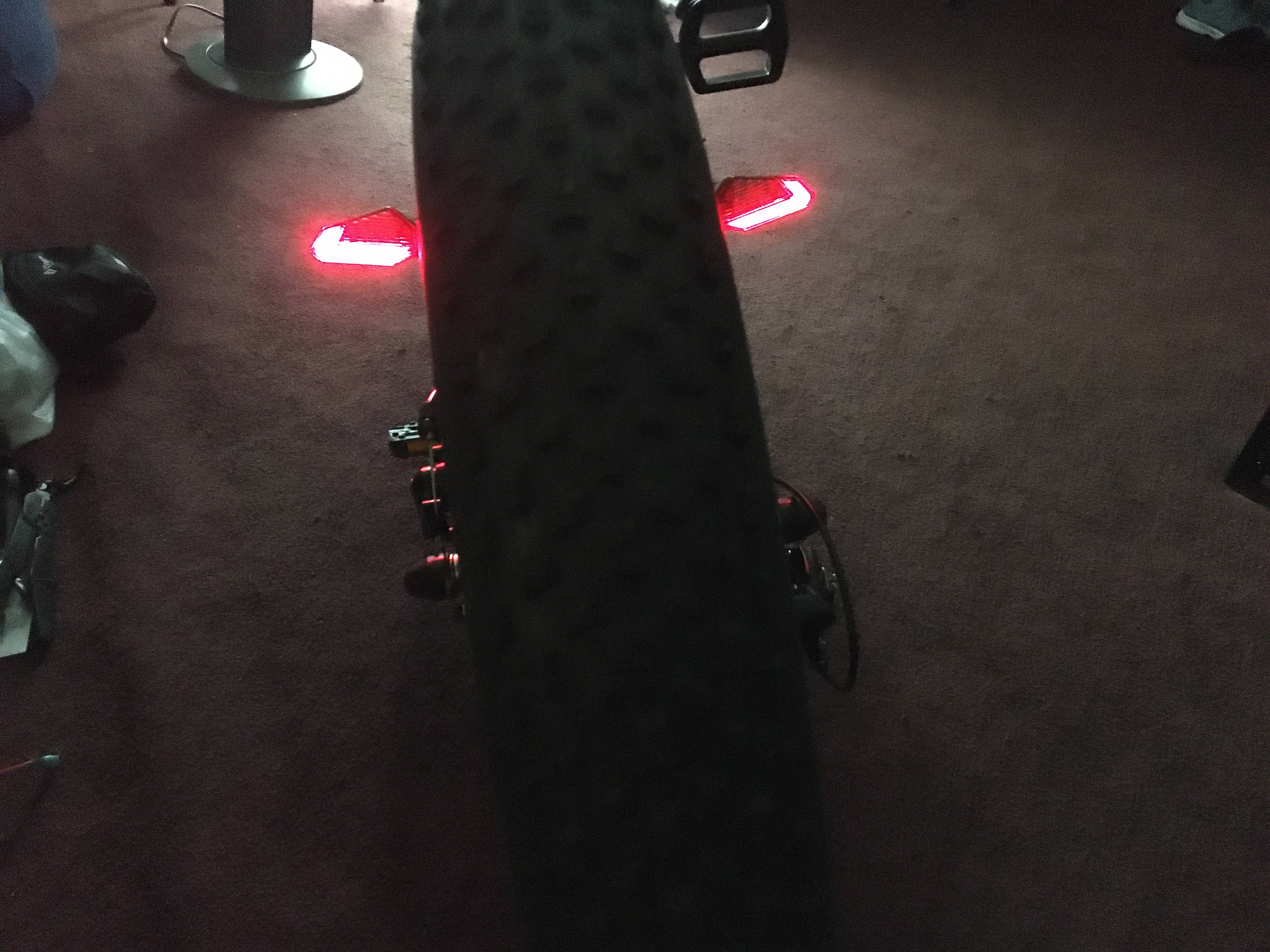

Also did front white marker with amber signals and the better 12v scooter horn. Rear is red marker with amber signals. Simple led flasher.
Still need to fix the spaghetti.

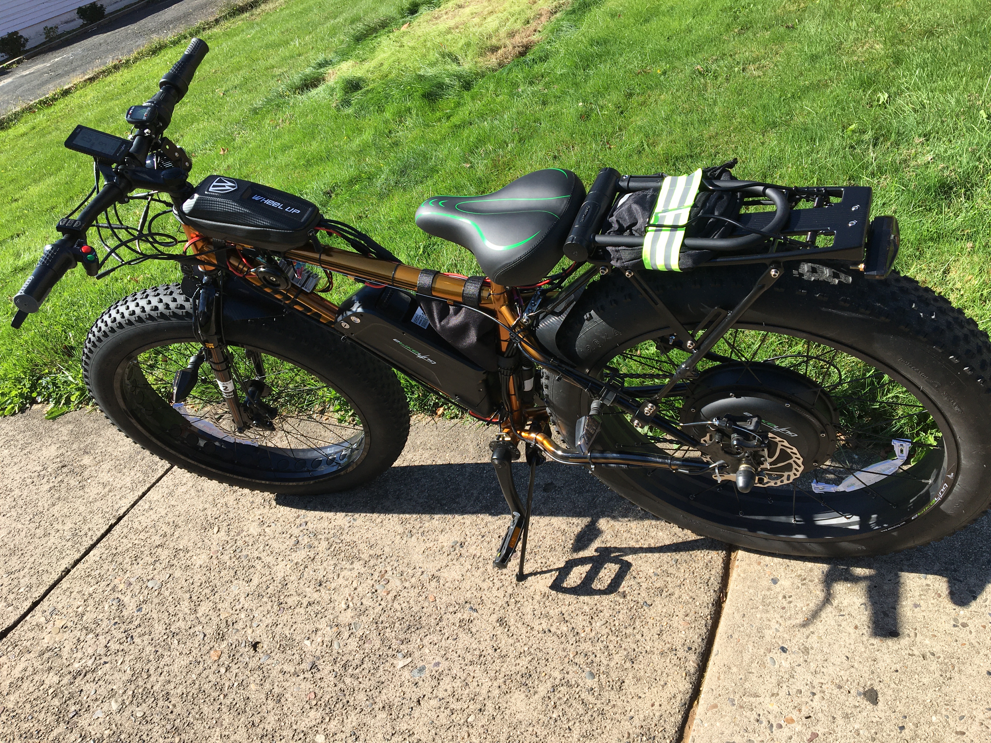

I've learned by putting 110 miles on it to and from work a few things.
I need to move the rear side lights back as my heel catches them once and awhile.
Check for anything lose weekly.
The ride is cool at night when it's less than 50' F and you don't own gloves. (n)
Doing 15-20mph avg will get me to work and back with about 50% battery left on avg. I do one section of road at full 25-28 to keep ahead of the flow thru a 30mph zone because it has no shoulder at all and people don't know how to drive near a bike.

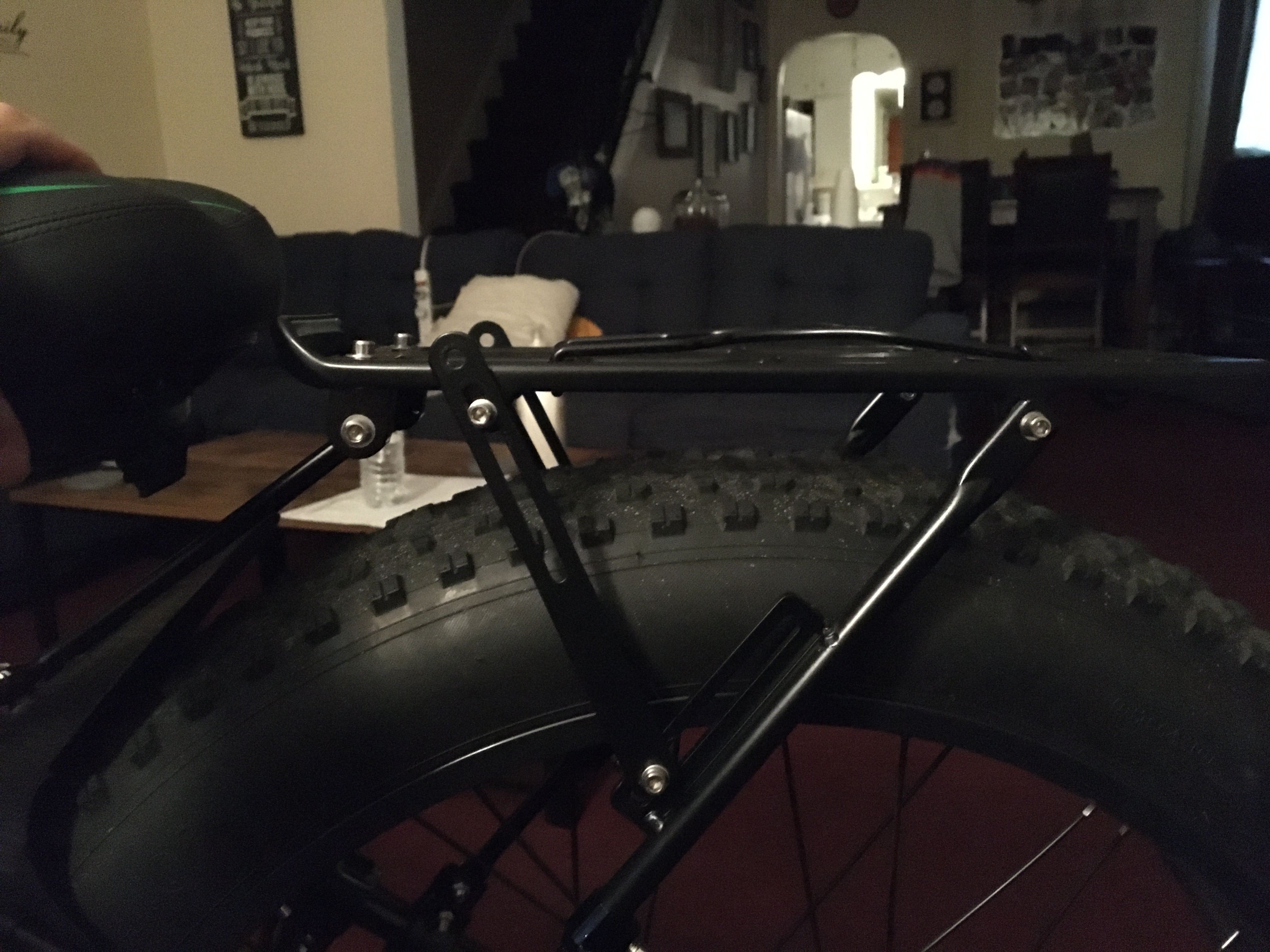

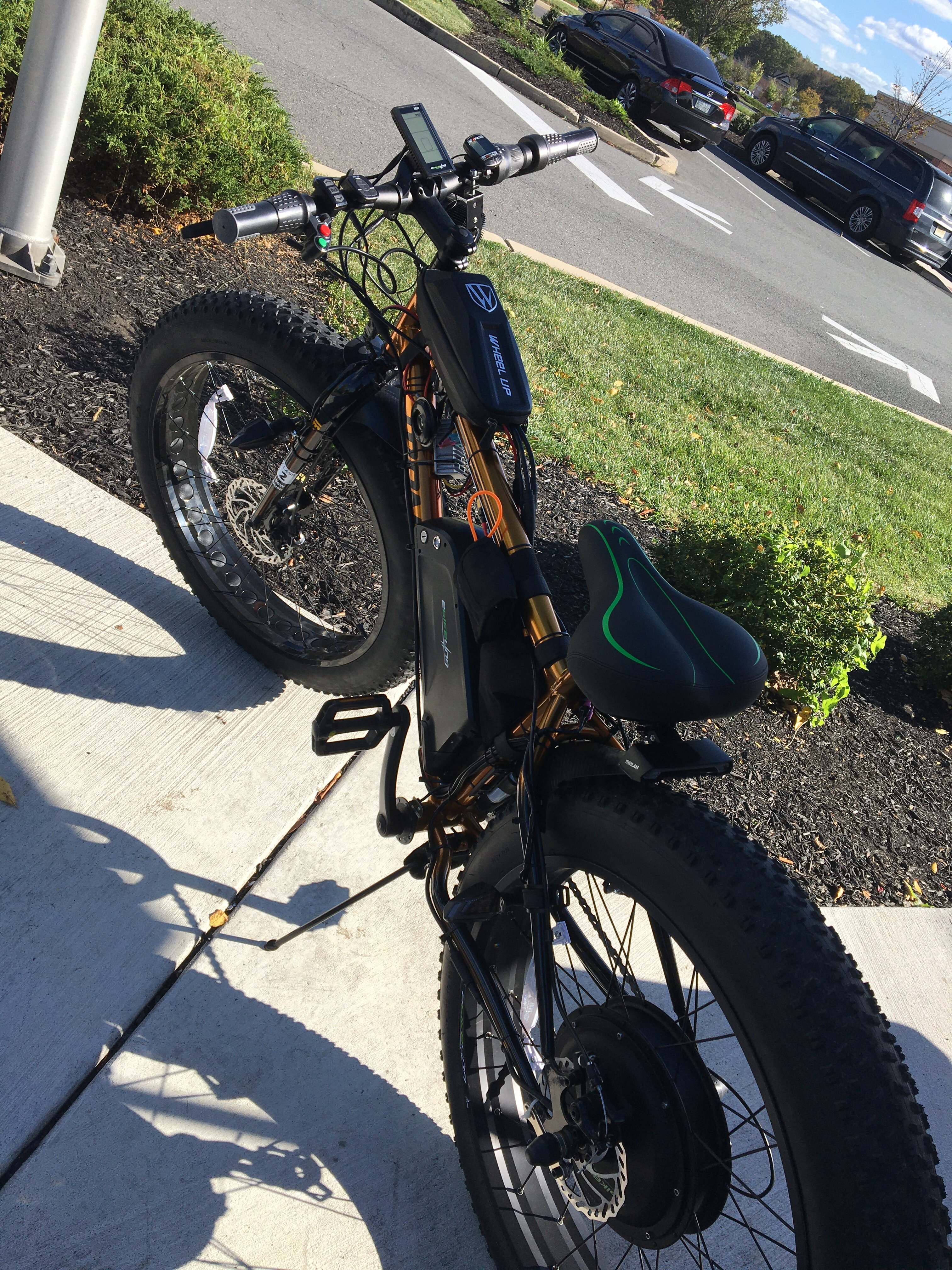

The new gel seat is way better than the BMX factory seat for long rides. (Pic was pre rack install last week at work lunch)

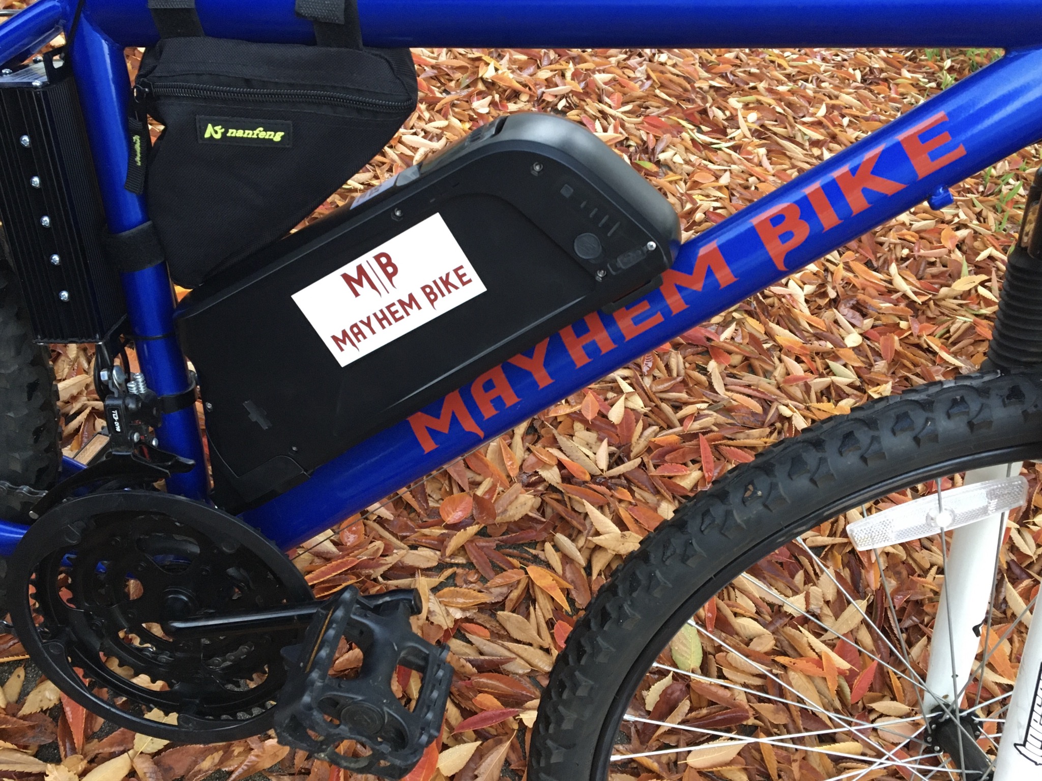

Next build for the new business I'm trying to do. Kiss budget build ($45 used bike) as the advo piece.

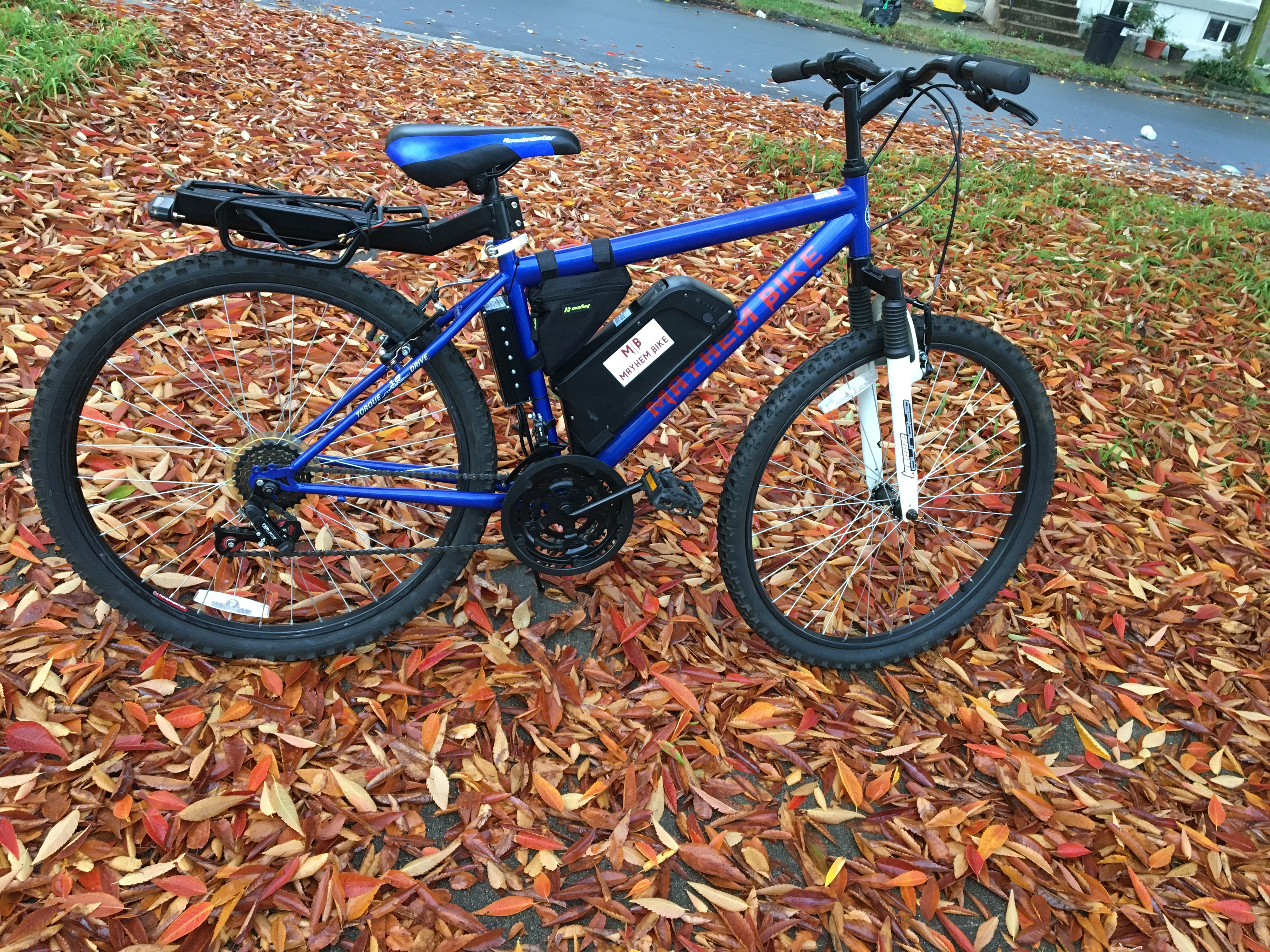

Same 1200w/48v kit (not fat tire, just 26"). Mock up today. Waiting on the motor to get here.
