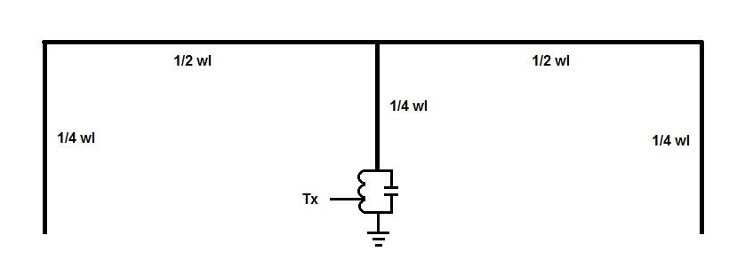

The first thing I thought of when I saw the half square antenna design is bobtail curtain, which, offhand, I think would likely get you a little more gain.
After playing with the half square, if you have the room, you might try one of these as well.
The DB
