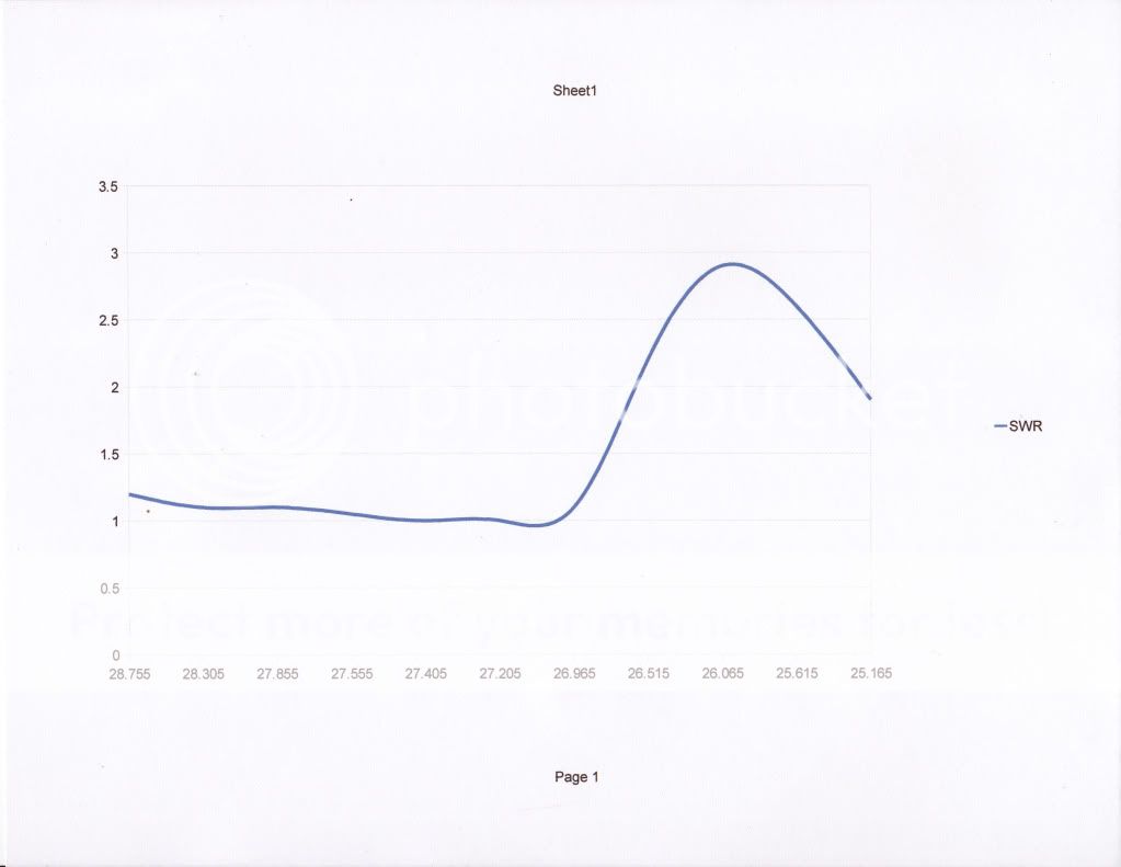

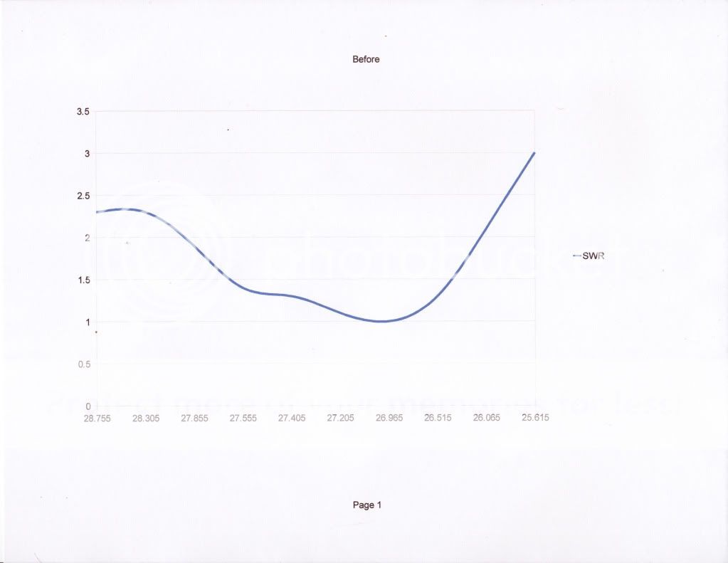

BTW, in your BW curve with the 5/8 wave above the beam, are you able to note for us the full <2.0:1 SWR bandwidth in frequency? You tell us it is wider than the antenna when it was several feet above the roof, which I can easily understand, but your numbers don't jive in the high range and they stop at 1.3:1. If that is as far up as you can go, then how do you know for sure? I've seen curves that reach a certain point and almost shoot straight up from there on.
@ Tony: Thanks. The shaft on the bottom of the 5/8 is not metal. It is fiberglass, so there is no mechanical connection between the two antennas. I was speculating on the potential electrical/Rf bonding of the two. And I am not taking anything Marconi is saying to be negative. I solicited any/all input and he is generous enough to to give it the "Old Grandpa" treatment.
Thanks for joining the discussion.
@ Marconi: About the bandwidth; you are correct, I have taken the checking as far as I can with my DX88HL. I suppose I should have referred to the change in the SWR readings as apparently flatter across the tested range for greater clarity. I assumed the <2.0:1 was wider because it fell within my testable range before, and now I have not reached it because it is outside my testable range. Wrong thing to do. Even had I said apparently flatter across the tested range it would have been wrong. What is apparent is that was another case of someone seeing what they wanted to see. OOPS.
Before
28.755 ---------- 2.3:1
28.305 ---------- 2.3:1
27.855 ---------- 1.9:1
27.555 ---------- 1.4:1
27.405 ---------- 1.3:1
27.205 ---------- 1.1:1
26.965 ---------- 1.0:1
26.515 ---------- 1.3:1
26.065 ---------- 2.1:1
25.615 ---------- 3+
After
28.755 ---------- 1.2:1
28.305 ---------- 1.1:1
27.855 ---------- 1.1:1
27.555 ---------- 1.05:1
27.405 ---------- 1.0:1
27.205 ---------- 1.0:1
26.965 ---------- 1.1:1
26.515 ---------- 2.2:1
26.065 ---------- 2.9:1
25.615 ---------- 2.6:1
25.165 ---------- 1.9:1
