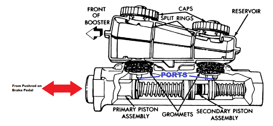

These signs lean me back in the direction of the Master cylinder where the Brake Fluid reservoir resides. Loss of brake action occurs when you have lost containment of the system, or the pressure seals in the system are not working
You seem to get brake pressure, but nearly to the floor - so you may have air in the system - or low fluid - so pull that cap and check, fill as necessary, and then look around for your brother, or family member so they can sit in the Drivers seat and press the brake pedal for you so you can bleed the brakes.
That is only if you crack open the bleeder valves and can't see if fluid burps out.
Then you may have another type of braking problem - dealing with the pushrod that the brakepedal has, is not retracting fully,
This fail to retract problem makes for a pedal that goes to the floor if only to apply some pressure - because the port used to refill that upper chamber that is where the piston pushes against - is not able to open and refill the upper hydraulic side of the Master cylinder.
More than likely it is in the front calipers that these air pockets have formed.
But to get at them, you'll need to make sure your booster is fully hooked up to the vacuum from the Intake Manifold. Vacuum leaks are not fun. The Booster helps to pull the pushrod back out so the cylinder can then fully release into the "at rest" position and open the ports in the system. See if the pushrod will then retract and fluid will get into the brakelines. See if you have a broken hose, start digging.
Because if fluid does not come out when you crack open the bleeder valve - this system is a ":gravity feed" where once ports are open, fluid is pulled thru by it's own weight and pressure from above in the tank for that side of the system. If a line is leaking you'd see fluid below where it was parked.
You don't have that condition, what you have a pedal that nearly has to go to the floor to get the pistons to move enough fluid to apply the pads and shoes. That tells me either you're out of fluid - or you have plugged lines - you wouldn't have brakes if that was the case - or your Master cylinder is out of alignment to the booster it bolts to, affecting the pushrod clearance - and to remove those possibilities, check to make sure you have vacuum in the system to pull the booster back into a resting state to help that push rod do the same - so they both can let fluid enter in so you can re apply the brakes as you need to to get pressure to build. To check for that you'll need to know if the bleeder valves are open and letting fluid escape to prove the ports are aligned.

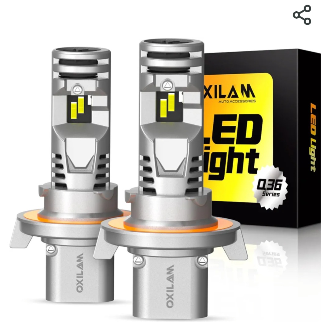

Got the master cylinder replaced so the brakes are now working. Ordered some goodies, will be putting them on when I get home still waiting on the headlights to arrive may be awhile. View attachment 67160View attachment 67161View attachment 67159View attachment 67162View attachment 67163

Will do. These are supposedly plug and play, so hopefully I don't have any issues. According to reviews others with the same truck as mine had no issues. But usually I'm not that lucky.

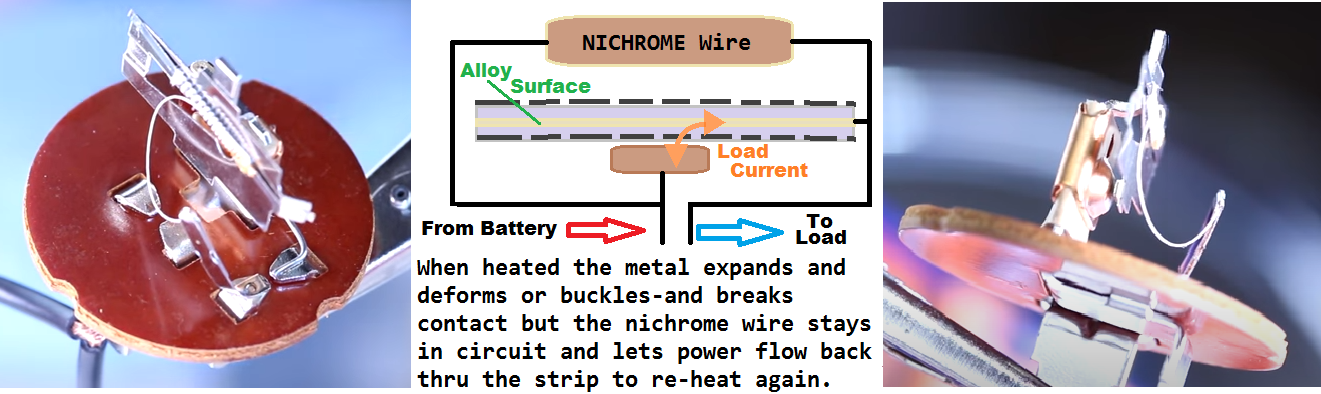

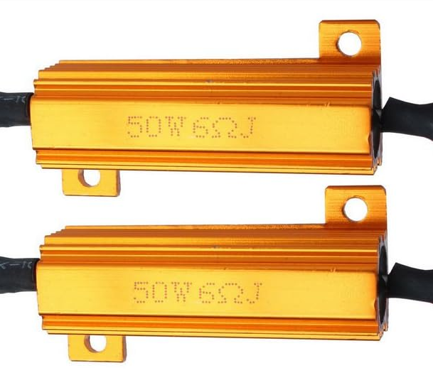

What many experience when they switch from older "bulb" headlamps and Turn Signal - even rear Brake lights, are the "Rapid flash" - which is caused by the LACK of current the new updated bulbs consume. So the thing thinks the circuits are "open" (LED + Dropping resistor / Power module) - it's a high-impedance low-power consumption device, so it puts it in rapid flash - this sucks when you use the older "thermal flasher" units found in older trucks and even newer ones. They used these as redundant backup on 4-way flasher so the units needed a load to "heat up" the internal bi-metallic strip to deform - pop off the internal contact - then cool and recoiled back to original shape - then repeat.
They tried phasing these out as time progressed - however due to redundant needs and DOT considerations for "Backwards compatibility" use, they still used them - up to about 2004 when the newer LED Modules and integrated headlamp units came out after their testing for durability finally got them DOT approved - whatever that means these days.
The solution in many of them is to place an 6~12Ω - 20~50W Wire wound resistor - or simply more of a 1W wire wound embedded - epoxied in, a package that can dissipate the heat the resistor generates without burning up - ACROSS the wires that went to that lamp - being replaced by the LED.
The problems with this is the filament - it needed an inrush current to light that lamp - acted like a near dead short, using a lot of current until the filament heated up and the lamp looked like a higher-impedance load.
Thats how those thermal flashers worked, and they took on the load the lamps produced with ease - they parallel a wire of known resistance in a strip and combined with with a bi-metallic strip made up with the bends - so as the Nichrome wire passed current - it also passed thru the strip - heating both up, then the circuit opened for a moment and the Nichrome wire took the brunt of the high-impedance heated filament until the impedance changed back to low-resistance high-current demand - the lamp went dark until the dead short the lamps looked like, heated that bi-metallic and Nichrome together at the same time pulled the strip to short that contact out again and pass the power onto the load.
LED's need power yes, but in mA not A - so they can't pull enough current thru the flasher to make it work.
So the Carmakers are doing a workaround using Power modules with built in -timers that take care of the flash problem - but the cost is now you're stuck with the LED compatibility with low-current or power demands versus just using a simple filament bulb with that quirk of having a high-demand instant that when taken care of - works well and doesn't draw a lot of power - similar to LED power consumption.

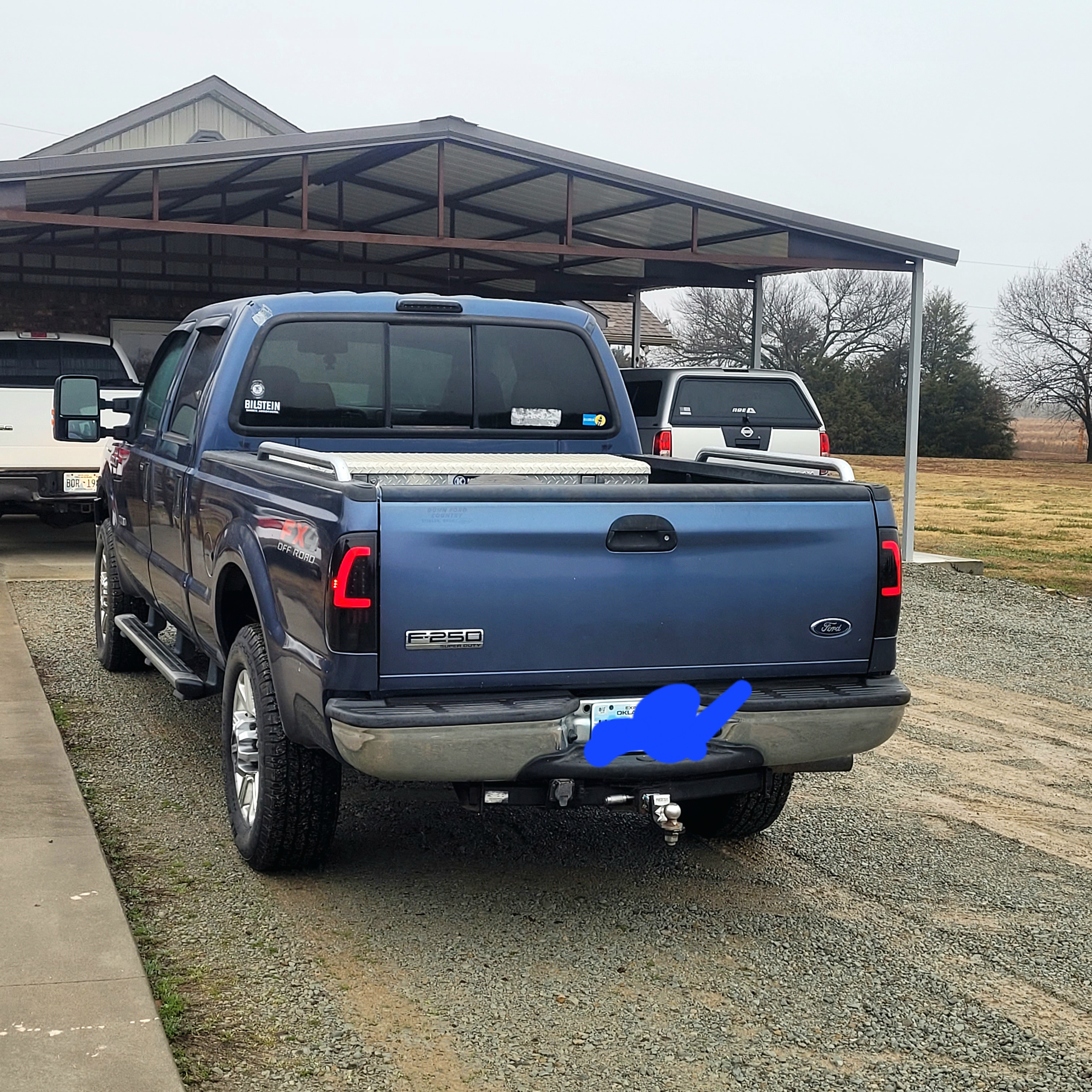

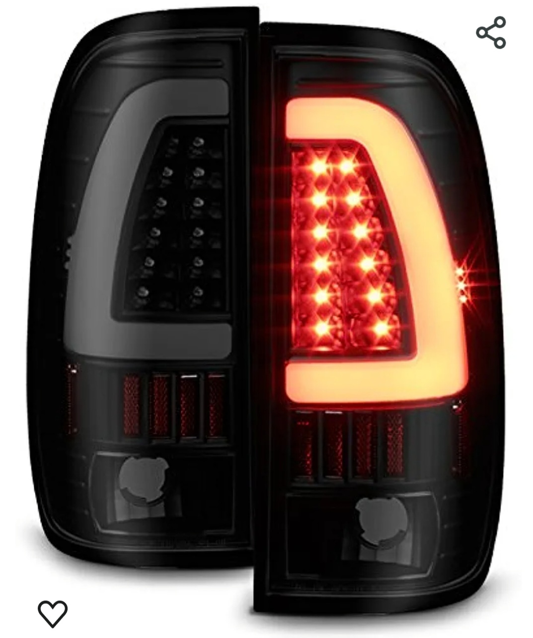

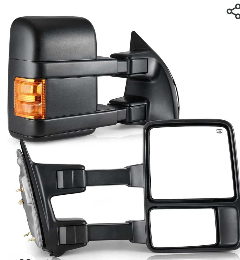

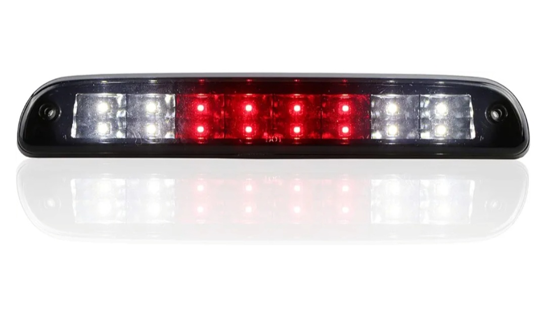

got the tail lights, break lights, 3rd break light and new mirrors on yesterday. So far everything has been plug and play with no issues. My headlights are still a week out so those will get installed after I get home next time.20240124_150655.jpg20240124_150805.jpg20240122_170126.jpg20240124_150841.jpg20240123_102346.jpg
