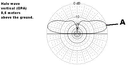

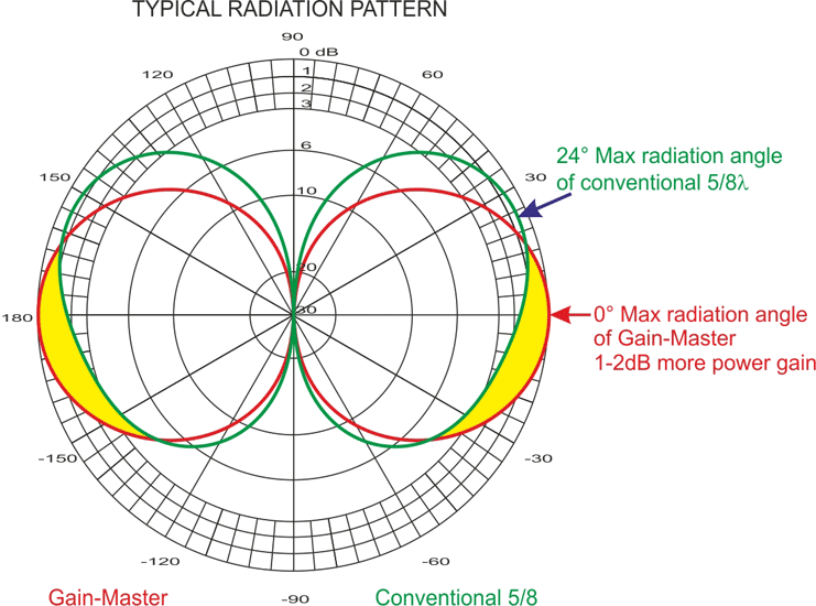

I am finding it impossible to know if the Gain Master is really better than a conventional 5/8 wave and I appreciate that TOA is not the only factor relative to a good antenna. Size/shape/CMC in feeder issues/mounting options/height options and sensitivities to static and noise susceptibility all come into it. (all relative to the specific location and ground quality conditions)
I appreciate the GM is a 5/8 dipole equiv as opposed a 1/2 wave and most plots that are provided are for the 1/2 wave standard dipole. I wonder if Sirio are stretching the truth... in their diagrams they show radiation angle of 0 degree for the GM (I think that is free space ?), their diagram just says "Typical radiation pattern" (does not exist in reality, what is typical, typical should mean over earth surely... typical cannot be in non existent free space) Comparatively they show a "conventional 5/8" as having a elevation angle of 24 degrees. That does not appear to the the case either as we know from diagrams here:
Taken from:
http://www.dx-antennas.com/5-8 wave vertical.htm
That 0.5M above earth it has most gain at 16 degrees TOA. That is an 8 degree discrepancy for starters.
As does the humble 1/2 wave, 16 degrees TOA:
Taken from here:
http://www.dx-antennas.com/Half wave vertical.htm
A 1/2 wave dipole above ground at various heights looks rather different than the plot on Sirio's literature...(also would a 0 degree take off not just get absorbed by ground, hills, mountains, buildings, terrain therefore attenuating the signal en route to the atmospheric layers we are interested in ?)
The caveat being... I suspect in reality above actual earth/ground a 0 degree take off is pure fantasy land.

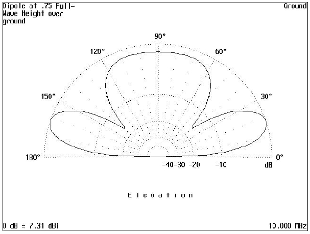

Vs.. at 0.75 wave length of ground. (looking a lot more like 18-20 degrees on this plot, with a nice cloud warming plume on top)
Image taken from here:
http://www.hamuniverse.com/wb4yjtdipolepatterns.html
I am doing my best to make sense of this but am having difficulty. Maybe the widely reported 1 S point improvement should just be accepted as a oft reported signal improvement in the vast majority of user set ups. i.e. set ups that do not have proper size ground radials that the 5/8 design requires to provide some TOA gain over a 1/2 wave monopole. i.e. relative to 5/8 waves that do not have full length 1/4 wavelength radials.
Taken from:
Taken from here:
