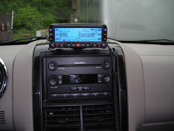

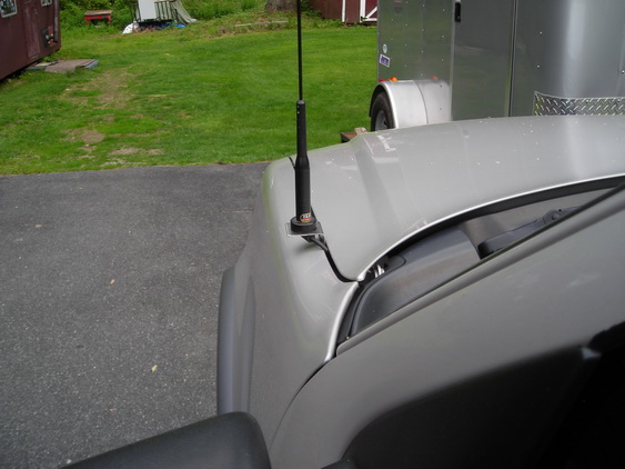

The Radio is now installed Mobile, havent really gone anywhere yet. My Mobile Dual band antenna hasnt come in and I picked up a used Comet SSB25 so thats on there for now so at least I can use 2 meter. I am thinking about going smaller on the antenna, maybe 1/4 wave dual band. :whistle:

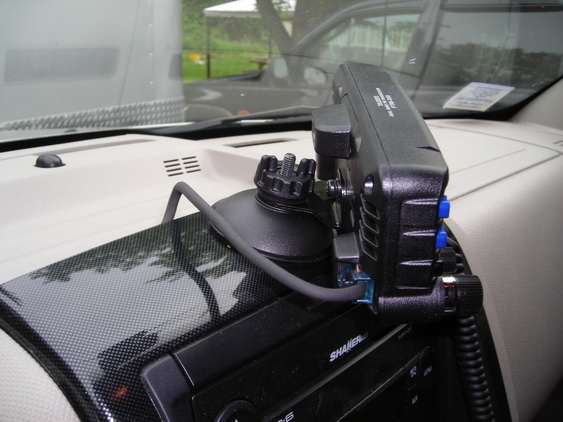

Ok here are my install Photo's. The suction cup is on a curved smooth surface and is holding solid as a rock.
The Display is awesome and since you can use a straight through RJ45 cable I set the system up for easy removal.
Anyway the Comet SSB25 antenna is a bit large for where its mounted so I might go with a 1/4 wave dual band and see how that does.
So Far LOVIN the Radio !!

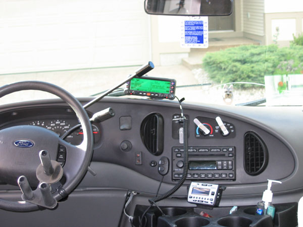

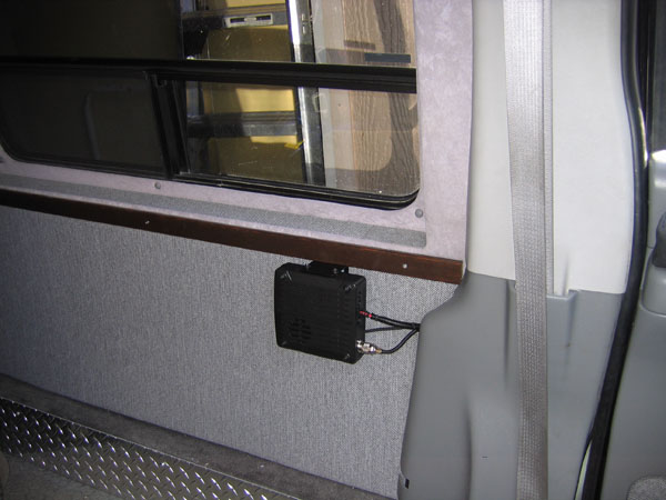

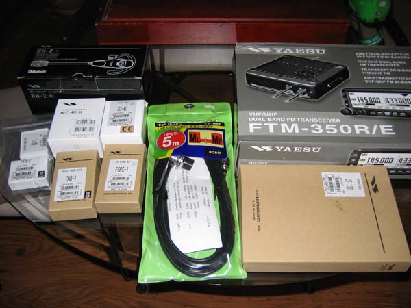

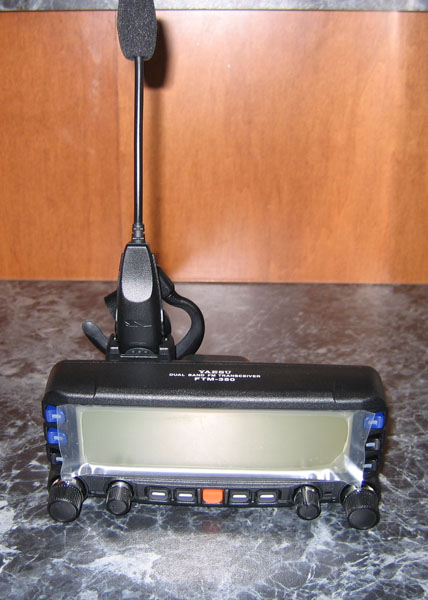

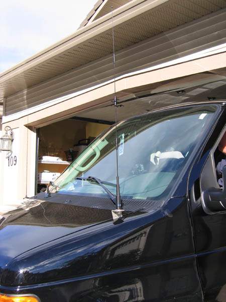

Well Sunday came and went and I now have a newly installed FTM-350. I'm sooo happy! Here are some pictures of all the new goodies, the head unit with the Bluetooth attached, the head mounted on the dash (notice the tilt :laugh: have to come up with a better dash mount, I don't like it that way but it works for now), my antenna and the chassis mounted just behind the driver. Now that's a mouth full. I drive from my wheelchair so this works excillent. Enjoy.
73 Darryl VA7DTP
