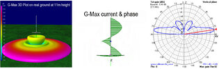

Best I could do is try and model the G-Max collinear and see if it produces a similar far field image like the G-Max... which I think I've also seen in some video that shows 6 <> dbi gain at a very low angle at or less than 8* degrees.

Here is another modeling image that shows the performance I hope to see in a G-Max model soon. I did this model sometime back but without success.
It sure pancakes the signal down low on the horizon.
Without success as it would not match or?

Jeff don't worry about the dimensions; I have the model working close, I think.
The pattern and the match is off a little, but the gain is 6.40 dbi at 7* degrees and 1.21:1 SWR @ 27.205 MHz over Average Ground.
I think a little more tuning will fix it. However, I'm concerned the gain may be inflated...due to errors so far, and the gain could suffer when the model is fixed better.
Even if the gain drops a little, that big lobe at 7 degrees is impressive.
