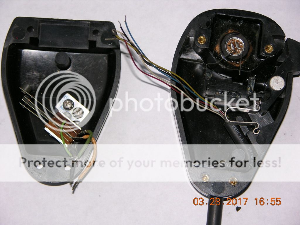

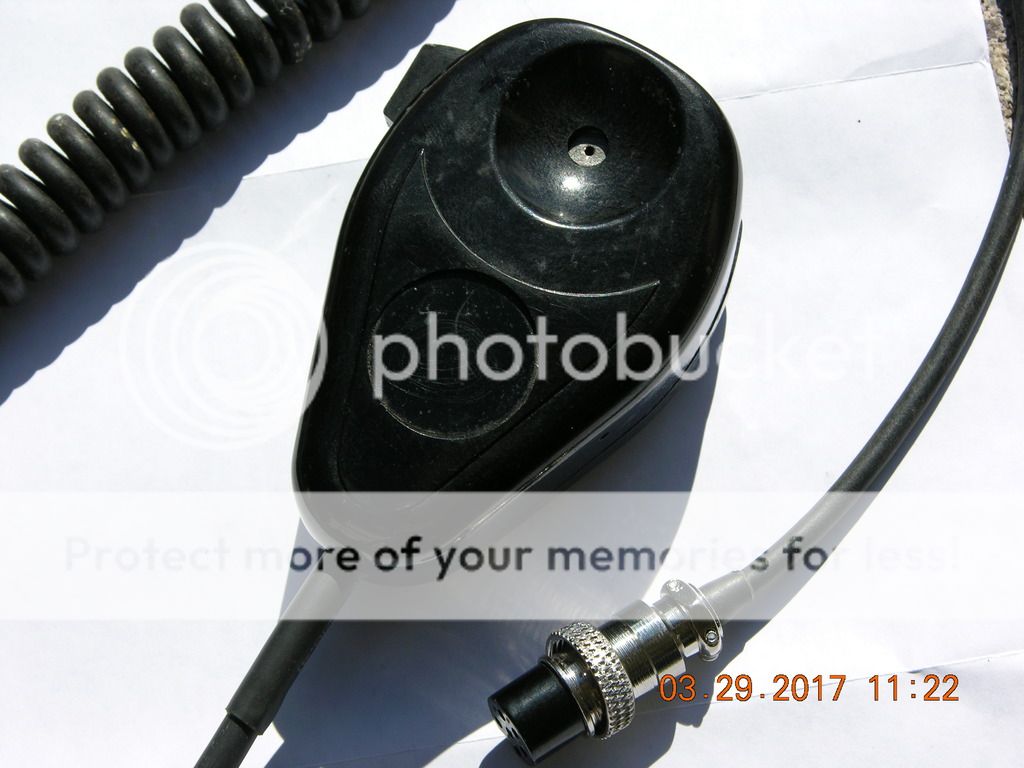

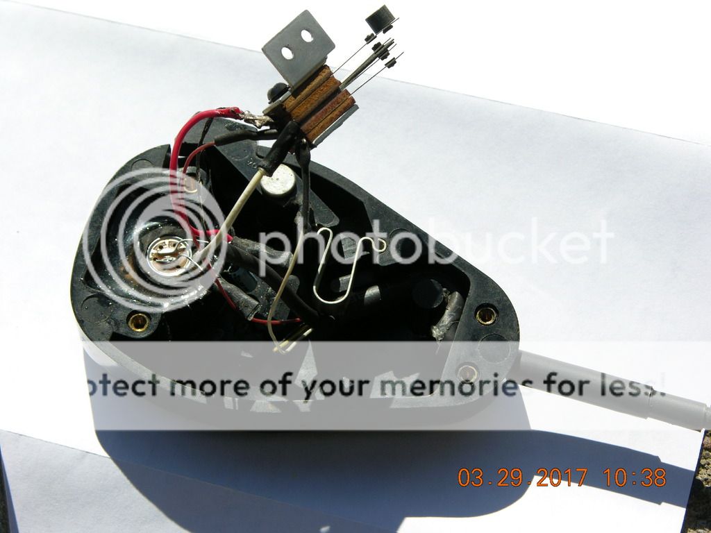

You could always build your own for a fraction of the price.
It's a great sounding microphone built with cheap Chinese parts designed to physically resemble a Shure 577b.
Here is one I put together with an electret that had the same specs as the Palomar SL41.
For the electret just get
Mouser Part #: 665-ANM-5254L-R and you're halfway there.
50hz-16000hz. Awesome response and noise cancelling as well, assuming it is put into a case with a rear sound entry port like this one.

Won't get the noise-cancelling feature mounted that way.
The tiny hole in the rear of the capsule is for ambient noises to enter the rear of the electret capsule. To make it a noise-canceller, the capsule would need to be just under the screen, out in front of the housing with the rear of the capsule exposed to surrounding noises.
Probably works okay the way you see it, but that's how a noise-cancelling element works. Sound that's louder in front than it is in the rear of the element gets heard. Sound coming from a distance is equally loud in the front and rear. Cancels it out.

that's precisely why I used the Electro Voice 603t housing for mine.
There is an opening on the back of the case directly over the electret which allows the background noise to enter the back of the electret to cancel itself out. It would be nice if somebody would mass-produce something similar.
