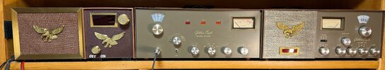

Old SBE Console II 23 channel, freq. expansion
It helps to be an Old Man when working on these Old Radios! But I need to find spare parts I think my crystals are starting to fail. Anyway you might find it interesting that My Gonset G-11 made back in the late 50's "The one I found on the city dump at age 12" was the forefather of the SBE's you could say they share DNA as Mr. Faust started SBE but I believe Raytheon owned SBE when the CII's were made. Good luck these are some good ole radios.
