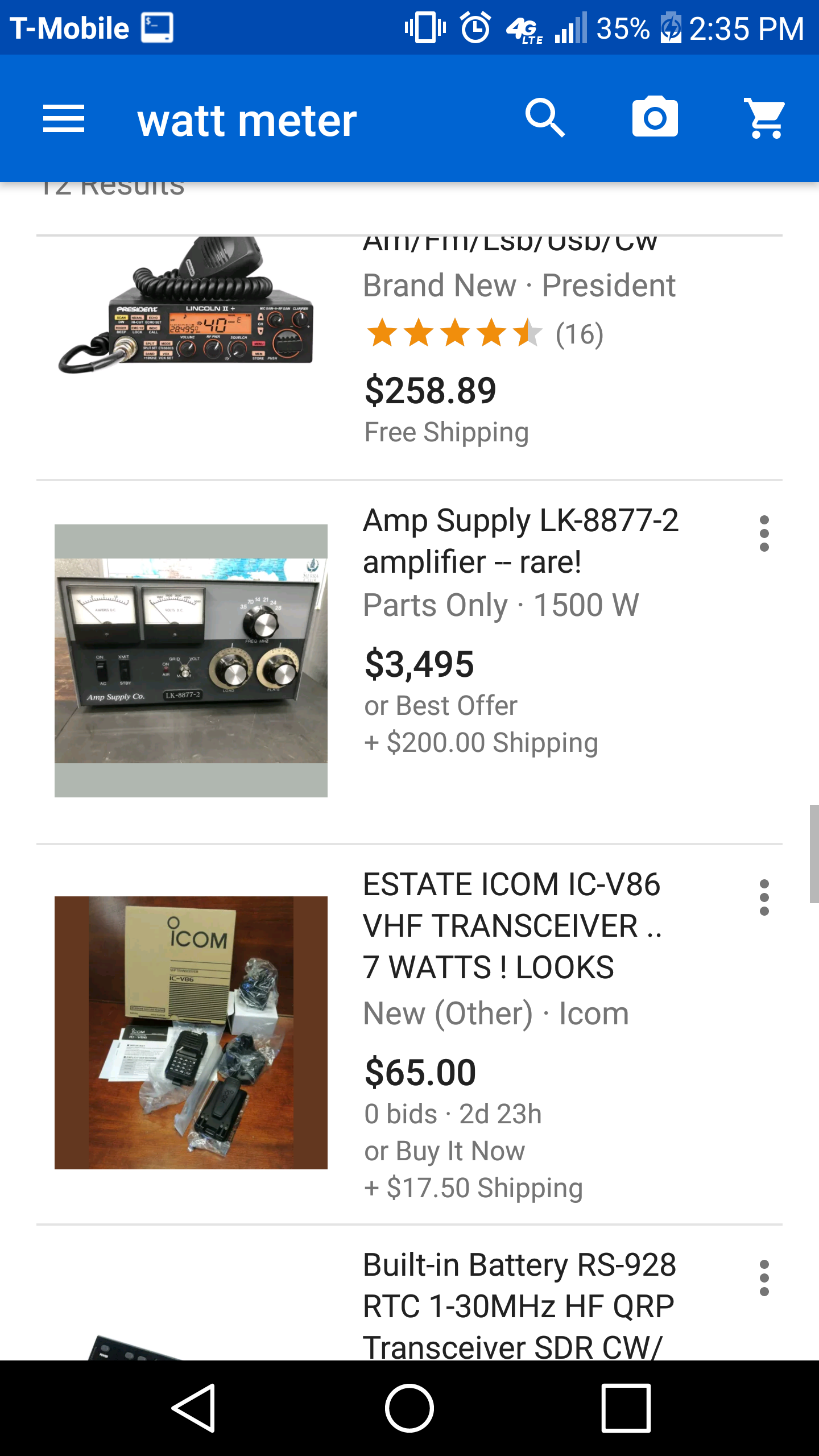

As im going thru a saved search that has nothing to do with amps...
