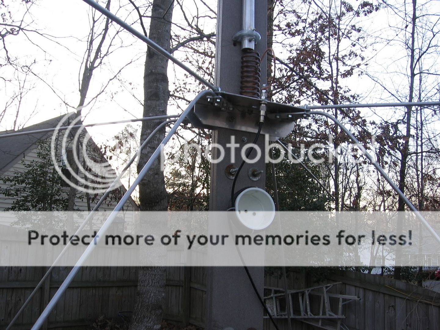

"1. what made you decide to do the coil thing instead of the tuning ring like the maco V5/8 has?
did you find the coil has less loss?"
A.
i don't have another antenna to compare or say that a ring or coil tuning system has more or less loss when compared to each other . from what i read it seems that the loss is detectable by instruments , but a human ear would be hard pressed to notice any difference . i originally went with the maco tuning ring because it looked simple and easy and i couldn't really think of a way to make a heavy duty coil like i wanted . i was in Home Depot or Lowes and noticed how stiff copper tubing is and thought it would work . my bro-in-law is in HVAC so i asked if he had 6 ft of leftover smaller diameter copper tubing and he gave me probally half of a new roll , LOL . i thought it would look pretty cool and would be very stiff . it also is a smaller looking tuning method . my landlord didnt like the four full 113 1/2 inch 1/4 wave ground elements spreading out across the house (thats why i cut/changed them into eight 1/8 wave ground elements) so i thought loosing the ring contributed to reducing its footprint in the sky . it also give me the chance to play with a different tuning method .
maybe next time i move i can change the eight 1/8ths to eight 1/4 wl ground elements both horz and sloped
"2. it looks as though this antenna will be insulated from its support structure due to the nature of the materials used.
is this true?"
A.
yes it will , but its simply a matter of letting the mast slide up to the bottom of the plate to have the mast become part of the antenna , or using earth ground . its two pieces of 5/4 (1 inch) solid plastic decking 4 ft long . its VERY strong , VERY stiff and WILL NOT ROTT . one piece would have been strong enough i think , but i like to over build stuff ...........
"3. will you be using a choke balun at the feedpoint?"
A.
yes i will be using a air core coax choke at the feedpoint .
