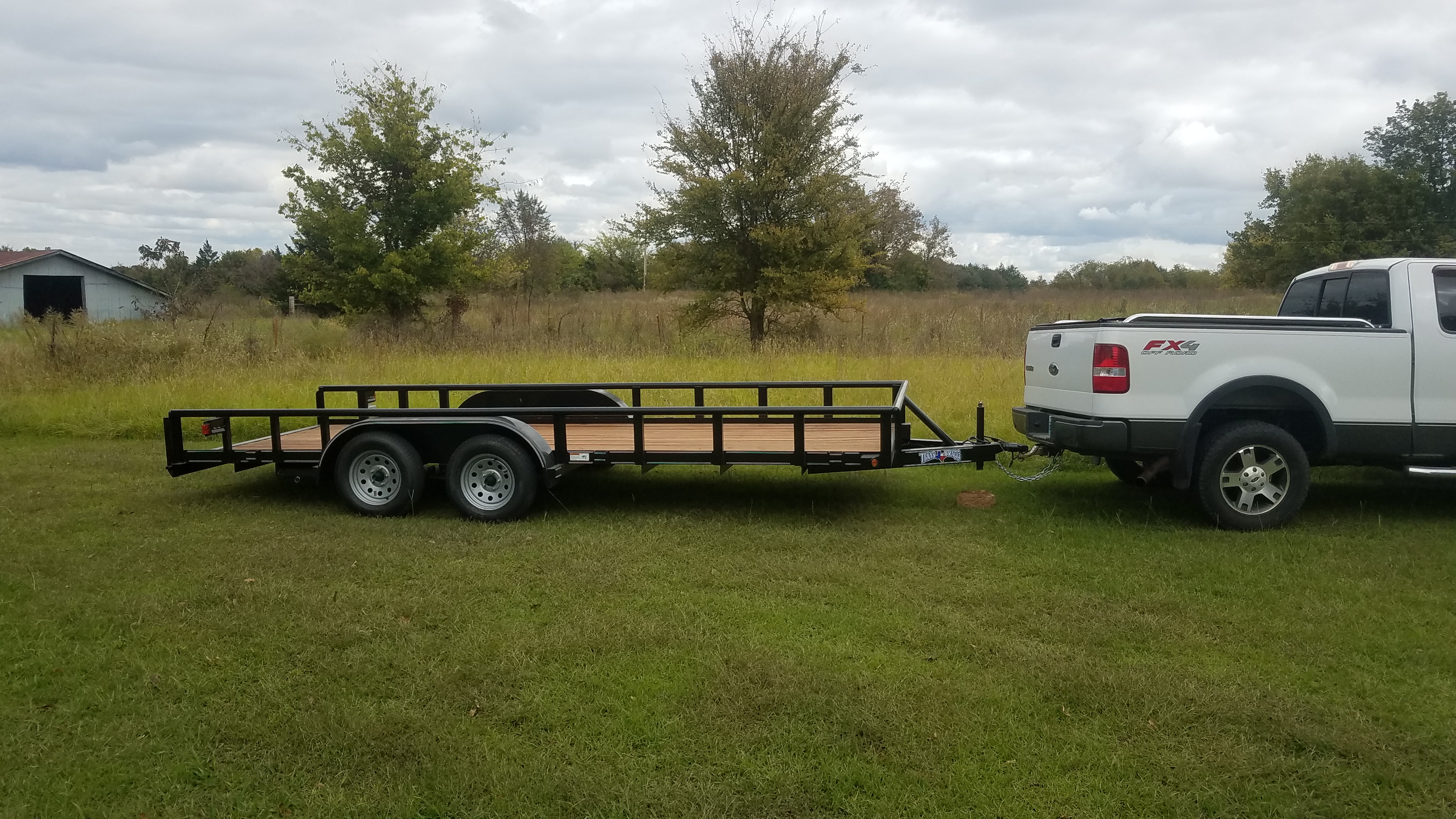

Ended up buying this Texas Bragg
trailer disc brakes, led lighting, 18 ft long, 83 inches wide, pipe top rails. Hopefully it's a good one, finding a trailer has been like finding a needle in a haystack. They had two the size I was looking for so I jumped on it. Apparently they have a high demand for trailers because most dealers have a 3 to 6 month backlog.

heavy are the axles rated?

Just to reiterate what @Slowmover - emphasizes - LEVEL your LOAD! <<<--- For anyone to read and understand.
Remember that the length of tongue to trailer axle - weighs heavily on the ability of the hitch to trailer axle and combined with rear tuck axle height - all of this shifts and changes as you drive. so the more balanced the load, the less likely for a failure with of load shift or bearing / axle fail occurring.
Balance your center of gravity on the trailer - for it affects how your truck will be able to distribute the load forces with all wheels on take-off and stopping - once momentum is gained, the inertia will rock that load on the bed with a force back and forth on those rear tires as it tries to keep up being towed. So the lower the load to the trailer bed, And balanced on those trailer axles the better. Too heavy on the tongue, your moments of inertia and momentum shifting up and down can ruin your day.
You might want to look into how you will be utilizing the loads. Dirt or Gravel is one thing, but a Tractor or vehicle is QUITE a bit different.
Referring to the Axle loading on that rear axle tandem, if you can make some adjustment to that center of gravity and the location of the axle from the tongue to rear - think 18-wheeler tandem slides - this may give your trailer a bit more versatility
Tongue weight is a number - not a best guess either - it's a rule.
