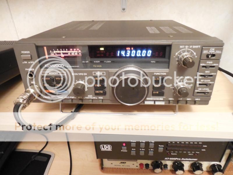

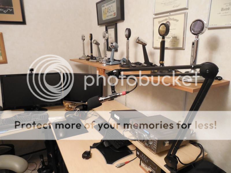

Hey ratsoW8, I see you are running ts140, or it looks like it. What mic are you running? Just curious. Any way you could post a couple photos? Thanks much and not trying to hijack the thread either. And hello there Hobie102!! Just curious. Again thanks much and God bless.
222...It is a TS-140S and I'm using my trusty Heil GM4 with it. I've used that GM4 on every HF radio I've owned since 2001. I'll add pics to this post when I get home tonight. I'm going to be buying the new Yaesu FT-991 but will keep the 140S. It has a great general coverage receiver.

The 140 is in great shape and I have it running into a 40-10meter OCFD at 30 feet and the LDG AT-600Pro tuner. I also have the Alinco DX-70TH I bought from Mudfoot right next to it on a separate dipole cut for 40 meters and using my 25 year old MFJ tuner on that antenna. I have some space to the left of the Alinco for a FT-991 when they hit the market. :)
How do you like the Heil mic boom? Is it the PL2T? I have been thinking of getting one for my Sennheiser MD-421.
I've had it and been using it for over 10 years and have had no problems with it. I'd buy another one. I think I bought it at the same time I got the GM4 for free from kenwood for buying a TS-2000.
