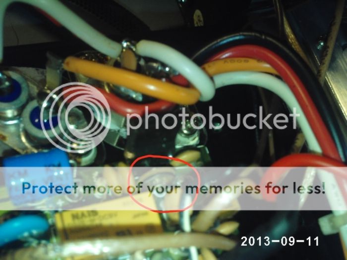

ok so some thing is not right with my RF Variable Power I can only get it to 60% and then it will jump to 200 watts!
here is a video that will help
RCI-2990 - YouTube
I think it may have some thing to do with the final amplifier what is the burnt out adjustment that some one maxed out for? it had 102 stamped on it and seems to be 1K ohm if I bypass the burnt spot

Now that I see your picture, that is the bias adjustment for the amplifier stage.

Did you change the bias settings? the last guy had it MAXED out! I set it back to 50~52ma
