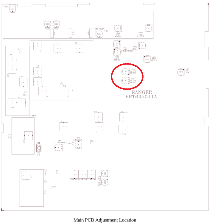

RCI 2995dx HP stingy signal meter
Assuming it is tuned as you say...
Just turn up VR1 (AM) and VR2 (SSB) until you like what the meter tells you. Wait for a station with a consistent signal level and match it to what your other radios say.
The alternative is to connect a 50uV (-73dBm into 50Ω) RF signal source to the antenna jack and then adjust those same pots until the needle reads S9. If you don't have the ability to accurately generate a -73dBm signal at 27MHz, you will be paying someone to do it for you.
But ask yourself this before you do. If the guy who so professionally aligned the radio cannot do something as simple as a meter alignment at the same time, how confident are you in the RF alignment?

I just received my radio and I noticed that the S-meter is very stingy. I was wondering if there is any adjustment for the meter
