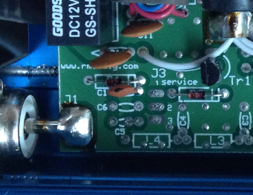

Just got mine today in a trade. Got to figure what service it's wired for.
If the short out plug is pushed down then its converted,,if not push it down and hammer the chicken band a little lol...they are a pretty clean throw away amp,,but heck you can fix it easy too if your handy!
Where might that be?
I'm not familiar with this amp.
There is no plug there

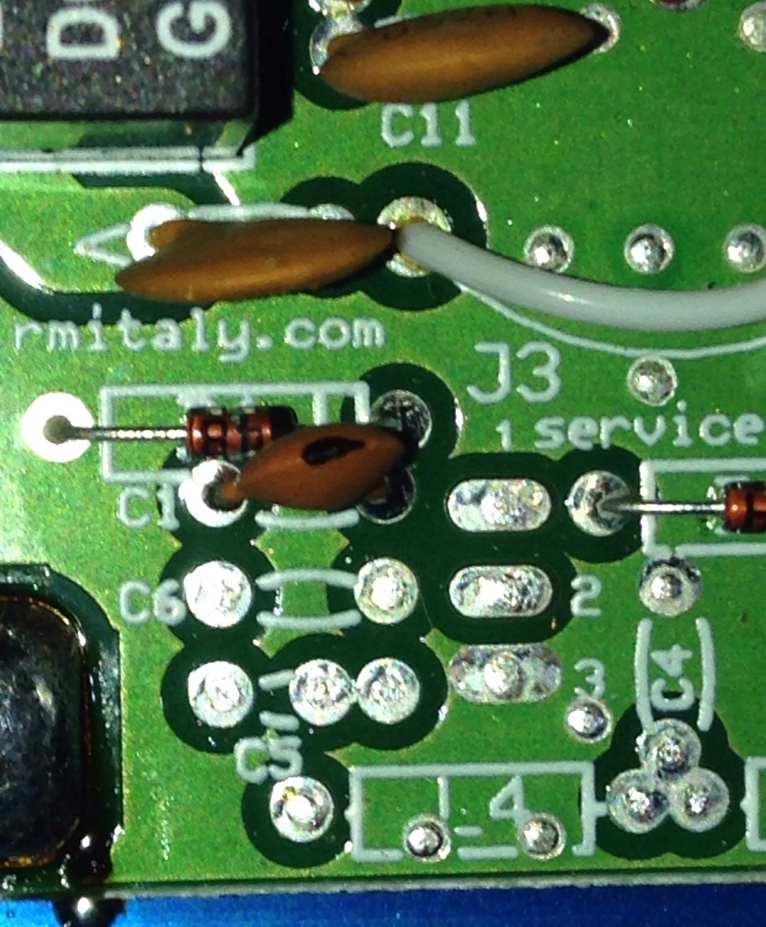

Apparently since low pass section is missing my guess is that this amp is configured for 26-28 MHz operation. C5 and c6 is missing. I think it came without a shorting plug.

Yes give it a try..my last one came ready to roll on 27MHz.got it from epay..also the new 200 p bipolar version did not need to be converted that I have sen.

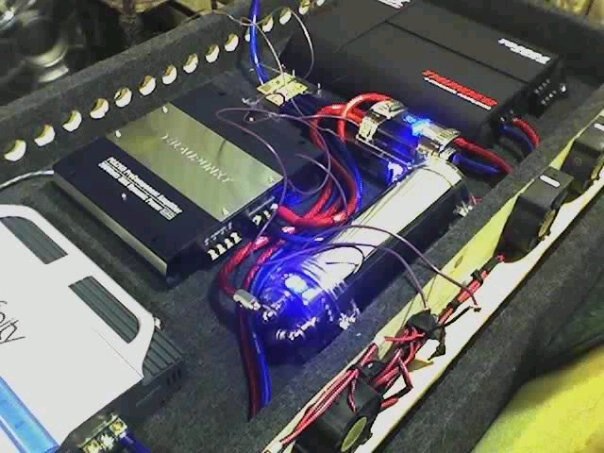

Notice the six blowers in the amp rack. They are controlled by a two speed temp computer I assembled with a dedicated amp thermostat in case that fails.
