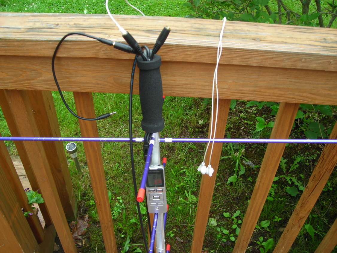

Ok I went to Radio Shack this morning and picked up a small voice recorder and a Y adapter for my ear buds. It works pretty well, I can capture my Satellite sessions then replay them to make sure I get the contacts correct.

Well what I did is used some sticky back velcro and mounted my recorder near the handle of the Arrow, ran the Y under the grip so I have to plug ins at the end of the handle, plug that into the recorder plug my ear buds into one and a double male cable from the other to my radio. Works out Great and I dont have a mess of wires to deal with. I dont use the hand mic as it is easier to changechannels for the doppler effect and see what I'm doing on the radio.

I'll try to take a couple of pictures of mt recorder set up, I just need a longer double male cable from the radio to the connector and I can tie it to the antenna cable. That will make the wires much easier to deal with.

My Recorder MOD for the Arrow Antenna. I actually have a 3 way splitter so someone else can plug in and listen as well.
