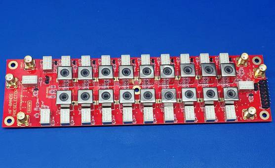

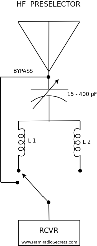

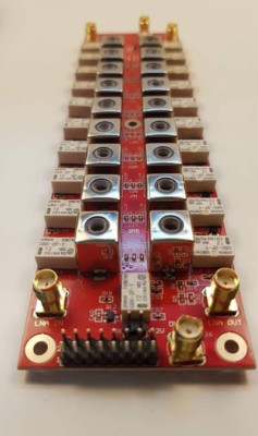

In any case your first line of defense is an antenna resonant at the desired frequency. The next step is impedance matching. Finally a band pass filter or switchable network (preselector.)
Analog HF preselector simple
Analog HF preselector not so simple
Analog HF preselector explained
Yet another
'bout covers it ;-)
