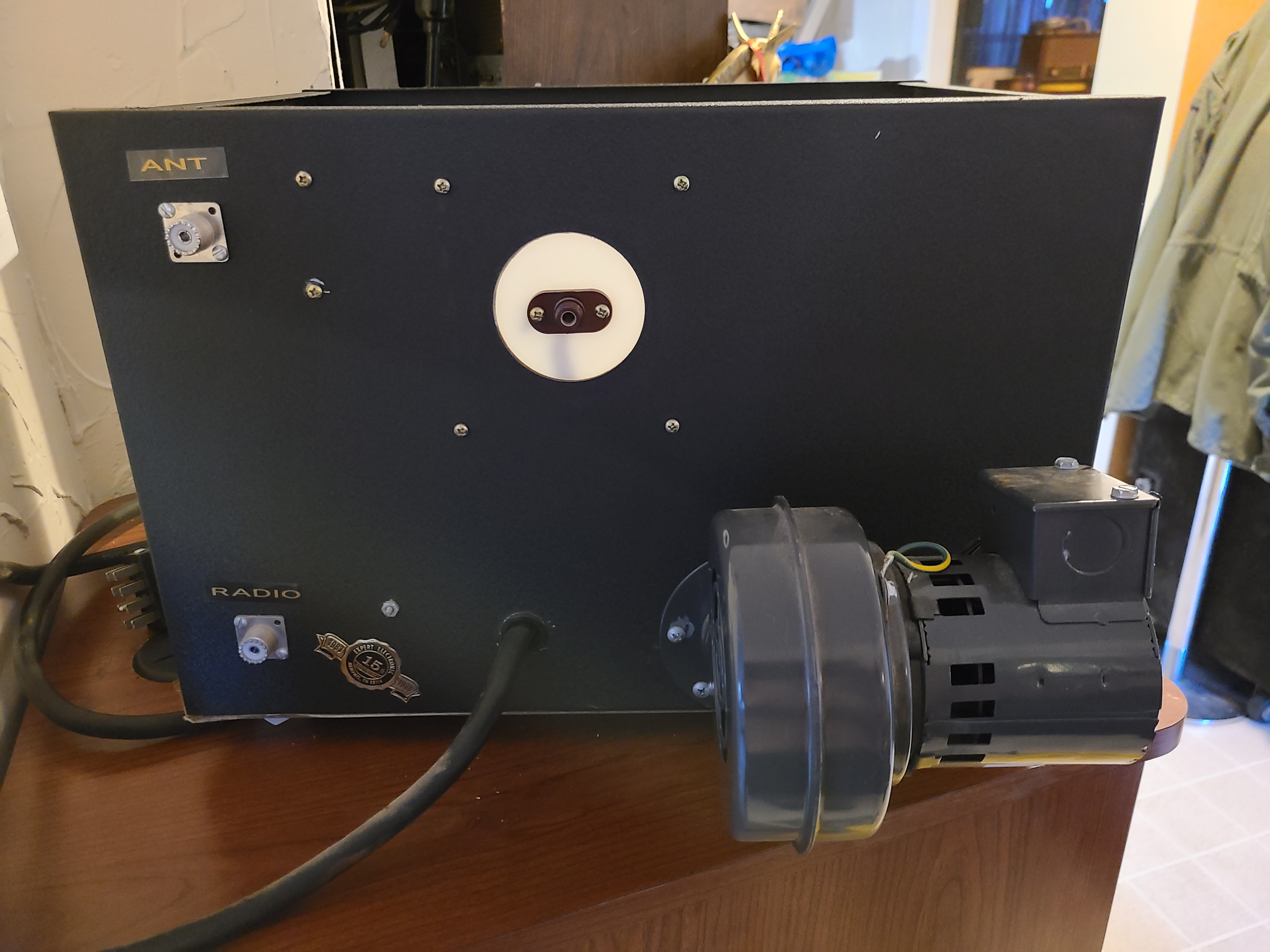

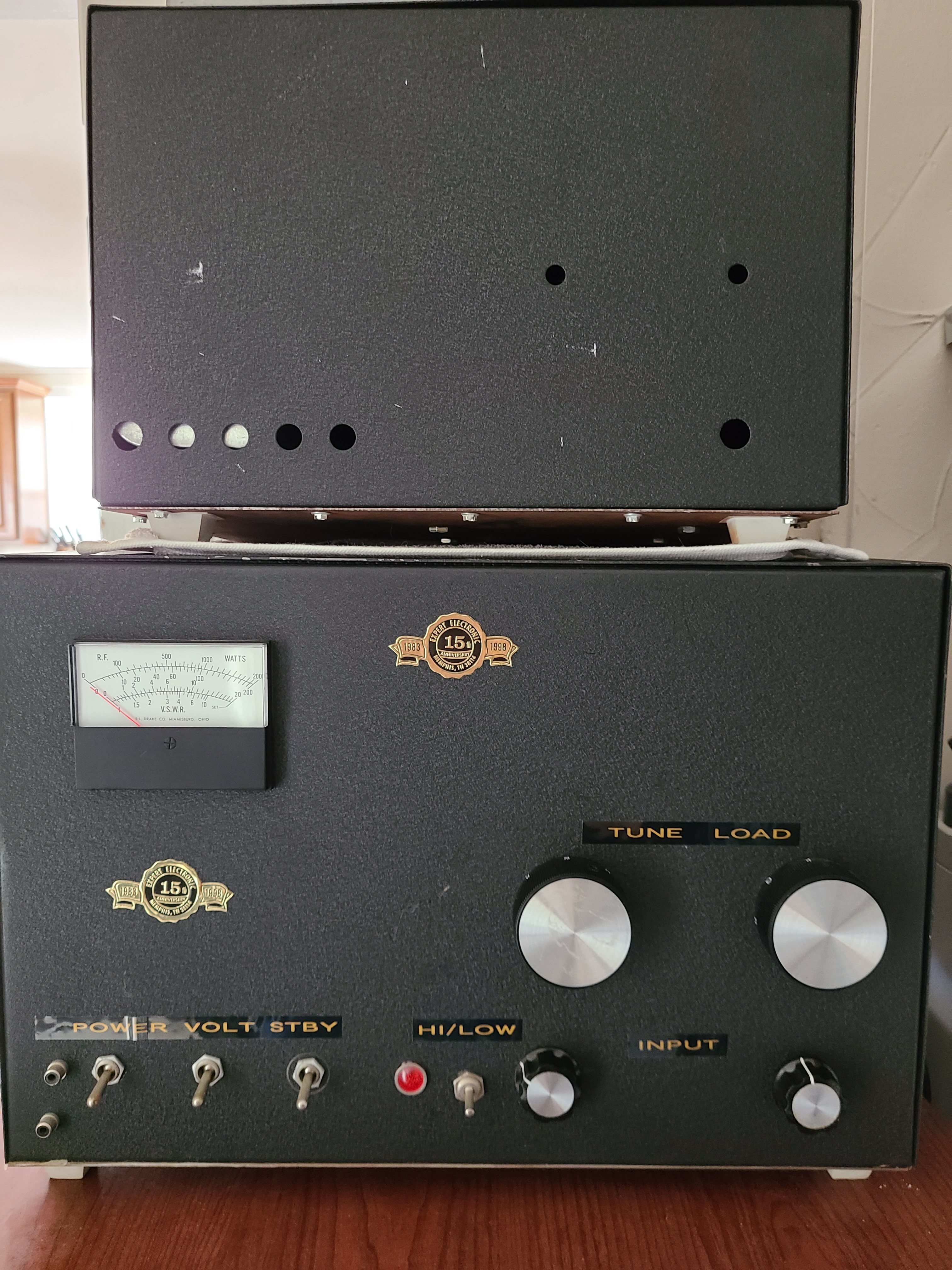

2x4CX1500B's
Reactions: Shadetree Mechanic
Yes thank you. I was going to say that the 4CX250B only needs 2 watts for full output when grid driven and the screen cannot handle ANY power. I have used them in FM broadcast driver stages and they blow easily with any screen dissipation. As you say even if cathode driven that power input is beyond ridiculous. At 1500 watts I am surprised he can keep a pair of them in the sockets.
11 meter physics again
