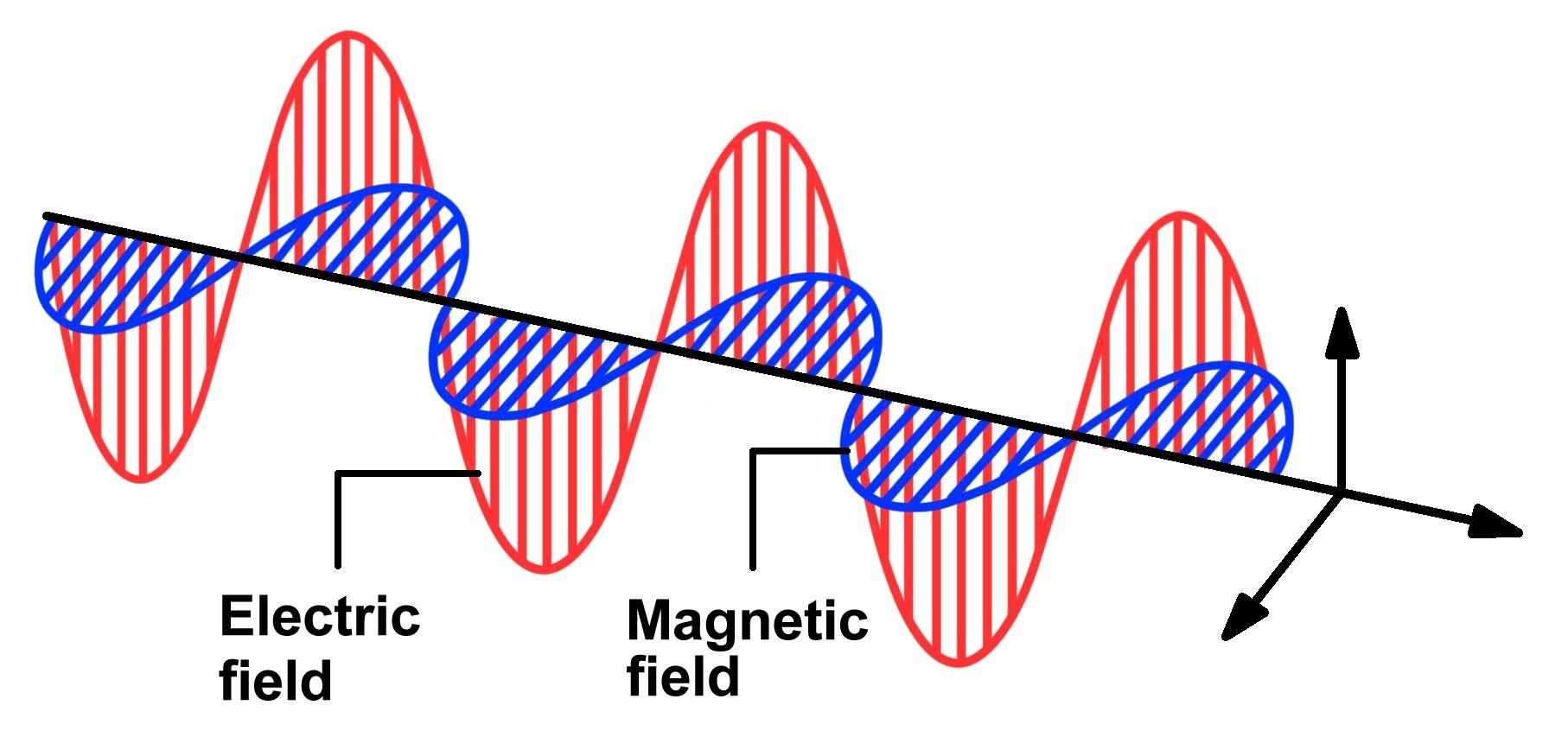

this is what is right. both voltage and current are equally responsible for the radiation of the TransverseElectroMagnetic field from any antenna.
transverse electromagnetic radiation
voltage is in red, current is in blue.:
