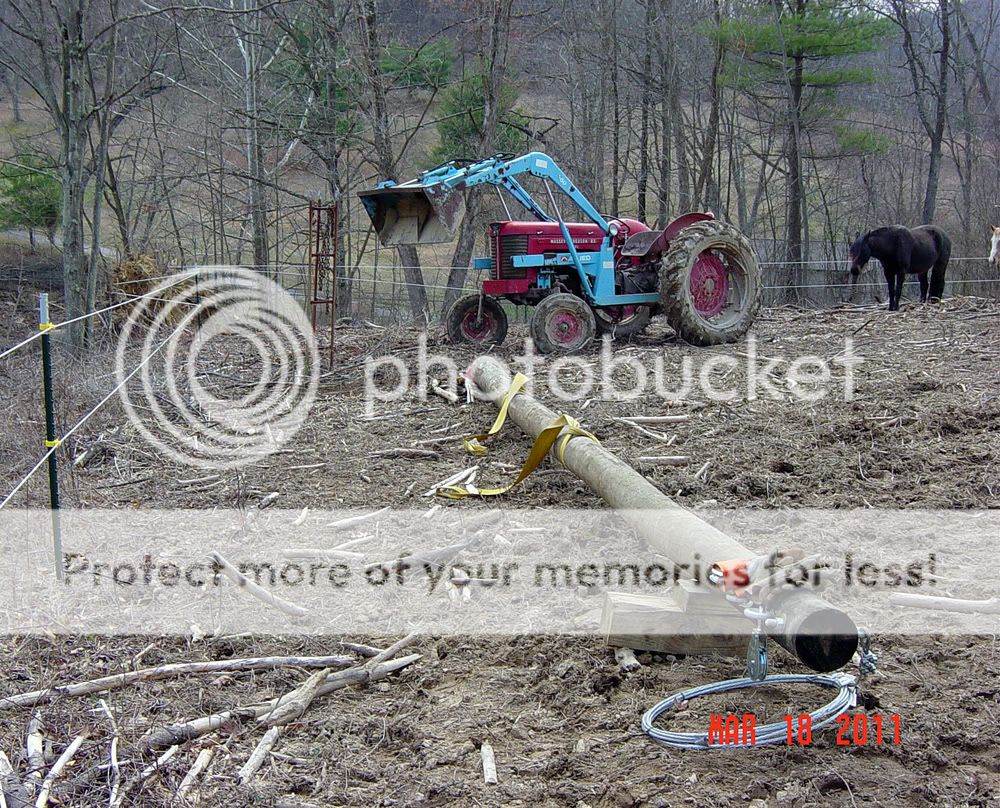

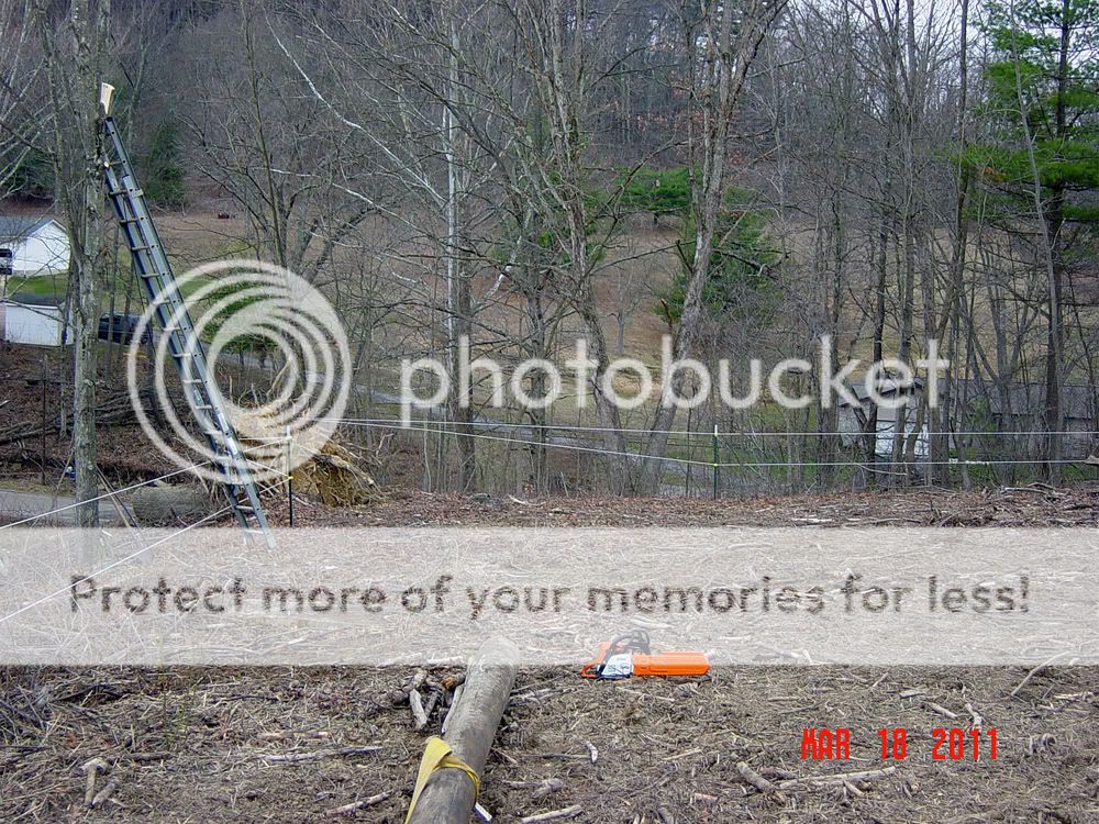

Anyway, I got the pole up the hill, removed the base of the old tower and trimmed some low hanging branches.
I'll drop the tower up the hill, so it'll never be at 90* on the initial pull. That'll help too.

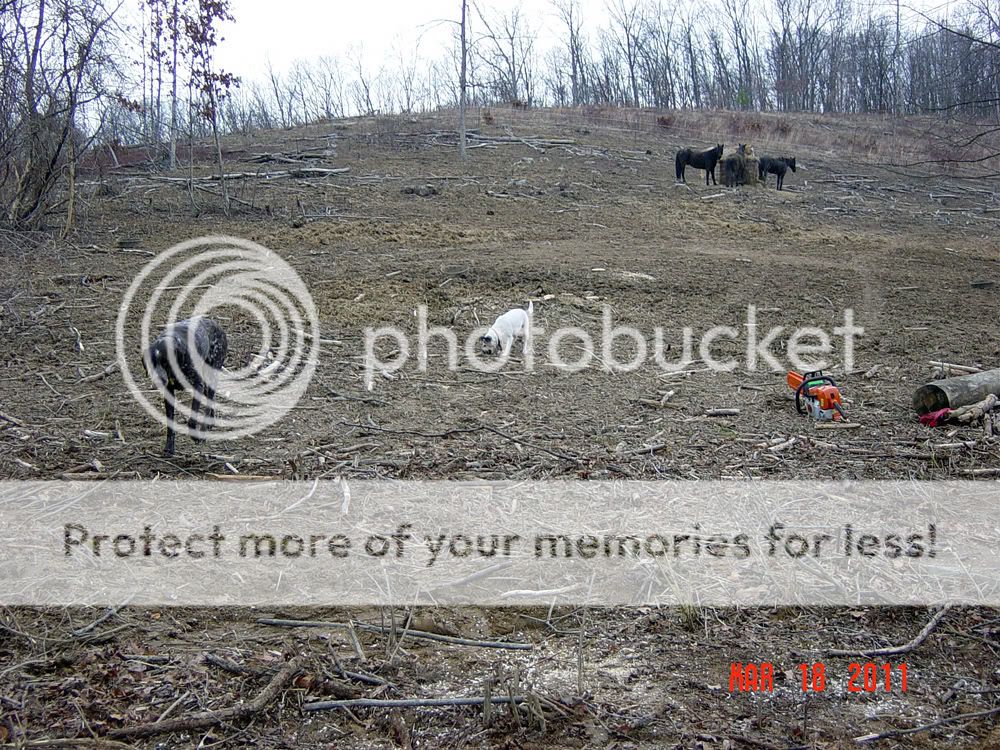

There is actually 2 additional projects in this pic, the shelter for the horses and all the clean up from having it logged out. Clearing 13 acres for pasture is work, no matter how you look at it, and sometimes it feels like it'll never be complete.

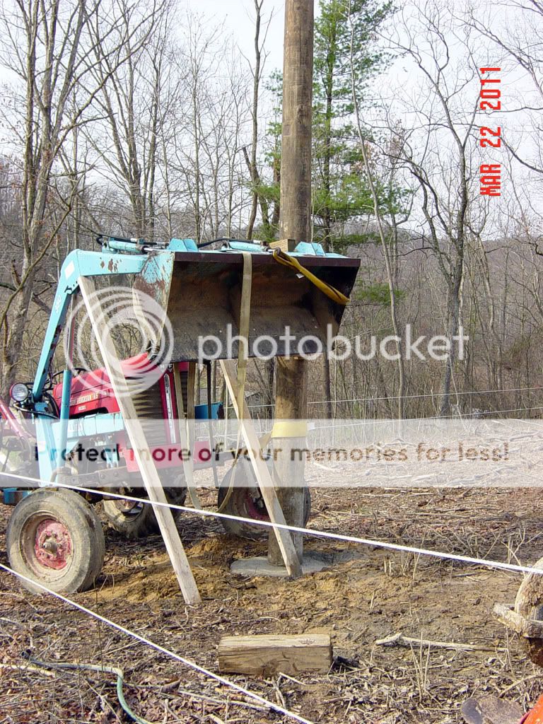

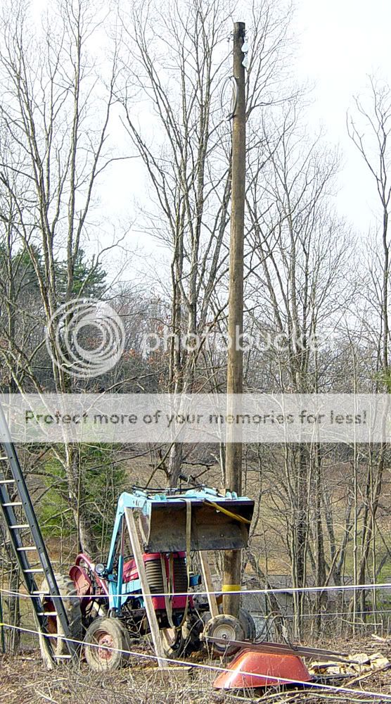

Well, what started out as a clear day with 25% chance of showers, turned into a muddy miserable mess. I should have waited on some help, but I got anxious and wrangled the 35' pole by myself. At one point I felt like I had a tiger by the tail, but I finally got it stood up.

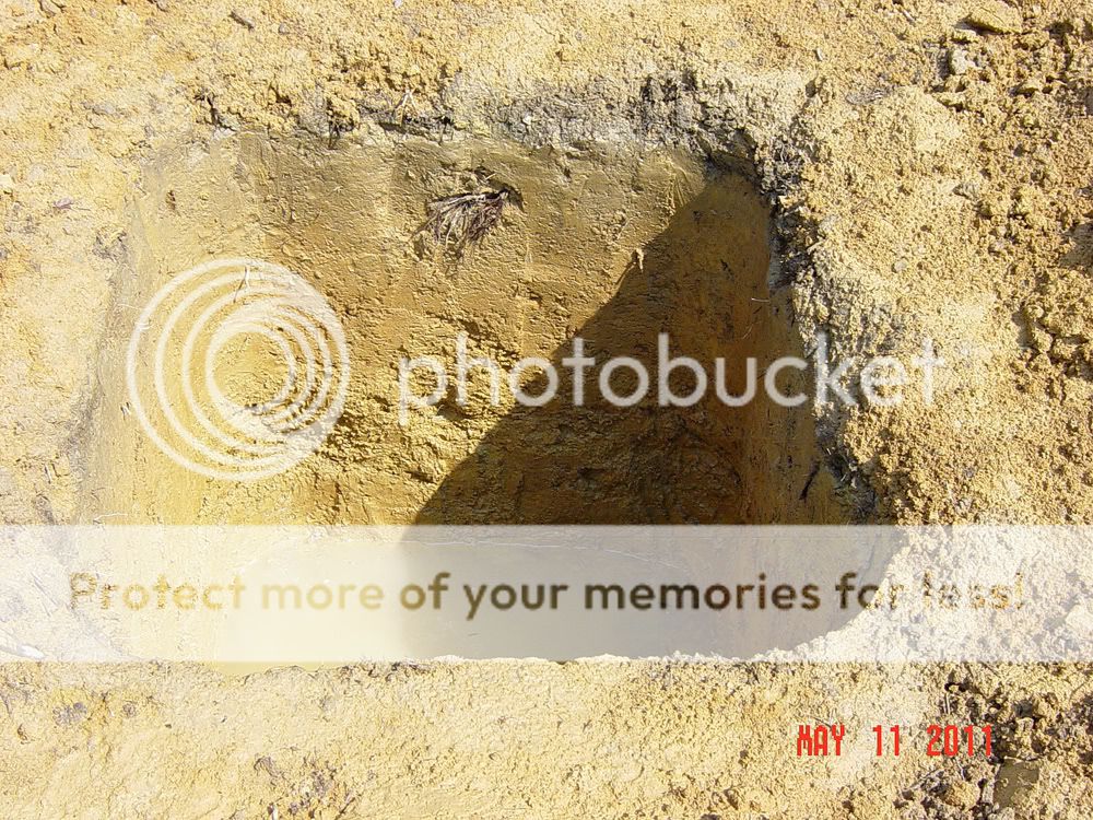

BTW, the hole ended up with almost 3' of water, 4 frogs and 2 dead moles in it :LOL:
I just ran a hose down the hill and siphoned it off, the hard pack clay didn't really get sloppy and I hit clay after about the first foot.
