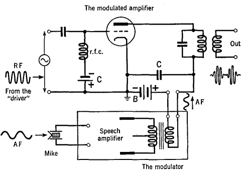

I'm not touching this one. I speak a different language when it comes to amplifier output levels and exactly what modulators really are.
People think "modulators" are "loud amps with lots of swing". Someone needs to educate the masses and you speak the CORRECT language!
A REAL modulator in it's simplest form. Note it has separate RF and audio inputs :wink:
Also a "high-level" modulator. Meaning it feeds the RF generator from the 'high-voltage' side, not the 'low-voltage' side. With solid state stuff, not all that difficult a thing to do since there isn't a lot of 'high' voltage present, sort of, easier parts compatibility. With 'hollow-state' stuff, there will be some pretty 'hefty' voltages present and applying that AF can get tricky, not to mention dangerous, sort of (that 'golden screwdriver' better be insulated! :)).
Been a while since I've seen a schematic like that...long enough that I can't remember if it's a 'Colpits' or what. Oh well, who cares...
- 'Doc
