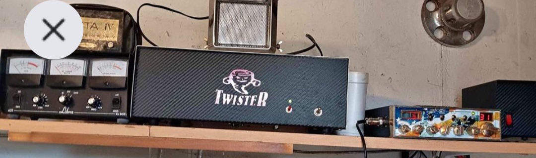

Twister Amps (buyer beware)
This guy thinks he knows how to build amplifiers...
Seems ok so far? It gets better..
Clean signal into amp...
Nasty carrier? WTF!!!!
Nasty splatter..
This has been a public service announcement...
Lol, it's going to take a lot of work to get it where it needs to be.
I would love to buy that amp case you can keep all that other junk i been trying to find someone to build me a case like that
Resurrecting old thread - I wonder if this is same builder?
*update decided not to pursue it lady said when asked the wattage and how many pills - it has one big pill and does 65 watts. Ermmmm firstly I've not heard of a "big" pill and 65 watts isn't really that large. I must be missing something. There was a Texas ranger 10m radio similar to a connex 3300 from bout 10 years ago w ssb, a decent triple meter and small power supply but I only wanted the package to flip the amp and radio and power supply keep the meter. But no ones gonna want a 65 watt 1 pill base amp almost the size of my 4 pill base box in the day and age of cheap kl203s. Plus I still have no idea what a "big" single pill is.
